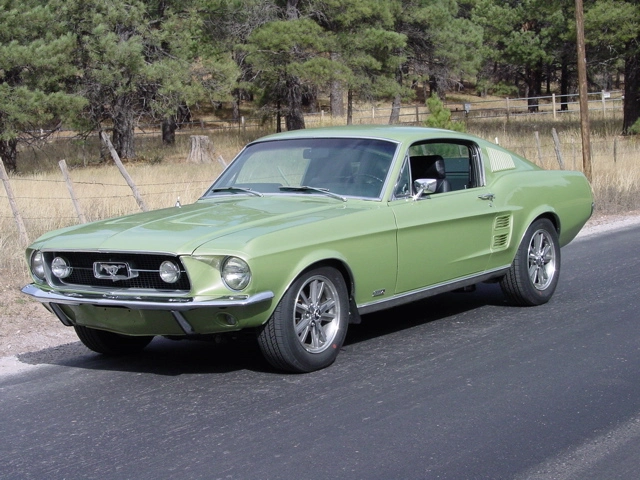

I have them on mine and I bought 1.25" spacers and they fit/look great. I have not driven on them yet as the car is in the building stages, but I have fitted them and move it around on them. Reenmachine has 1" on his test mule car and there is another guy with a blue 67 that has them with 1", and both suggested the 1.25" for me.
Thanks for the pics. If the wheels/tires are still available I'll get them Saturday.
I really wanted a set of Cragars but these were takeoffs for $350.
