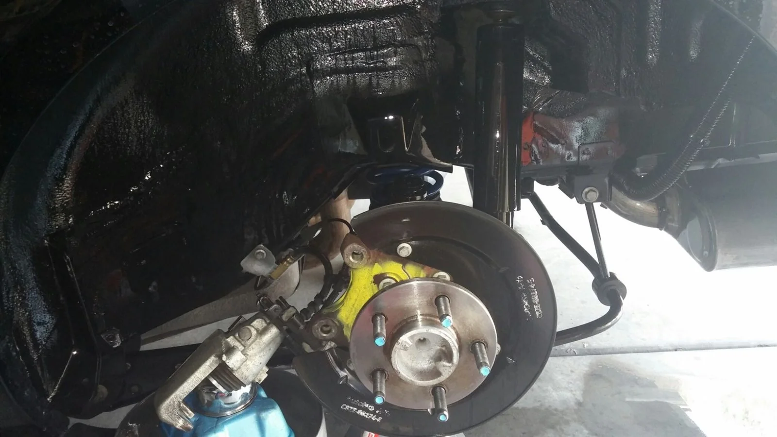

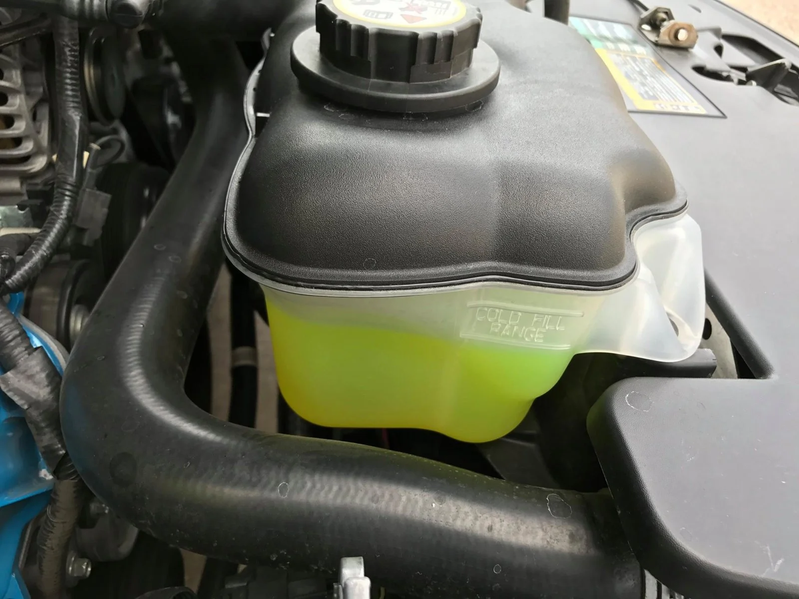

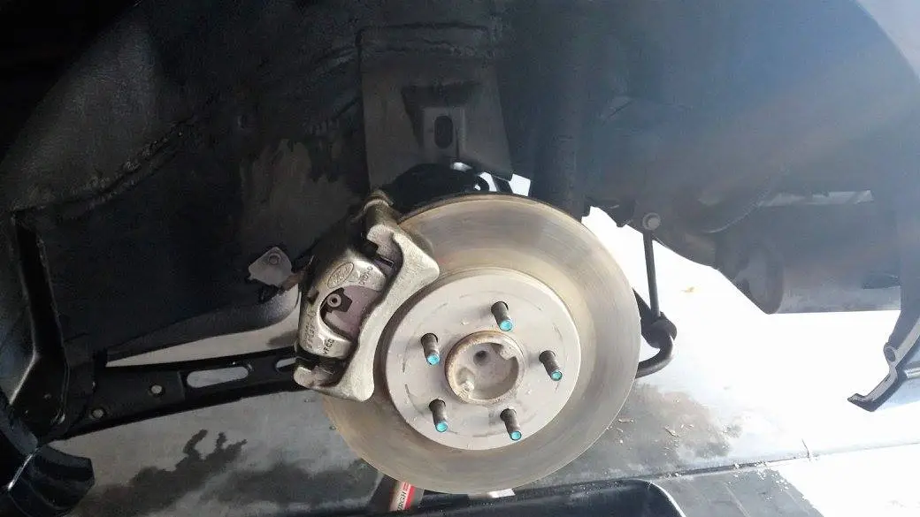

I mostly agree with raceraj .....my opinion is like with any machine .....it just runs better if its clean and well lubricated.....and fresh fluids are frequently used .... I bought my 07 gt mustang new ....and it only has 27k on the clock .....but I've flushed the radiator like maybe six (6) times (if the fluid even gets a hint of discoloration it gets flushed) ....I change the oil (mostly based on seasons) but that's still like (4) times a year and I only put 2,000 miles a year on it (if that) ....I've changed the rear end gear oil ....and I'm getting set to flush the trans pretty soon.....but then I take the rear brakes apart to clean and detail the undercarriage.....I have a slight case of OCD when it comes to my cars ......the point is ....if you like your car ...and you plan on keeping it ...you can never do too much
