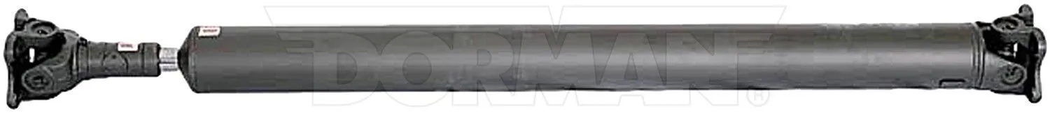

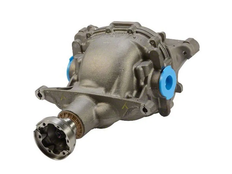

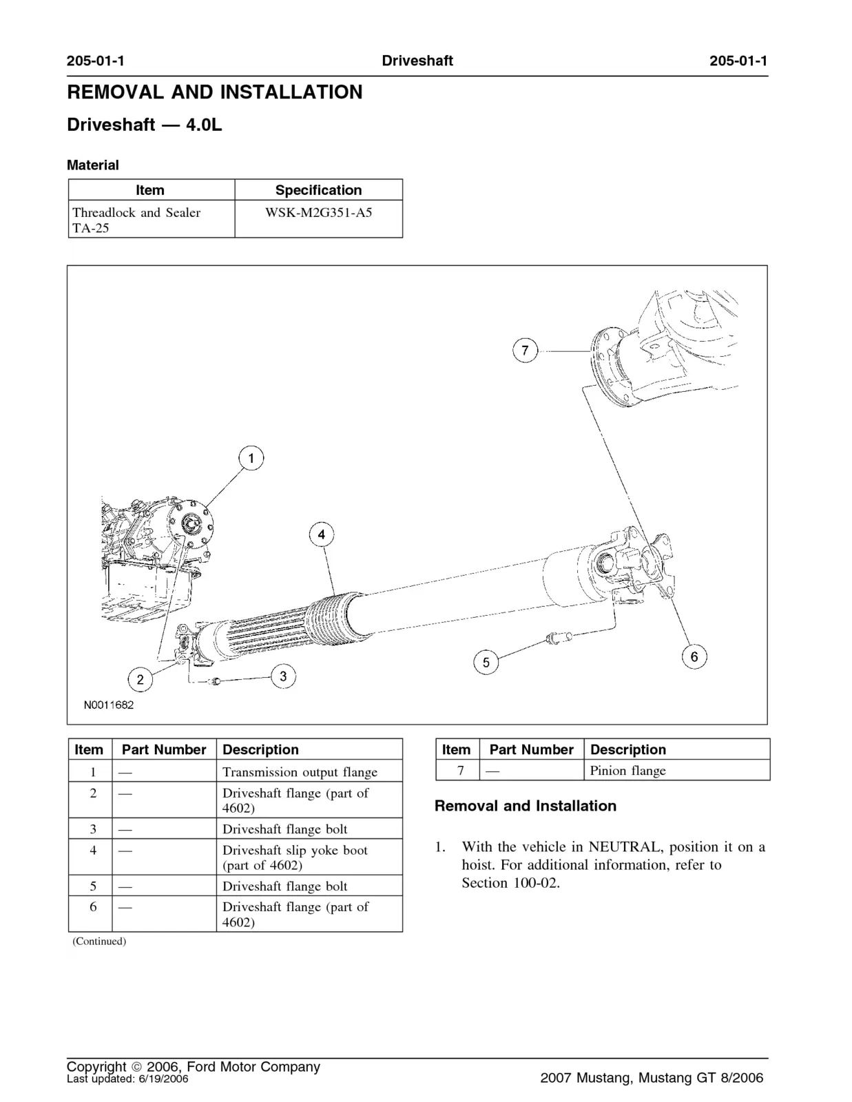

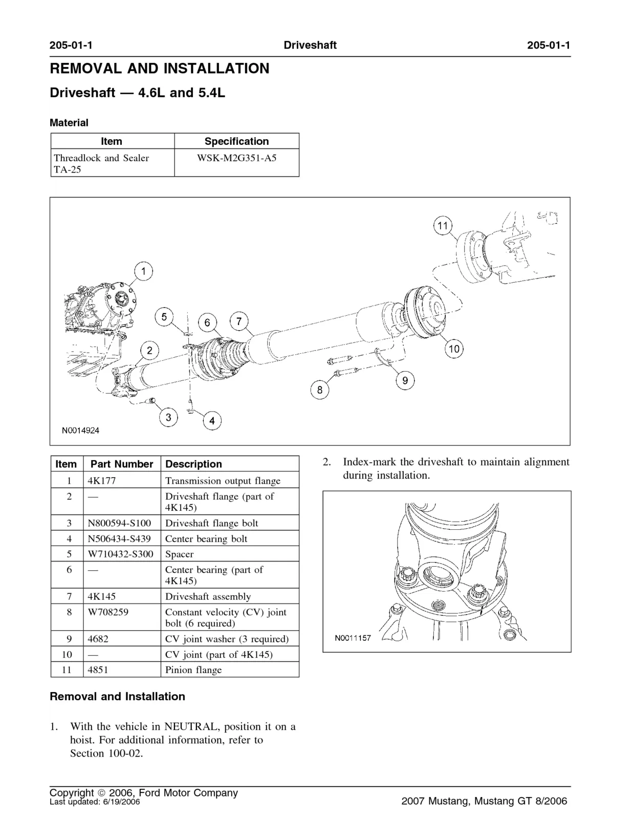

i find it hard to believe that a dorman driveshaft(which is square at both ends) will bolt onto the oem differential(which is a circle).
can anyone here verify this is the way it installs? i attached pics of 4.0 and 4.6, and of the dorman 4.6 stock photo.
if this will bolt onto the differential, wouldn't this cause a dirty opening to the differential?
i have searched hours for pics or facts on the web, nothing!

A stock photo is just that- a stock photo, so you can't go by that at all. Regardless...many driveshafts are like that at the rear axle. The diff has a round flange with threaded holes in it, the driveshaft has a square cast end that bolts to the flange. There is no opening into the diff. Most likely if you buy the dorman driveshaft it would have the round flange as shown.

thanks, i skimmed through them too quick....i have tracking on my dorman and will get it friday night. i will post my shop work on this and afterthoughts. if my dorman ends up being round flange at rear, then i should ask finders fees for the next ones sold. i assume why i cant find much on them besides stock photos is bc it shows square and we all know our v8 stangs are round at differential.... they will sell tons more if they correct the pictures if i am correct. from what i can tell dorman driveshafts show pictures of same item. pics for all 3 avail driveshafts from dorman appear to be for the v6 in the pics. 1 for v6 auto, 1 for v6 man, one for v8. the v6 should be the square one on both ends, not for v8
should have trusted my 1st instict instead of trying to get dorman to understand they could totally sell much more of these if they changed their photo of this item 946-807. you can find this item being sold at many places and they ALL use wrong picture. i want my finders fee dorman! lol

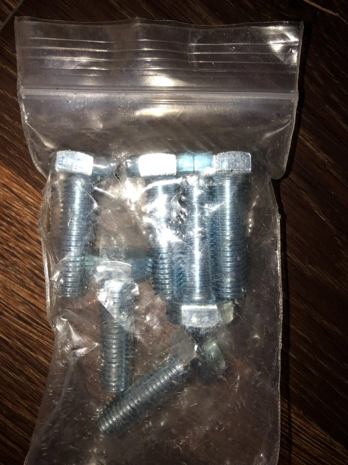

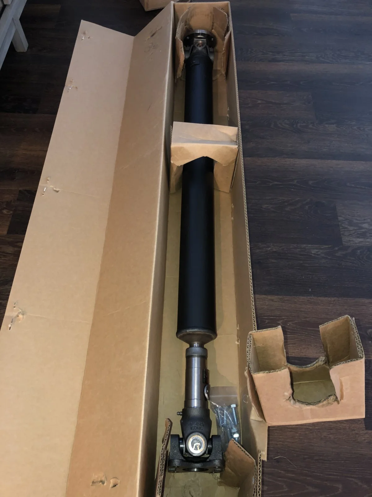

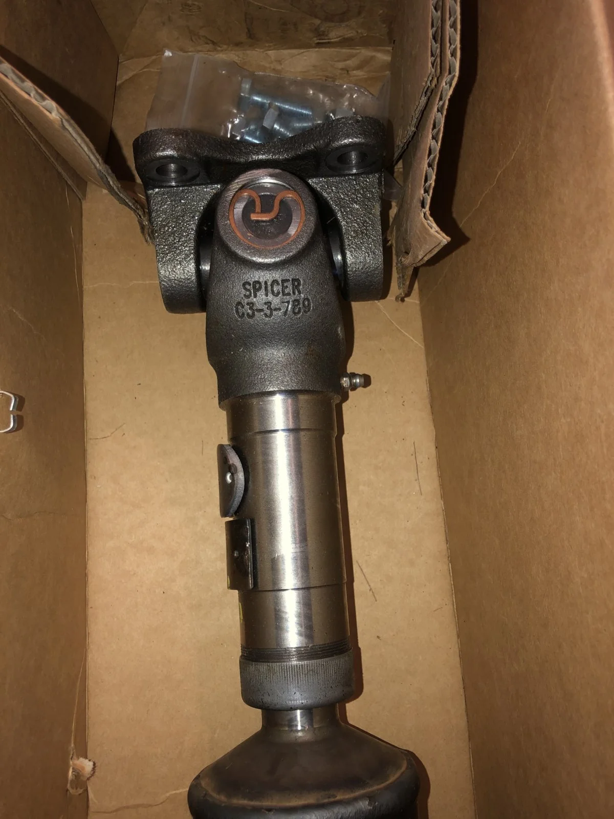

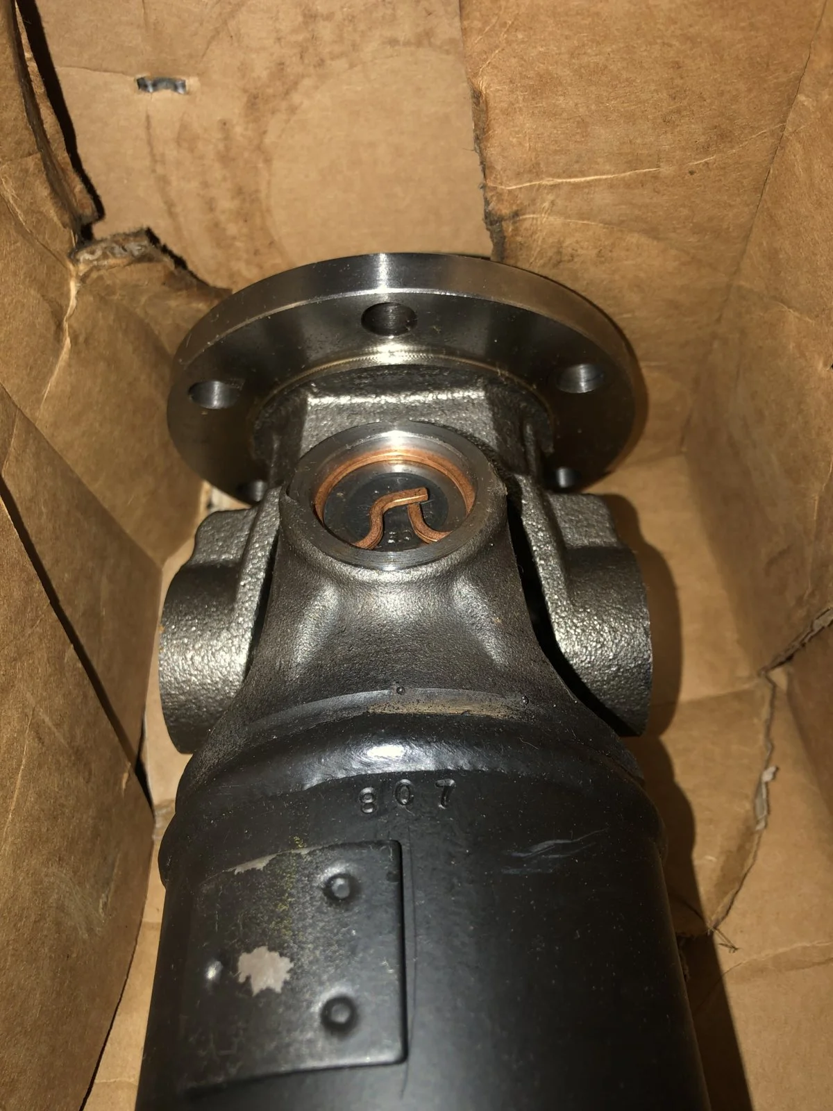

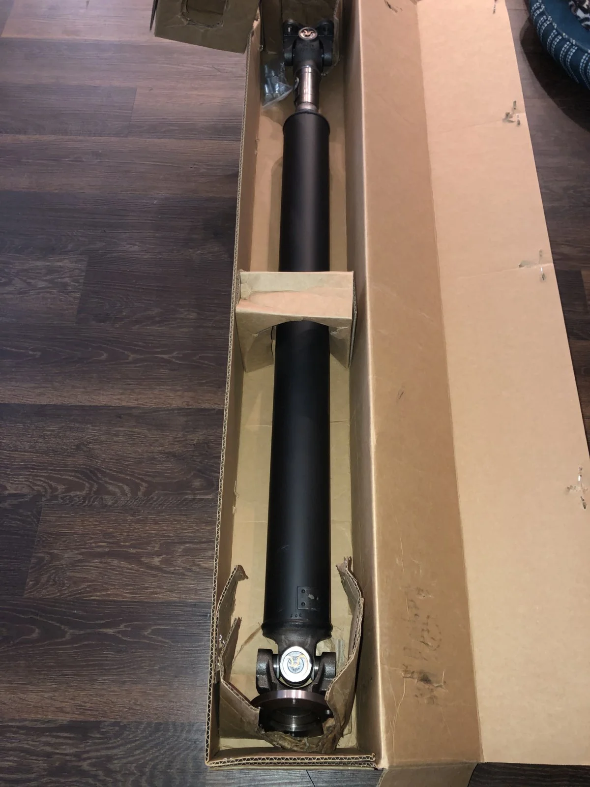

it did come with round flange and if they advertised using spicer flanges and ujoints would sell more! here is the only known true pictures of item 946-807 in the world!
