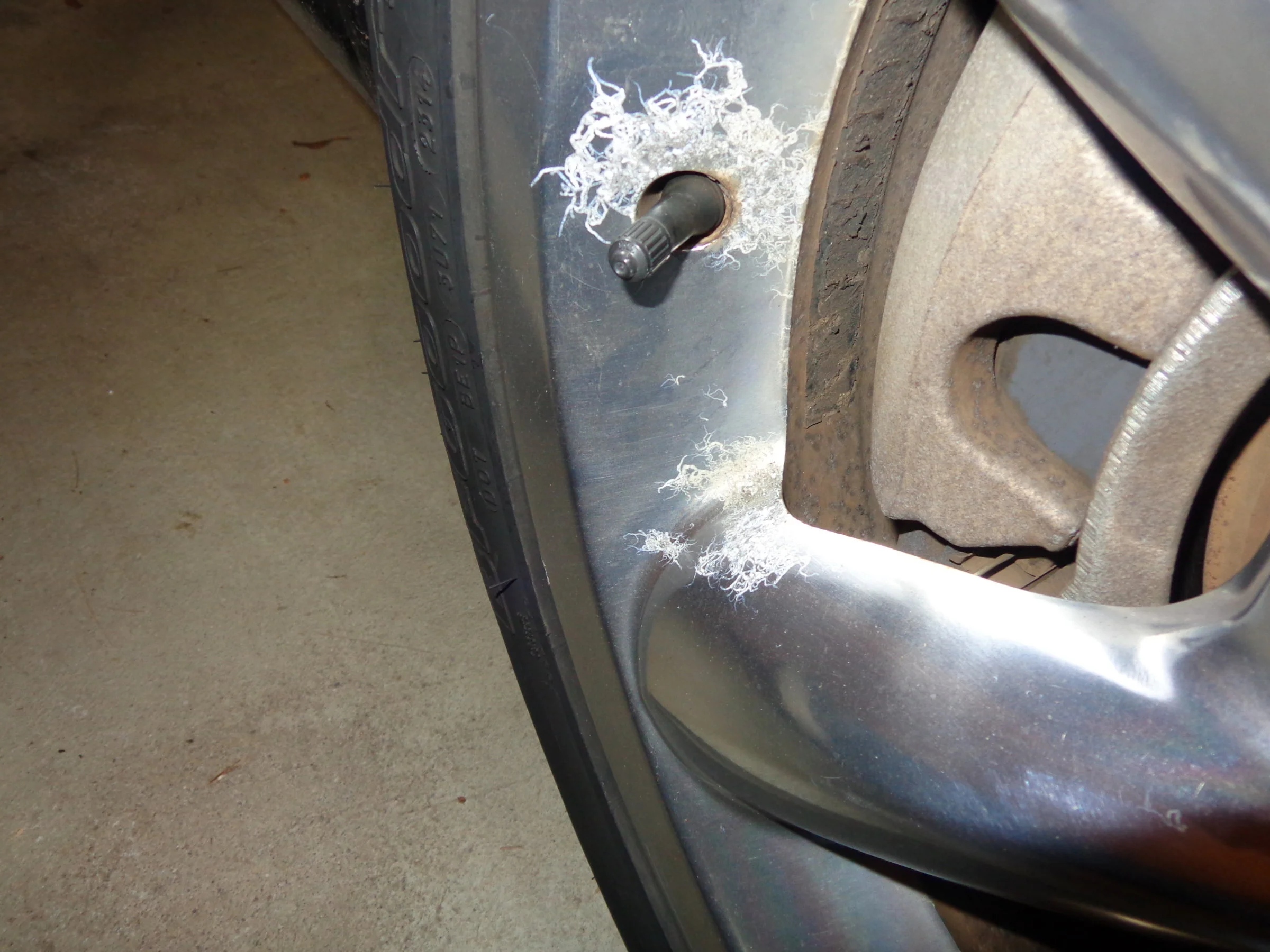

here is the pictures of the corrosion on the rims of my 08 GT/CS.New to mustangs, Any help would be great. Thanks DANO51

It looks like either acid or chemical contamination led to that.
First step is going to be using a wheel cleaner that's safe for all wheels with a nylon-bristled wheel brush. Meguiar's is your best bet on the cleaner, you can get the brush at any parts store (or a nylon dish brush from Dollar General if on a budget).
Make sure the wheels are cool and follow the instructions on your cleaner to the letter.
After you're done doing that, dry the wheels and evaevaluate. If the problem is gone, you're good. If it's not gone, but there's no pitting, and those areas still lack luster, you'll need a polishing compound and a buffer (there are videos on youtube on how to use one). If there is pitting, you'll need to get a professional involved either in the form of a powdercoater or a wheel repair specialist to get them perfect, but you may be able to get them to a presentable state by polishing.
I've seen that type of corrosion before, it's from road salt and or a brine solution that has gotten under the clearcoat and corroded the aluminum. The only fix is to have the wheel refinished. I live in the rustbelt so I see that all the time. Where did that car come from? Take a good look under the car, if the wheel looks like that, who knows what lies hidden underneath.
Thanks for the replies. Underneath the car is excellent. It might be worth in time getting new wheels.To have them done over is more than new ones would cost. I can live with it for now. The car only has 35000 on it. Thanks again for the replies
