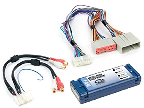

Hey guys, I have a 2012 Mustang v6 with the factory stereo system. I have two 10" subs with an amp. What items do I need to be able to connect my amp to the factory stereo? Or would it be simpler to buy a new stereo system that connects easier to my amp?
I used the PAC AOEM-FRD24 which just plugs in-line with the radio harness. Easy as cake! Two sets of RCA outputs and a 12V remote turn-on for your amps.
Amazon product ASIN B001709QFWView: http://www.amazon.com/gp/product/B001709QFW/ref=oh_aui_detailpage_o05_s00?ie=UTF8&psc=1
