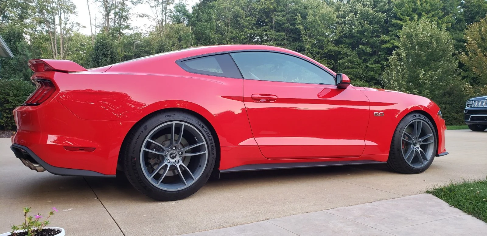

Thank you I ended up ordering the gt350r brakes. Anyone want to buy a track pack set up? And i have aftermarket rims with the same offset and spec as the R
I want those same wheels, but in the 20" version. You don't need the same offset as the gt 350, they are for the flared out fenders and quarters on the GT 350.
