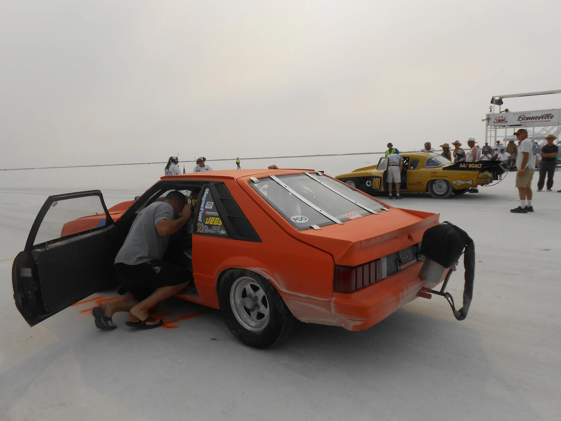

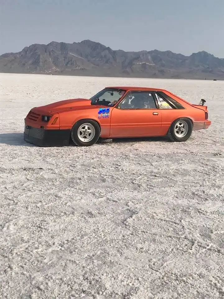

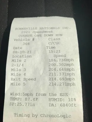

I have a 79 Hatch that is a slightly different animal. 4400 lbs, 351Cleveland. 700 HP single 950 holley, no power adders. 4 speed toploader, Gear Vendors O/D and 3.73 8.8 with a spool. I run a production body class in the SCTA. Car still has the horn, wiper motor, dash. lights, etc. I am allowed an air dam in the front and nearly any hood scoop within reason. In August 2021, I ran 214 mph at Bonneville. Car went 204 at Arkansas mile. 174 at 1/2 mile (@3600 #). I will be going back to the Salt (Bonneville Utah) in 2023 attempting to set a class record . Current record is 228, held by a Chevy Monza. I may be able to tweak another 20 or 30 HP from my engine but I need to work on the Aero. I cant change the body panels, tape the gaps. block headlights or grill. I cant alter the body, cover holes or smooth any gaps. They will put you in the altered class (246 record) if you have flattened radiator fins! I know there haven't been a lot of foxes with no wings running above 200 but I will be looking here and elsewhere for hints or tips and possibly a steel hood that I can customize a bit.

Running 4" tires on rear is typical. Less drag. The tires in pic ere 27" Goodyear Eagle front runners. We put my 26.2" x 10 Kuhmo tires on and the car went from 208 to 214. Tire spin above 200 was greatly reduced, and the gearing change seemed to help a bit too. We are going to try a 28" tire next year with a rear gear change. Aero improvements are the key. Just have to figure out how to do that within the rules!
If I were chasing this, I'd run an '87-93 GT nose, or build an '87-93 car if such a swap was a rule-breaker. Ford lowered the drag coefficient dramatically when they put the composite headlights in and eliminated the grille. The smooth LX tail lamps probably wouldn't hurt either.

Can't change the nose, Has to be an 81 or older 4 seat passenger car! Also they do check under the car. No mods there either.
So you have to have all those Left rear stickers that say Tom's, Magna fuel, and Poo on the back window?
And for sure the snow plow is beneficial?
The snow plow is beneficial. Car ran 175 in the mile without it and was spooky loose. I put it on and went 186. (C4 auto). Put in 4 speed and lowered rear then went 204. Keeping air out from under the car prevents lift. The air pressure across the back window is so low it pulled the window from the seal so my Points of Otter (POO) sticker is not causing significant drag. The stickers on the side covering the screwed up lexan are staying. If I get to 229.99 I'll pull them off and see if it makes a difference.
