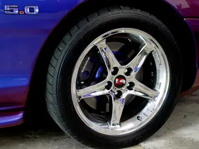

Here is what they look like on 17's (275/40's) and Eibach Pro kit.
