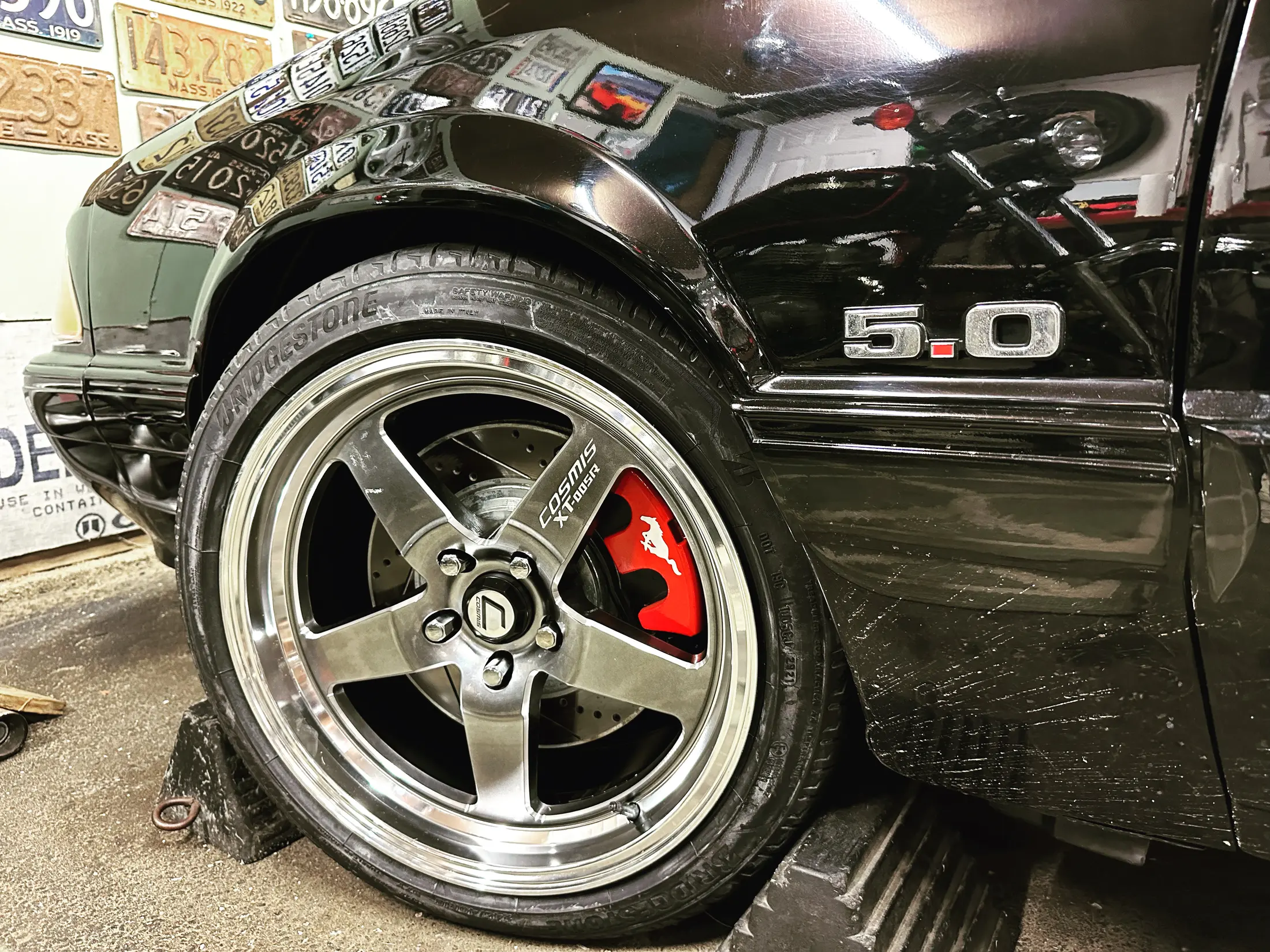

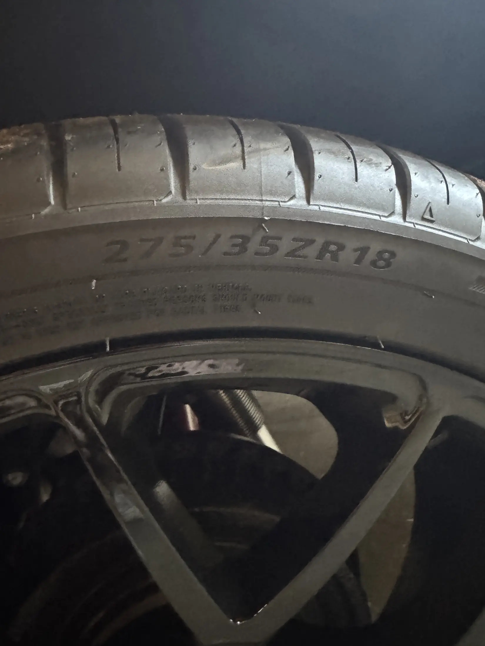

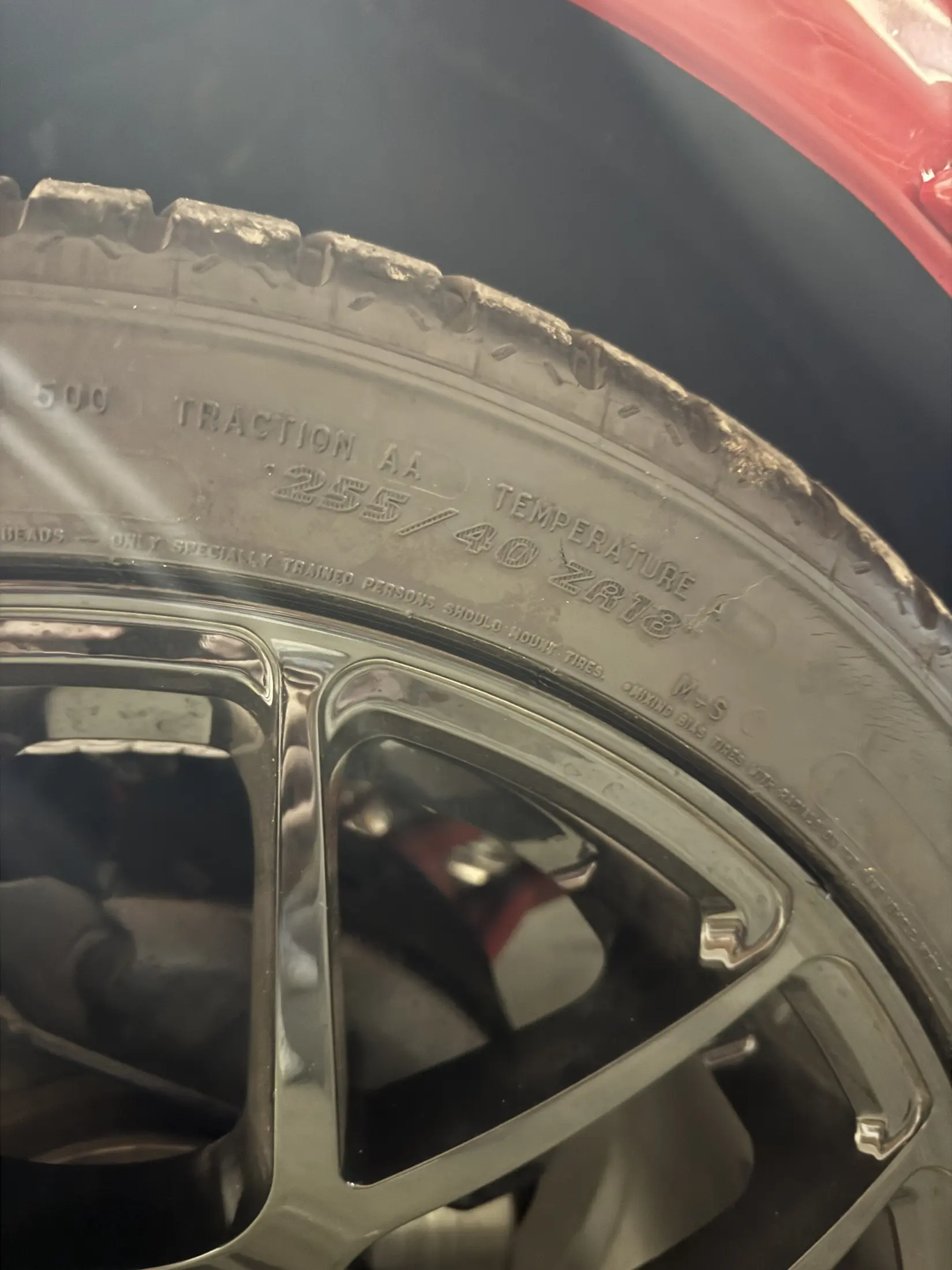

Need new tires on my car. Pretty sure the wheels are 18x9 all around. I thought the back were 18x10 but measurements all look the same.
Currently on the front are: 255/40/18 , yes they rub
at full steer
Rear size: 275/35/18
I’ve read that 265/35/18 on all 4 wheels is a good size. Any opinions on this?

In general, a 255 is a good size for a 9” wheel. But it is popular to run 275s on a 9" wheel. Keep in mind that, despite being listed as the same size, different brands of tires can vary in size. Look at the specs for the tires you’re considering on Tire Rack. Find the Rim Width Range & the Measuring Rim Width. The MRW will let you know if the tire you want will be pinched or stretched on your wheels. There are advantages and disadvantages to pinching or stretching. You should also compare the Overall Tire Diameter to the tires you have now.
I run 245/40/18 tires on 18x9" wheels on my 1992 GT autocross car. There are some 255s that would fit up front, but I felt the 245 was the best option for my car/purpose.

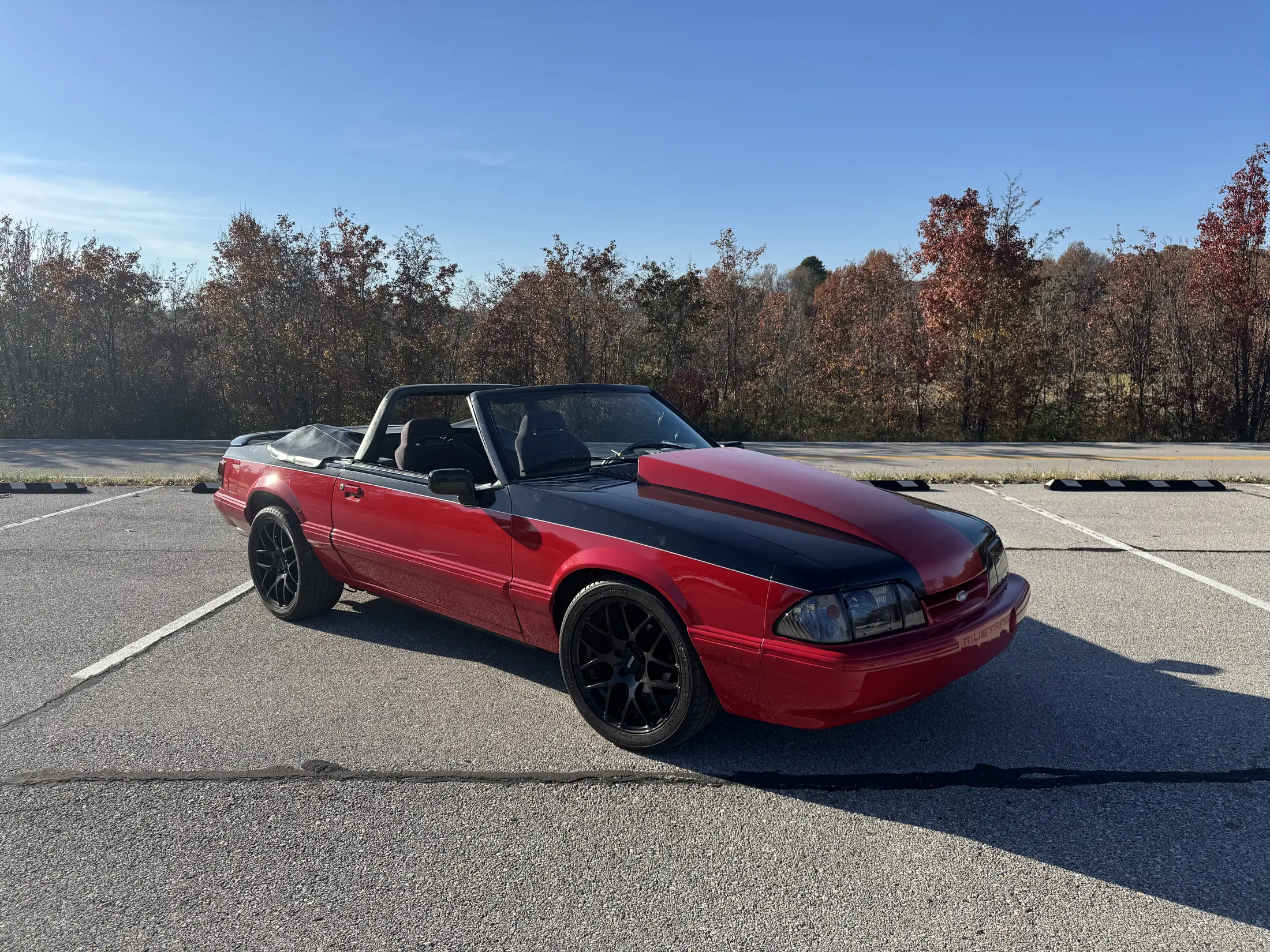

I have 255/35/18 General G-Max up front with no rub and currently have a 285/35/18 in the rear (previously had 275/35/18s). These are on 18x9 Saleen Reps with a +24 offset. I do run a 8mm spacer in the front as otherwise my rim would hit my coil-over spring (rim rub, not tire rub).
First pic with 285s, second with 275 rears. 255 fronts in both.

My belief is its tire diameter that affects tire rub the most, so the 255/35/18 (25.2" diameter) gives good footprint and not rub. Your 255/40/18 are 26.2" which is almost 0.5" taller than stock - hence rubbing.
265/35/18s are only 25.4" diameter (less than stock diameter), so would give a good footprint and likely less rubbing.

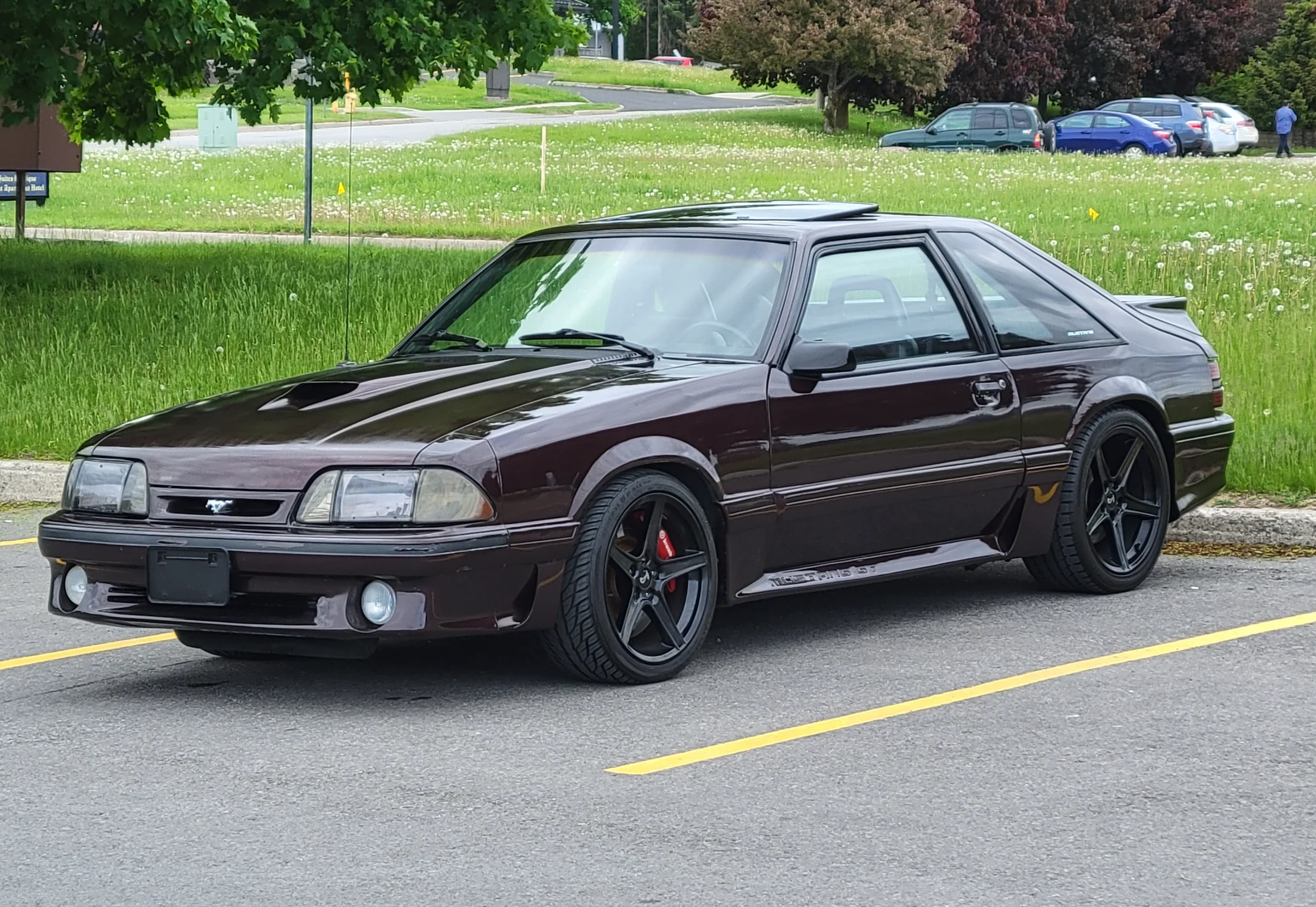

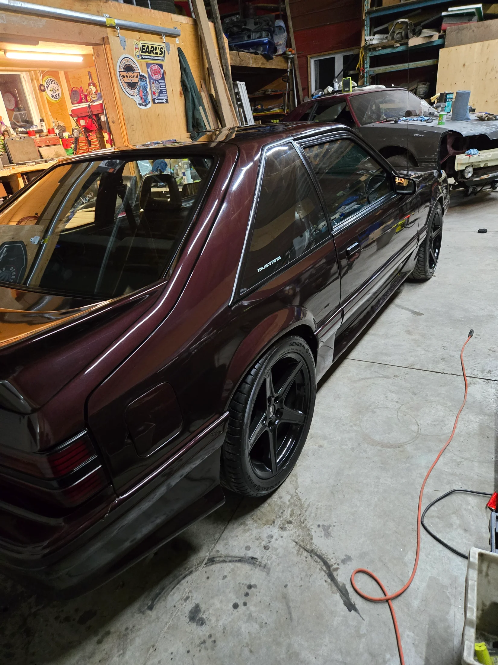

I did 245/40/18 up front on mine, and it is close. Offset of the wheel plays a role too. I had to add a little bit extra camber to my front coil-overs to get it to tuck into the fender on bumps, and had to clock the spindle/strut orientation to full out before tightening up the strut bolts.
But it did clear without contact. I did lower the car a bit after this pic. 245's on a 9" wide wheel do look a little stretched which I wasn't a fan of.
