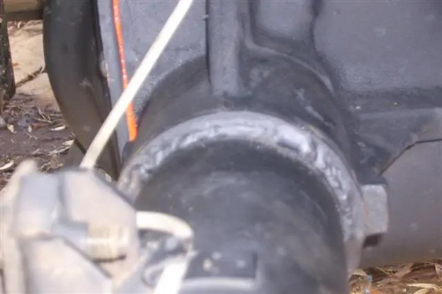

what do you mean by "tubes"?
The "tubes" are the hollow part of the rear end where the axle shafts are inside of basically. you would weld the tube where it's pressed into the diff housing. This can be a weak spot and the tube can rotate, etc. here is a pic of a welded up 8.8.
