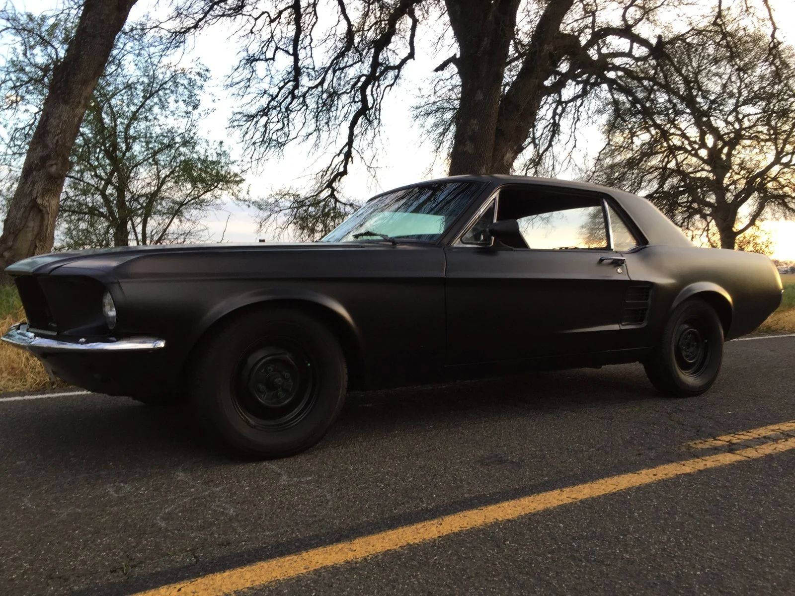

Whats up everyone? My name is Aiden and my 67 coupe is named Amelia! I've had her for coming on 5 years this June. I built her all with my dad. She's got a 200 straight 6 and I am ready to move up to that 289. I have the motor but I am looking to do more of a performance build this go around. I am wondering what modifications you guys recommend for adding horsepower. I am open to any ideas. This is the beginning of this process so I am only starting with research. In the meantime I need to get her back up and running because I sure do miss driving her haha.

Before you even think of going that route, you will need to upgrade your suspension, brakes, and rear axle to handle the weight and torque.

I know. I have 4 disc conversion, 9 inch rear end and what not already. All that will be done first.
