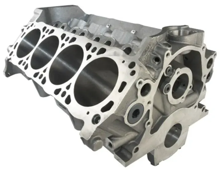

I very well could be overthinking this. I was doing some research and it says a new block requires an inspection and sticker just to get a smog. I am not wanting to spend $15K getting this car where I want it only to get state ref'd right out of the gate. I also don't want to run a stock block and risk it going bye bye. I am trying to stay right at or just under 450 rwhp. From what I have read that is close to the limit on a stock 302.
Dropping $2,500 on a Dart or Boss block sucks too because I don't ever plan on pushing the sort of power those can run.

It does suck, lol. Besides a money grab by the State, i'm genuinely curious as to why anything else matters except for what comes out of the tailpipe. If it passes some required (and reasonable) threshold, what does anything upstream of the tailpipe matter? Being a Cali resident, i can at least understand the want for clean tailpipe emissions and no venting stuff to atmosphere. Otherwise, let it be what it is.
That Boss block is nice. Whats the power limits to that one?
Lots of folks making 800-1000 hp and some making more here and there. I would say keeping one together at that hp level is good parts, good machining, and a good tune.
