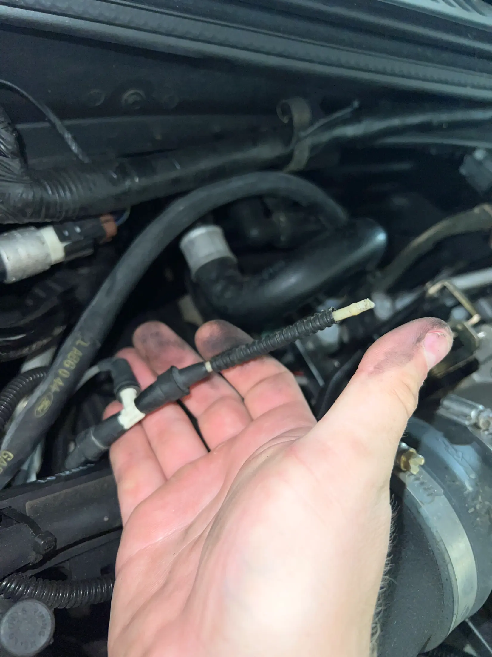

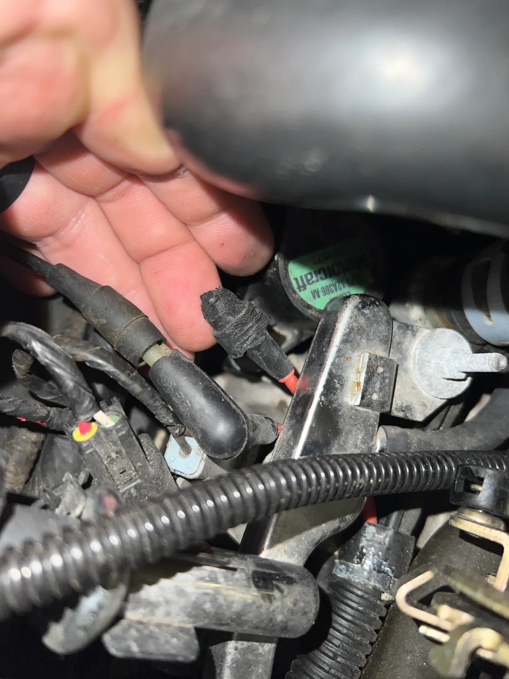

When poking around on the engine today I noticed some vacuum hoses that look like it has an animal chew up. Passenger side near the firewall there was a red line laying near the spark plugs and another white line coming off a T. Anyone have a diagram or pictures to help me know how to route/fix/replace them? (Pics attached of the damaged lines.
