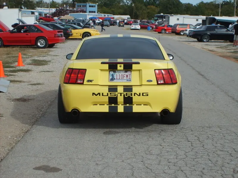

I think with stock rear springs, you should be alright. Mine is lowered 1 1/2", and with 27x11.5 Hoosier Quick Time Pro's, it rubbed slightly. The Hoosier's are actually 10" wide. The 28x11.5 MT ET street is listed at 8.6" wide. With both of those tires mounted on a 15x8 rim with a 5.5" backspacing, the MT's will sit a little narrower than the Hoosier's I had. With either of these tires, it should have plenty of clearance for your exhaust also.
If I were you, I would get the 15x8's with a 5.5" backspacing. It will give you a wider range of tires that will fit the rim.
Here's a picture of how it sits with the Hoosier's...
