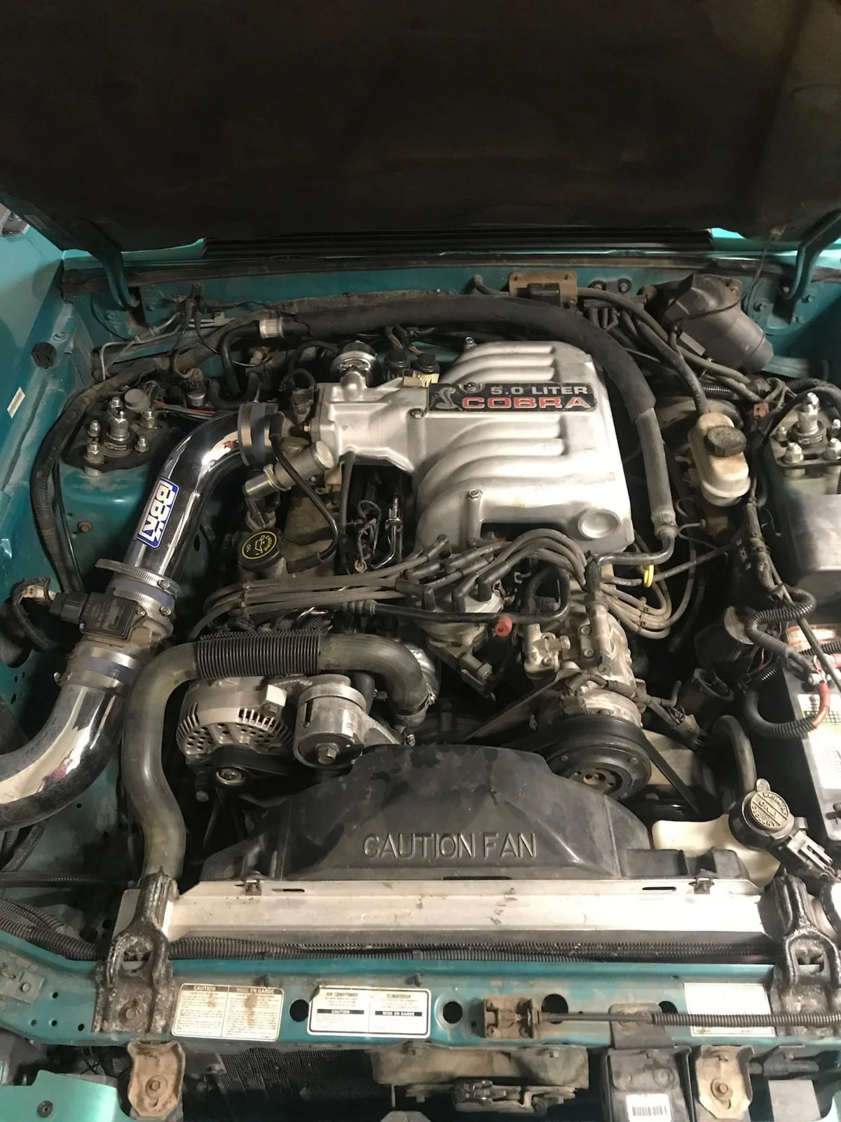

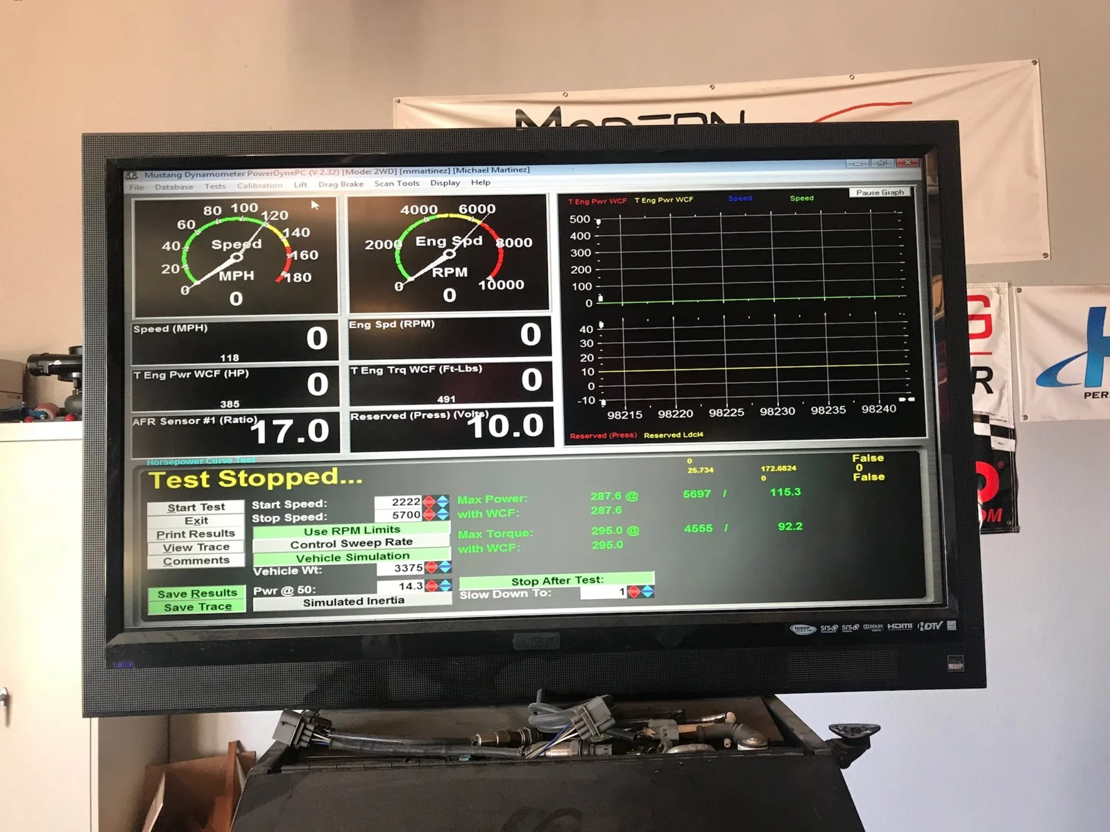

So I have a 93 LX car has edelbrock heads, cobra intake, scorpion roller rockers, stock cam, stock 19LB injectors, bbk equal length headers, bbk cold air intake and pro m air meter and has been Dyno tuned fox also has subframe connectors. Car runs great daily driver and I put a ton of miles on car yearly.
I have read and done so much research on poly motor mounts, rubber anchor motor mounts, poly transmission mounts, rubber transmission mounts but have not come to any definite info on any of these issues.
currently I still have the OEM rubber motor mounts but not cracked yet, and debating on changing to new I’m sure motor mounts are tired now after 26 years. But also have heard Anchor brand mounts are terrible as well so no help there.
Now transmission mounts are Energy suspension as are crossmember mounts as well all poly car runs great but I can feel small faint vibration from motor especially when motor revs especially when in neutral. But when running not much vibrations seems to run better at speeds of over 85MPH.
It I also read don’t mix poly and rubber , or either go all poly and deal with small vibrations or go all rubber but beware anchor mounts are junk!! And if you mismatch do rubber trans mounts and use poly motor mounts or vise versa.
Again my car is my daily driver I live in Maricopa county Az but drive my car to San Diego Ca twice a month she is very well kept and clean I get good gas mileage and she’s not abused at all but would like to hear everyone’s opinion on this subject who has gone thru this issue. I am aware I am driving a rattle can that makes all kinds of noise going thru or driving thru roads that are a bit rough or neglected but would like to go without trial and error periods.
