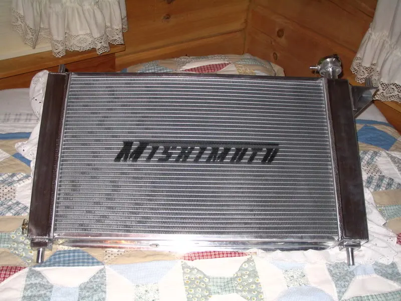

Mishimoto was great about replacing my first leaky radiator, but now the second one i got is leaking again like the first one after only a couple of months. It is a slow leak on the passenger side, just like other people have had issues with. I personally think the solid welds from the crossovers to the side tanks cannot hold up to the constant expanding and retraction with the heating and cooling of the aluminum (which is why the plastic stock ones hold up much better).
I love the cooling but i am tempted just to go back to stock because i am tired of changing out leaky radiators and don't want to keep paying for shipping on warranty replacements. Anyone tried to have mishimoto refund their money? I bet they will just want to send me a replacement...
The passenger's side of the radiator leaks for everyone 'cause that's a flex point for the chassis. All my radiators have leaked from that side, no matter what the brand. I wonder, if you installed subframe connectors would you keep getting radiator leaks?

I guess the chassis flex is the same principle as my theory about the flexing with heating and cooling...either way i guess the plastic stock one has a little more give than the solid welded aluminum ones.

Granted I have a vert... but with the 4-point, welded in subframe connectors I had my mishimoto last only weeks before the braze joints cracked with a good bump to the suspension...
Also failed on teh pass side of the car...

its just a point at where the chassis will flex when under load. Do you guys that have had them leak run a strut tower brace?
Dont use stop leak, it's no good and will void any warranties you have. The OE Visteon replacement rad is more than enough for your combo unless there's something I'm missing, and the best possible radiator that can go in the car besides the Visteon all aluminum imo :shrug:
Flyidyne's stink and have a high warranty/failure rate, I don't work in cooling parts any more but I'd imagine these Mishimoto crappers are even worse from what I've seen and heard just on this forum.
