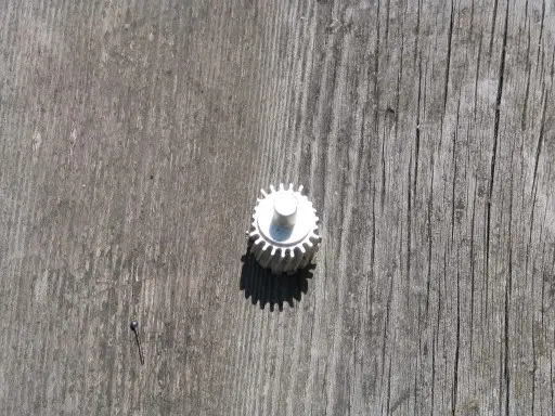

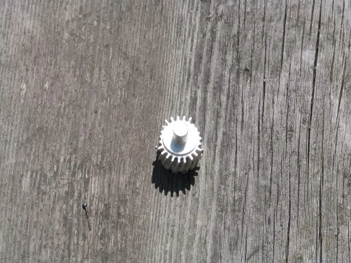

Here is a photo of a white gear that was in my T-5 when I bought it. Notice the dental problem between 1 and 4 o'clock and 7 and 11 o'clock. I was subsequently told that the white gear is actually for a Jeep and it does not mesh properly, leading to a loss of teeth. I've changed the oil twice and think I have most of the missing teeth out.
