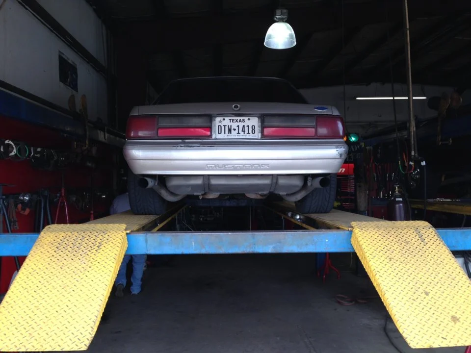

I have 3" VRS tails. They do rattle in places. I recently got a few of them fixed, but it still hits on the UCA mount on the body and rattles sometimes. Excuse the dirt, it's been raining like crazy.
Reactions: GoldenEagle91
