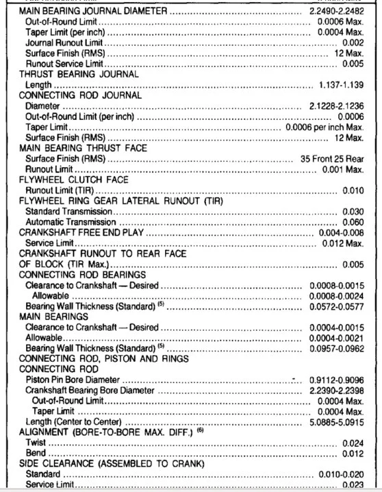

Anyway if someone could also tell me the specs for the crank that would be appreciated I'm getting around 2.12 on the rod journals and 2.24 closer to 2.25 on the mains

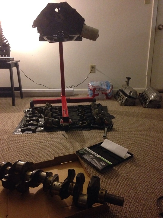

Engine in the house huh, you either aren't married or your wife wants to kill you.

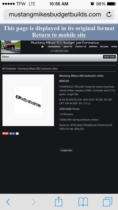

And I was thinking of this for a cam thoughts?
Damn. I'm not married and live alone and the sight of an engine in the house is making me cringe!
Then again, i have rebuilt T-5's in my living room and cleaned various rims and other car parts in my tub.

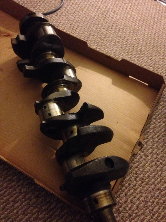

Welcome.......... a couple of observations
1. NEVER lay a crank down on its side like that. It can create crank creep and distort/warp the crank.

You are building it in your living room, which doesn't exactly inspire confidence (I say that with a smile:rlaugh:) and clearly you don't want to do this twice. The fact that you thought ported e7's were a better choice than aluminum and 2 days ago you had a completely different plan doesn't help either. No insult intended, we all have to start somewhere, I just don't think that somewhere is rebuilding a shortblock.

Well I'm outsourcing the machining so I'm in no means doing anything in my apartment then just assembling it once everything is said and done I get what your saying about the 5.0 explorer I looked around couldn't find one within a respectable distance I searched on Craigslist for a while this is all I could find for a decent price and low miles the ported E7s was something I found write ups on during research and is the main reason why I spoke about it on here to get your opinions and why I was quick to take your advice on it don't think I plan on doing anything precision based in my living room as I said before the only reason it was in my apartment was for the initial tear down and assembly once everything is ready to be bolted back together and will be dropped into my fox at my buddies shop. I'm working with what I got it gonna cost more than I anticipated but I'm fine with it this something I've wanted to do for a long time and I'll spend the money if I have to.
