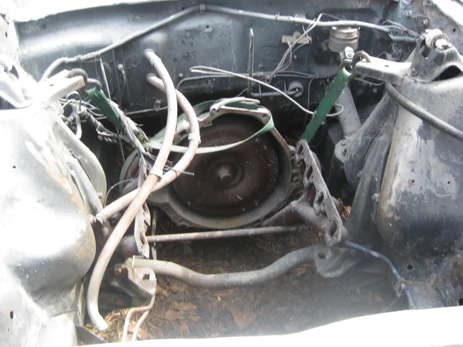

Getting back to the 66, here is a picture of the engine bay. Not great, but I found a 289 I think I am going to drop in it. There is already a C4 trans already in it.

Your 66 has 65 frame mounts in it. It will require 65 upper and lower motor mounts. The upper mount bolts to the block and then the lower mount has a hole in it that bolts to the upper mount. There is a stud hanging out the bottom of the lower mount that goes into the hole in the cast iron frame mounts. Do you have the mounts that were on the 302? The 65 mounts are unquie to 65 only. If you no longer have the mounts, you will have to get both or change to 66-70 style frame mounts. Cheaper and easier to find, also correct for your car. I would then be willing to buy the 65 frame mounts from you. I have two 65's and one is missing the correct mounts

I have no idea the difference in the mounts, but someone posted I have 65 mounts according to the picture. He said these mounts are specific to a 65. The motor I am looking at comes out of a 66, but if they will not work with mounts already in car I may just wait or have to change the mounts. I don't know much about this 66. I picked it up about 3 years ago and it has been in my barn ever since. Some started to restore it and only told me they set it up for a 302 nothing about it having 65 mounts in it. They also said the C4 in it has a shift kit. According to the VIN number the car is a 66.
The block is the same on all years. The differents is the frame mounts in the car, not the motor. The frame mounts dictate what motor mounts you have to use. The 65 year cars have a 3 piece mounting system. 1.) the motor mount 2.) a middle steel mount 3.) and a cast iron frame mounts. The 66 and later years all use the same two piece design. 1.) Stamped steel frame mount 2.) Motor mount that bolts to the block. You can not use 66 motor mounts on a 65 frame mount. They are total different. The frame in the car is the same from year to year just the frame mount that bolts through the frame is different. The easiest solution would be to get the proper 66 frame mounts available from any mustang supply house or used ones on ebay. Then use the mounts he has. The 65 motor mounts are still available but the steel middle mounts are hard to find and the cast iron frame mounts are getting even harder to find. In his picture you can see the cast iron 65 style frame mounts with a square vertical hole in them, not the horizontal hole that the 66 and later frame mounts use. Hope that helps!

So what? All 66 V8 Mustangs had the "65" style mounts until 11/1/65, so it's very likely the ones you have in the car are original equipment, since all August, September, and October-built 66 Mustangs had the "65" mounts. They will still attach to the 302, heck, if you bought a new BOSS 302 Ford Racing "crate motor", THAT would attach to your "65" mounts. Really. I'm not kidding.
I will repeat my first line again. The block is the same in all years. Thats not his question. If he has the motor mounts that were on the 302 that was in his car, then he needs nothing. If he has to buy motor mounts, then good luck because he is missing the middle steel mounts. He asked if a 289 will fit on these mounts. The answer is yes, if you have all the pieces. Which I will guess he does not. Most people just take the nut off the middle mount when removing the engine with this style and I will bet that the steel mounts are still with the 302 in who knowsville
