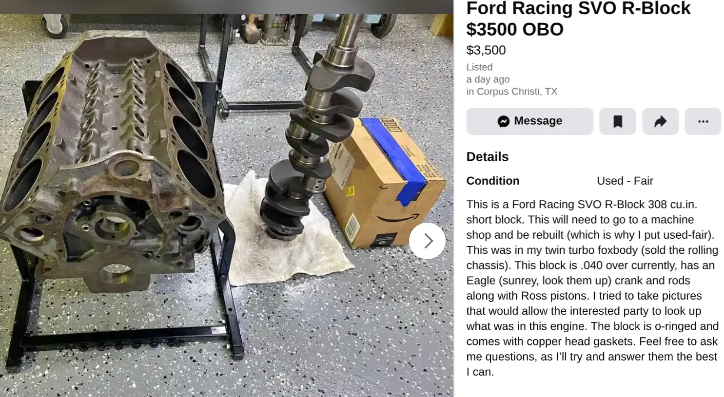

Here's a guy that wants $3.5k for an R302 block, which is an awesome block, but from reputed sources doesn't stand up to anything from Dart. Couple that with what I posted about Dart SHPs above, and I couldn't see paying more than maybe $1,500 for one that still needs to be machined. And, unlike the Boss 302, which is a platform with the occasional desperate and rich collector that might actually pick up the $6k NOS above, I don't see any collector value to an R302, at all. This one comes with some Eagle Crank & rods, though I've come to understand that Eagle does not enjoy the same reputation as other companies from the machinists and engine builders out there. And, I could demonstrate brand new forged Eagle 302 crank for $500 on FB marketplace right now. So, I think he's really over listing this one, but time will tell.
