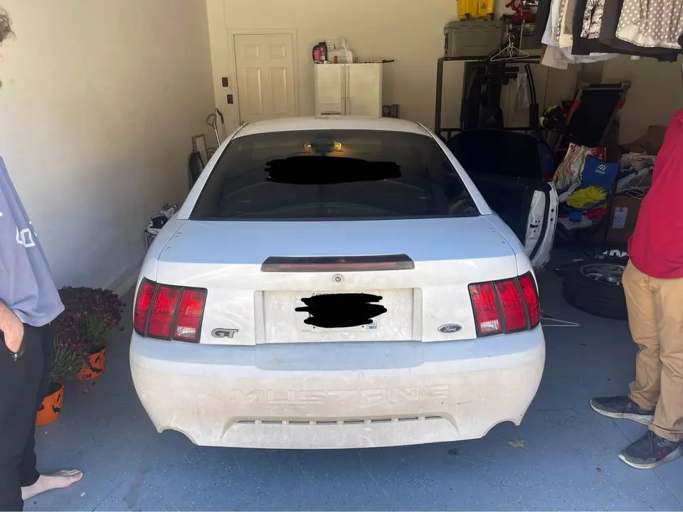

What's your budget? Here's a manual GT that was just listed on bookface for $5k in Atlanta.
LOOK everybody!! Someone who knows how to use the edit feature on their smart phone instead of using their finger to block the license plate!! :eek:
That in and of itself might be worth their asking price!! :rlaugh:

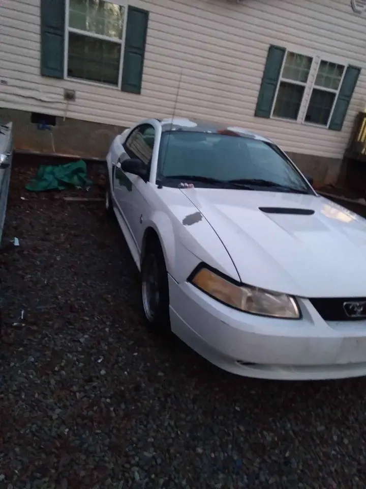

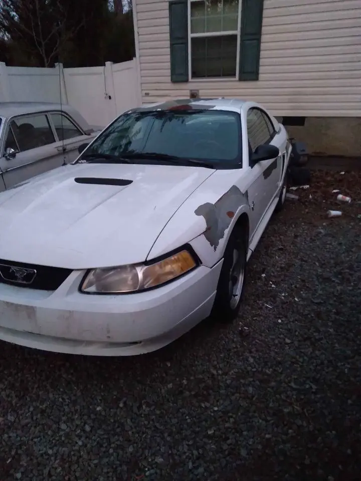

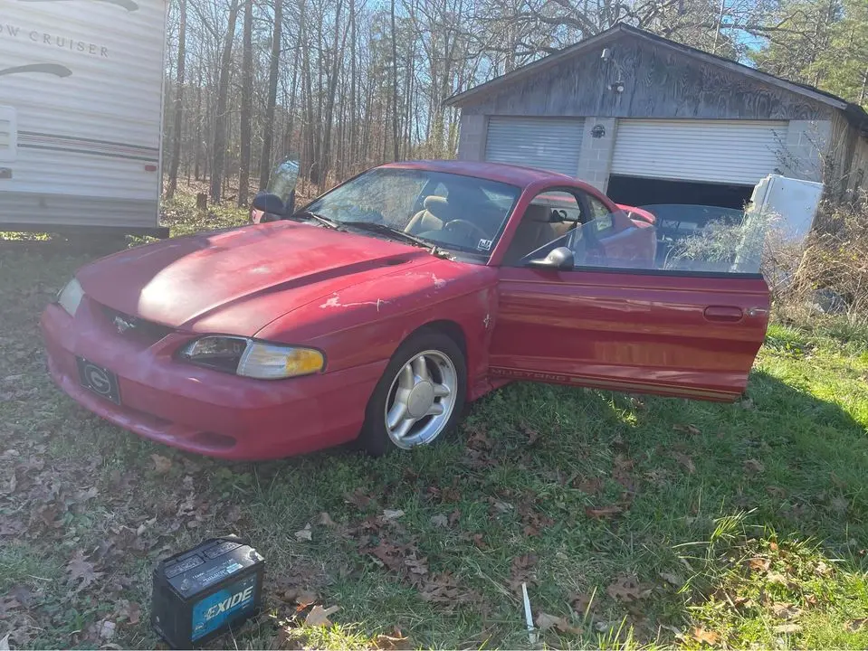

Since you said earlier that you don't care if it's a 6 or 8, how about this one for $1k? At least the price for a project isn't too horrible. Unfortunately it's not a manual.
The other pics are interior shots, and since you said you didn't care about that I'm not copying/pasting them.
