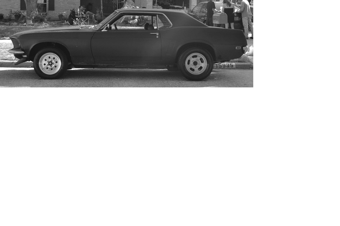

we just bought this car. owner said it was a 302 and he turned it into a 306. Can anyone tell me what may have been done to it to make it a 306?

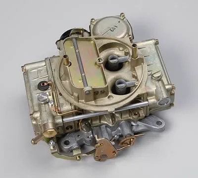

306 is just a bored out 302 (.030) nothing fancy. Need to know more about the internals of the car to really suggest a carb...but an 1100 is definately WAAAAY to much. The 500 is probably a good carb for it, but being a mechanical secondary, double pumper its probably not the best for fuel consumption.....see if you can get some cam/pistion/compression ratio information. Also what kind of heads/intake/exhaust is on the car.

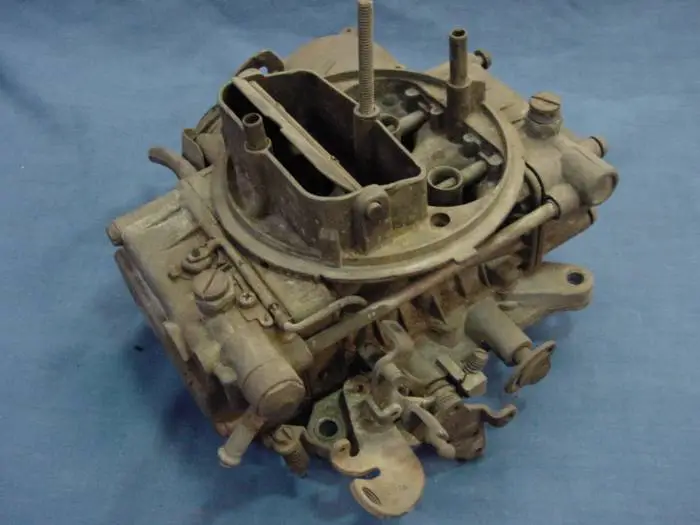

Can you get a number off of the choke tower of the carb? 500 is a funny sounding carb....it may be a 600 dp carb. Also are you certain its a double pumper and not just a standard 4 barrel carb...more people than one would guess don't know the difference.
I am becoming a big fan of good ol autolite carburetors (ford factory) they are very no-nonsense easy to configure carbs. Holley's are great if you have time (and a phd in the theory of carburetion) to get them set up. I have never owned an edelbrock, but have heard good things about their street manners.

Yep. An ordinary rebuild. No one does this to get the one or two hp that result.
All I can say is it has a mild/wildish cam...
Which is it?
The idle is sky high and it has a holley 500cfm double pumper on it. He threw in a holley 1100cfm double pumper too....said it was too much for the car.
A double-pumper is overkill if it has an auto trans. An 1100 cfm carb is total insanity on anything this side of mega-dragsters.
wondering, with a 306ci, what is the best carb route you guys have used that worked out best....?
If the cam is stock-ish, use a 500 vacuum secondary. If it's pretty stout, use a 600 cfm vacuum secondary. If you are racing the car, use a 600 or 650 double pumper.

it is a 500cmf Holley...not a double pumper.

The C6 was used on the 351C 4V engines, but the FMX was used on the 351C 2V. The C6 has, IIRC, 30-50% more parasitic drag than the C4. Unless your 302 is a racing monster, it would be a pure waste of money to install a C6. The C4 has proved to be extremely versatile and upgradeable, capable of handling more power than your engine can produce.
