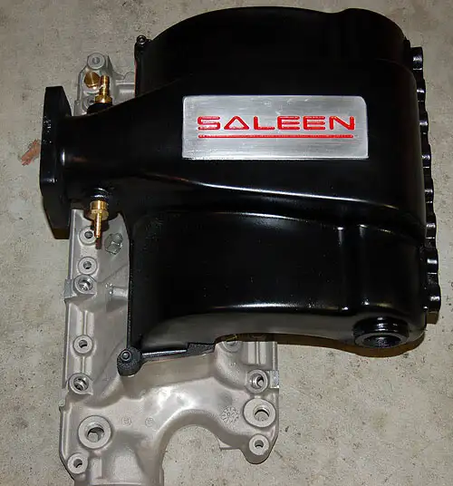

The Saleen, Saleen/Vortech, Vortech use the truck lower..

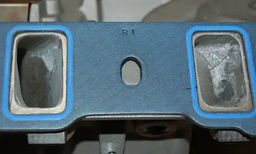

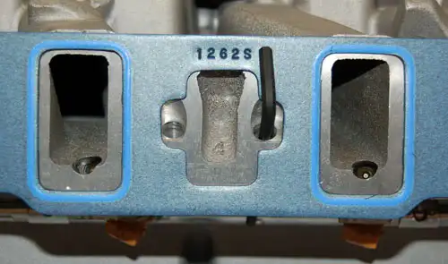

I had mine ported by Tmoss over on Corral..
Before
After
Sorry, no before and after comparison, but it definitely flows more now!
