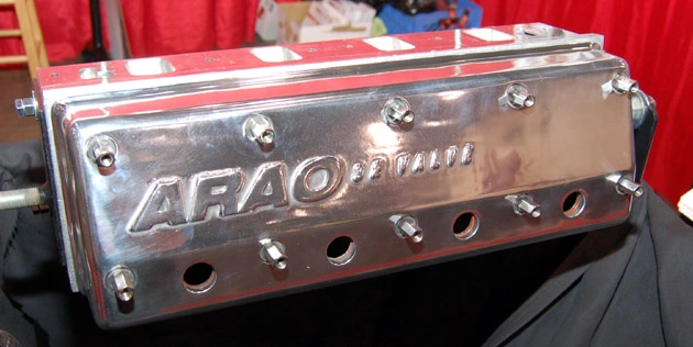

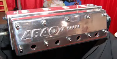

32 valve dominion arao ford heads
I was just doing some searches on the site and came across this thread, I know its old but I thought it would be good to post some 32v ford pics as I have a few sets of these 32v sbf heads. I have a bunch of tech I could post if anyone does have any questions about these pushrod 32v heads, just ask.
I recently ordered a complete 428w RPM MAXX short block from FPS to put together a Clevor version setup with these heads. I am converting this set to a boss int port right now for big ci.
This set FPS ported and I will also finish converting these to a boss int port for a big ci blower app...

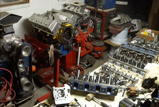

This is what I am putting together now, a 32V 428MAXX. The short block FPS built, in pics you can see the 4 valve piston reliefs needed for these heads. FPS did this for me and also cut a custom 4 valve cam also. I found out FPS has built a few of these 32V ford versions so it was an easy choice to get FPS's help with my project too.
scaled.php
scaled.php
scaled.php
scaled.php
scaled.php
scaled.php
Hi these engines are going to be a street/strip deal. It definatly has been a fun deal so far getting into this 4 valve pushrod tech. I was heavy into clevelands in the past too so getting more into the Clevor stuff now has also been fun.

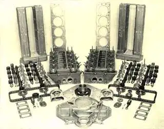

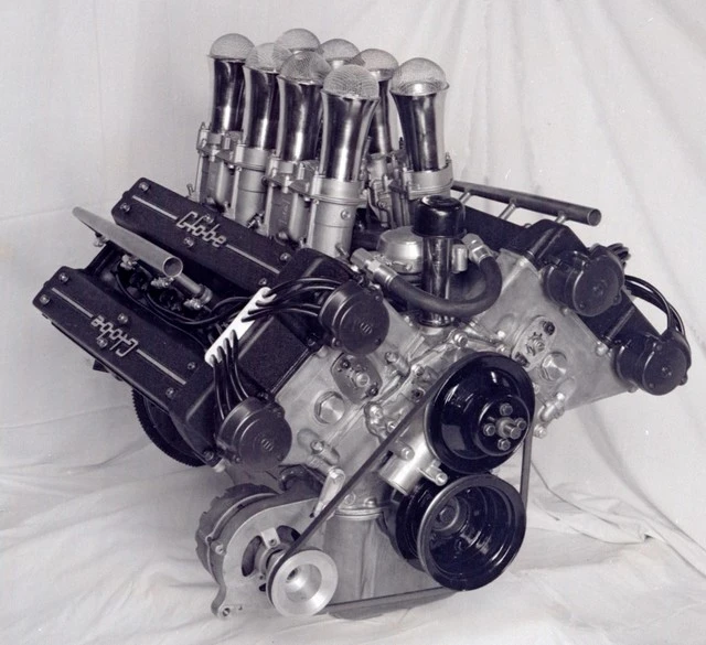

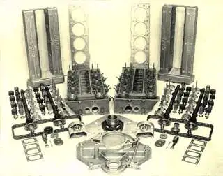

I heard that ford was advertising some type of 32 valve conversion kit also in some old pantera advertisments and I did find a SBF kit by Globe, been wondering if it could of been the same one, a very trick kit.
