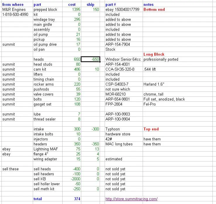

FWIW-the pigtail for the "new" style mafs cost me 60$ from a dealer at COST. From a past buy my father-in-law told me to tell them I was his son-in-law and they now have me listed to get parts at cost....maybe its a dealer to dealer thing but I gen. have really good prices from them either way.
PR will also be around 100$ for hardend ones.
I am not a big fan of the PP stuff but if you get a good one...
For assem. lube buddies and I have had GREAT luck with the STP engine stuff. its thick as hell that makes for a great sheer(sp?) factor and thats a good thing.
I would be leery of a 331 for 1395...just me but it sounds alittle too cheap. If its legit then DAMN.

summit sells hardened PRs for $55
the PP has already been bought, i think i got a good price on it, it fits in with the budget and it looks great.
M&R has a good reputation :shrug:
BlackVert said:
with stud mounted Harland 1.6" rockers, will i need tall valve covers?
I am running those on my Trick flows and using stock valve covers had to massage them a little. with a BH . Take out the ? backsplash/baffle? . but they work. Then had oil coming out the breather and had a baffle put in to stop it.
I love it man. That is the same thing I did when I was preparing for my 331 build. excel spreadsheet's are great.
Will need to check if pistons need to be notched for those bigger valves on windsor sr heads I would think. Looking good keep informed!
