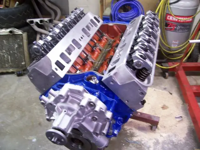

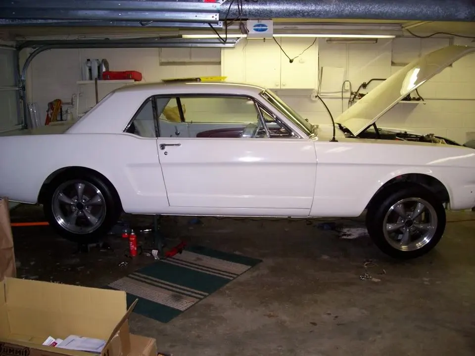

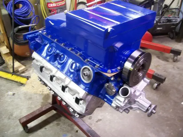

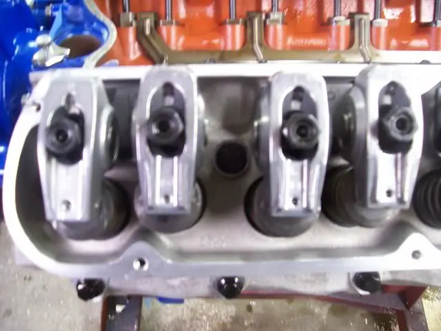

I have not posted any progress on this forum, but I have been at it a good portion of the winter. I have built a CHP 347 in a roller block with 10.2-1 compression. It has forged pistons, rods and a cast Scat crank. All hardware is ARP. The heads are twisted wedge and the valve train is Comp Cams. Cam is the XE282HR which is a good all around cam. It is a carbed motor so I have a Weiand stealth intake and a Proform 650 carb. Misc items are the Mallory comp 9000 dist, Canton road race pan, fabricated valve covers, Headman elite 1 5/8 headers, aluminum water pump and many other new items. I am guessing around 340hp and tq to the rear tires. Here are a few pics for you guys to look at. BTW, its all in my '66 coupe. Feel free to navigate my photobucket album as there is lots of pics throughout the motor build, most of them are on the first couple of pages.

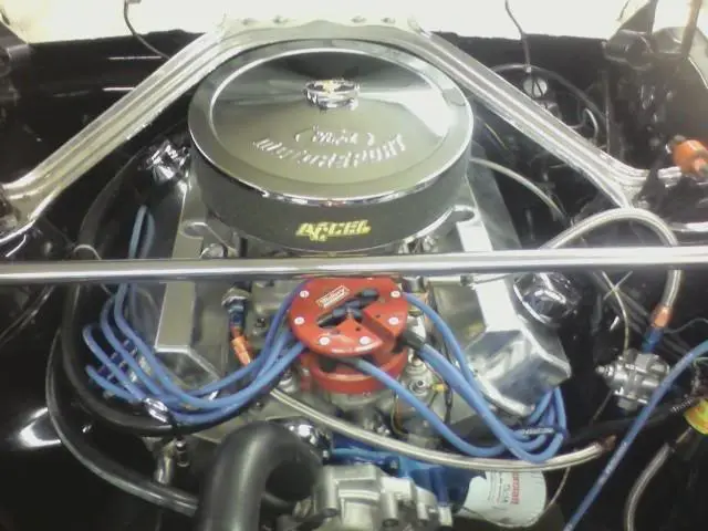

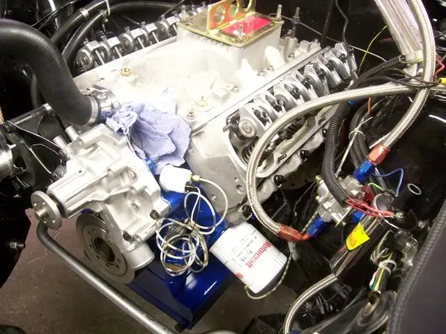

Its alive, Its alive, Its alive!!! The motor fired right up after just three pumps of the gas pedal thanks to the electric pump. Oil pressure was steady at 60lbs. We set the timing and let it idle for a few minutes. Looked under it for leaks and all is well. The new motor is very snappy when I hit the gas. I don't remember the last motor having that snap. I still have a few hours worth of work to get it all finished up before it can come back down off of the stands. Then it needs to hit the alignment shop. I will post some pics later.
Here is a pic I took on my phone. All there minus a good cleaning of the engine bay(didn't do anything with all the crazy wires under the hood yet). Bitchin!

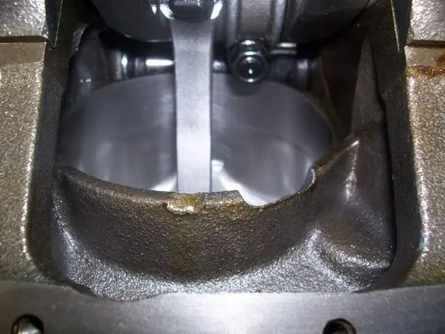

The glory of a new motor was short lived. I started the motor up sunday and it had no oil pressure. :jaw:I am not sure if it happened friday night when I was headed back from a buddies house or when I started it sunday. I only had 50 miles on the damn thing. It didn't make any weird noises or ticking so I think the bottom end is ok. I decided to pull the pan cause I'm thinking the oil pump was bad. I ended up finding a small oil galley plug all chewed up in the bottom of the pan. :mad: At this point I'm pist because I know the motor has to come back out. So, I called tha machine shop and they wanted me to bring in the long block so they could fix it. I dropped it off yesterday and they said they would tear it down and replace anything that was messed up and clean it out entirely. Looks like they are standing behind their work.:nice:

Honestly, that is a very common mistake by most engine builders/rebuilders. They replace the plugs, but do not stake them properly. Even when you you have staked them correctly, they can still come out. On all the engines that I have done, I have even moved past staking them and replacing them with screw in plugs as insurance.
Good luck and pass this tidbit on to your rebuilder. I am certain that they will complain as they will have to flush all the oil galleys afterwards, but it is worth the effort when done properly.

Quick question for you though. I notice you have that pin style plastic connector on the coil wires. I want to do that with my MSD ignition, but I can't seem to find where to buy them, where did you get them?

I did notice that the plug that did come out only had two stakes where the others had 4. I'm sure that is why it came out. I am really pist about the whole thing, but on the other hand i'm glad the machine shop is standing behind it.
pm replied...
