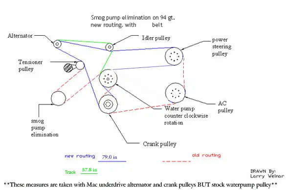

I found a diagram to route the belt for smog and a/c delete, but I don't know the belt length for it on a 351. Can anybody help out here?
Here's the diagram I found
i would try to go off the belt schematic you have. when i was shopping for belts for my 351w i had to go back and forth a few times till i got one close. i think i would buy one a little bigger than the schematic. maybe an inch or two bigger and go from there?
