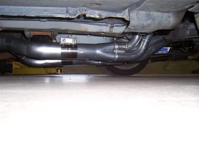

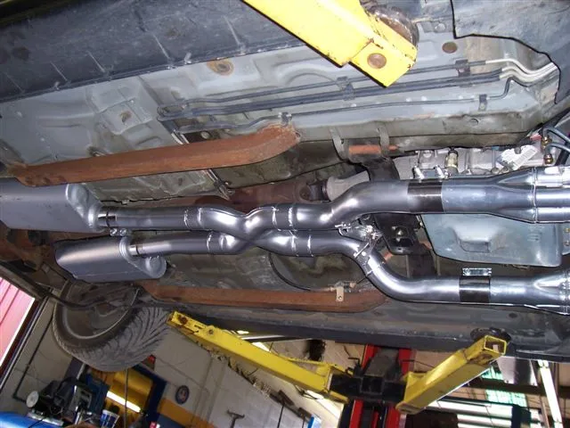

KOOK's SUCK. They should have refunded Chris in my o.
The problem(s) I had with the KOOKs were:
- they hung really low, scraping on speed bumps and driveways, Not an issue with my accufab LT's AT ALL
- they leaked like crazy, Not an issue with my accufab LT's AT ALL
- i could not find a place where i could put cats, but that may have been related to where the installer put the x-pipe CATS no issue
- they moved the O2 sensors far enough away from the engine that the sensors were more likely to cool off too much and become unreliable. DING..I bought a PMS to straighten that out.
My 414ci gained 60rwtq down below with the LT's and upper RWHP 25rwhp after all was said and done ..:flag:
