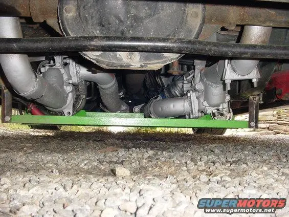

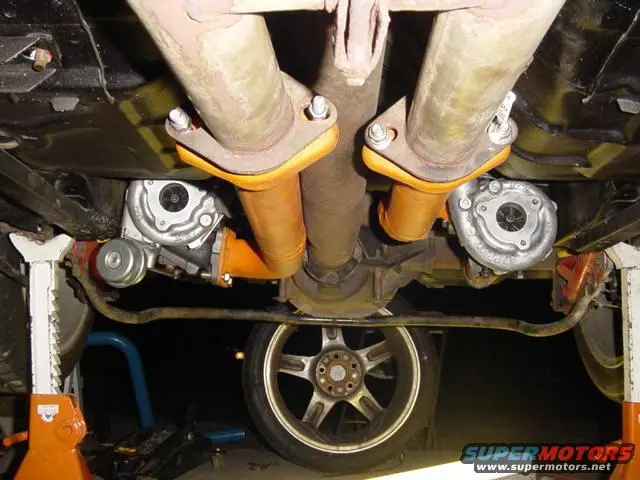

Im more worried about how sts can do a remote mount on a mustang? I tried that and it was undriveable.....ground clearance wise......

whell, i just want to know how sts can fit a rear-mounted turbo...ESPECIALLY a gt67 single......Unless the remove the gastank or cut out the rear seats there is no way they can fit one under there....my small t-3's barely fit and still bottomed on every rock.

4. If I went with a race 10 gal fuel tank, placed it on the right side, cut out some of the trunk space and mount 1 big t76, why wouldnt it work, sts has universal kits to make it work, they have there sts shops that will make it work, if under there with some trunks cut out...there will be room.
