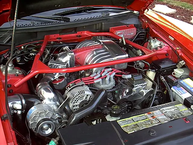

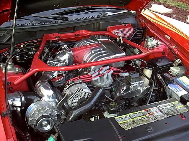

I have my old combo sitting around if you want it. Many of you members remember the GT40X, Edelbrock Performer RPM Intake (has the red painted center section and polished) with BBK 70MM TB, Crower Cam and 1.6 Scorpion Rockers set-up which ran 13.2 at 106+MPH on street tires. Well I sold the Crower cam but have a TFS Stage I in Roger's garage. Even have a brand new FRPP double roller timing chain. I can make you one hell of a deal on all of it.
Like mentioned above a minimum of 3:73's is mandatory. If I had to do it all over again I would even go 4:10's. Oh and you can get Long Tube headers, shorty H with high flow cats and still pass emissions. Probably the most aggressive exhaust system you can get with emission testing.
Here is the old combo.
beautiful :eek: the gt40X's are the aluminum castings too arent they? Id definately be interested in this (providing shipping isnt too bad.. seeing as youre in florida and im in vancouver :( ) GT40X, Edelbrock Performer RPM Intake, BBK 70MM TB, TFS1 cam, 1.6 Scorpion Rockers and the FRPP timing chain.. sounds like a killer setup. shoot me a PM with a ballpark price when you get the chance.
