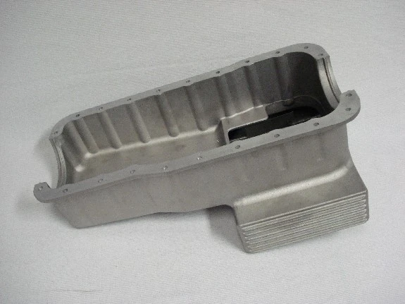

I don't see how you can use a rear sump on your 66. The crossmember and steering prevent anything but a front sump.

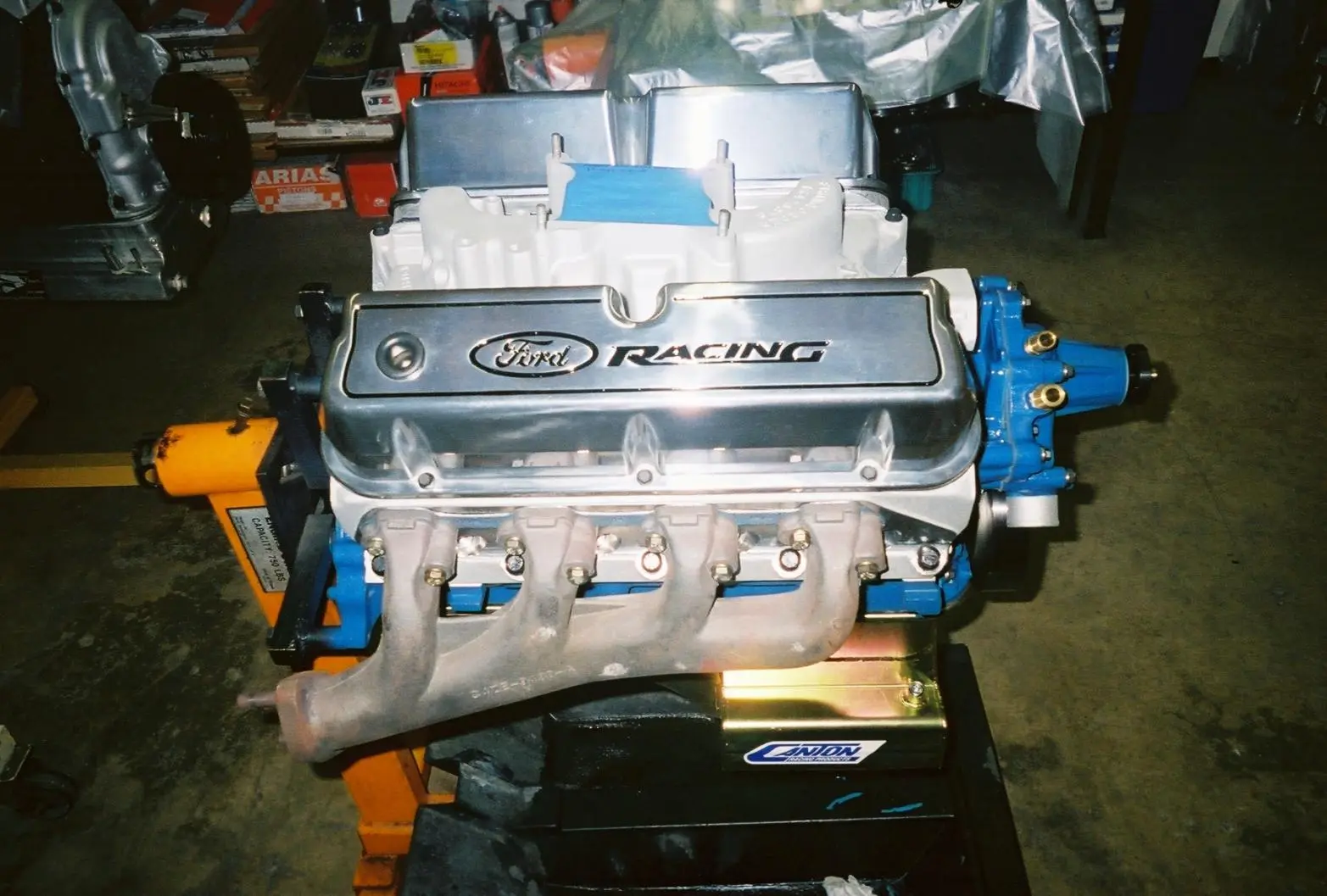

You can use stock, or aftermarket deep sump, or even a Cobra-style T pan.

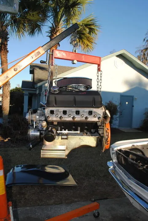

Has to be front sump like said above. I have a stock pan in mine right now because i couldnt justify the EFFFIN crazy price of a 7qt oil pan when i was ready to start my motor..
