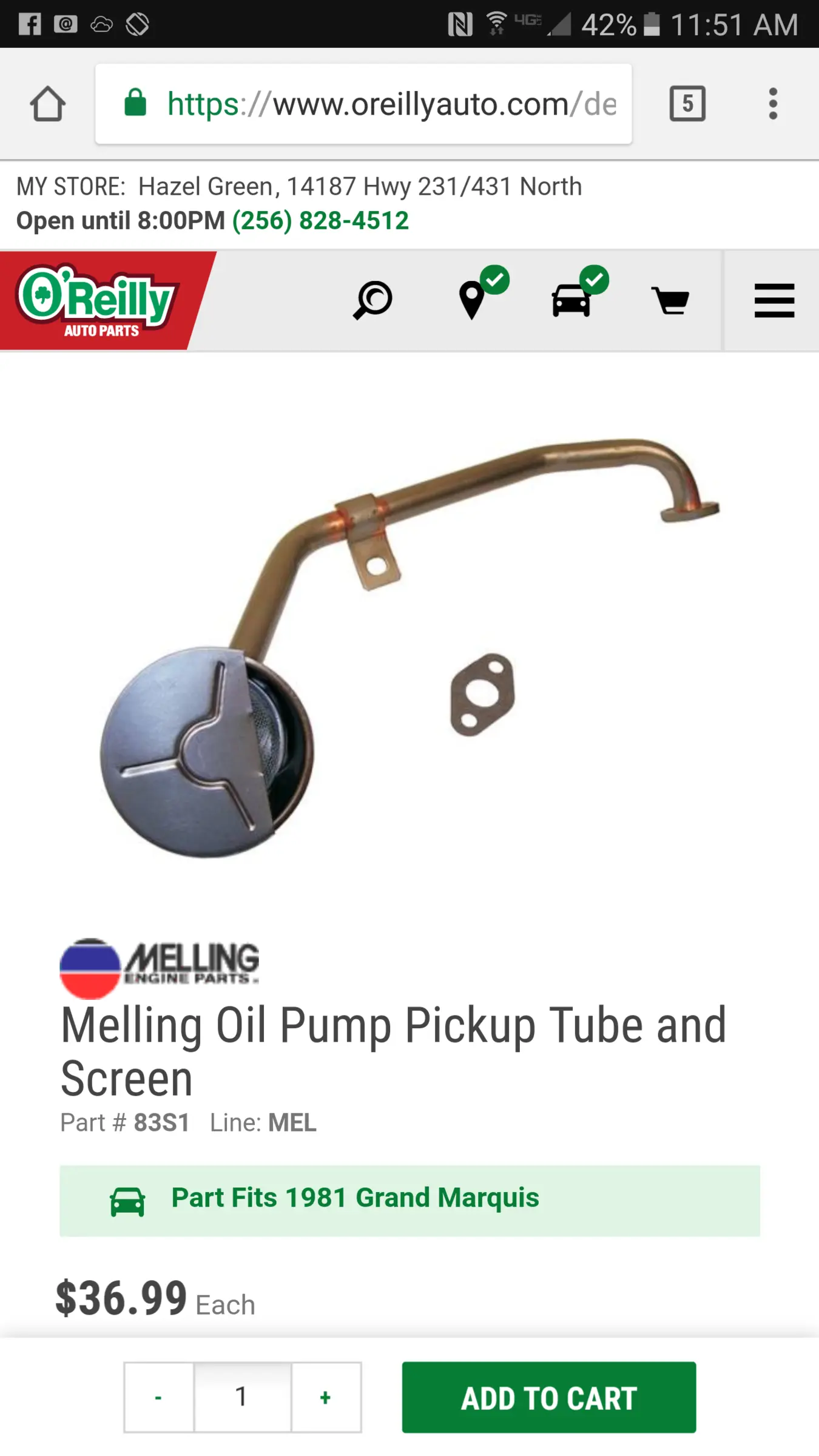

I'm gonna get this one I just saved $25 dollars from avoiding the kit. It looks like it would fit just right.
Part #83S1
