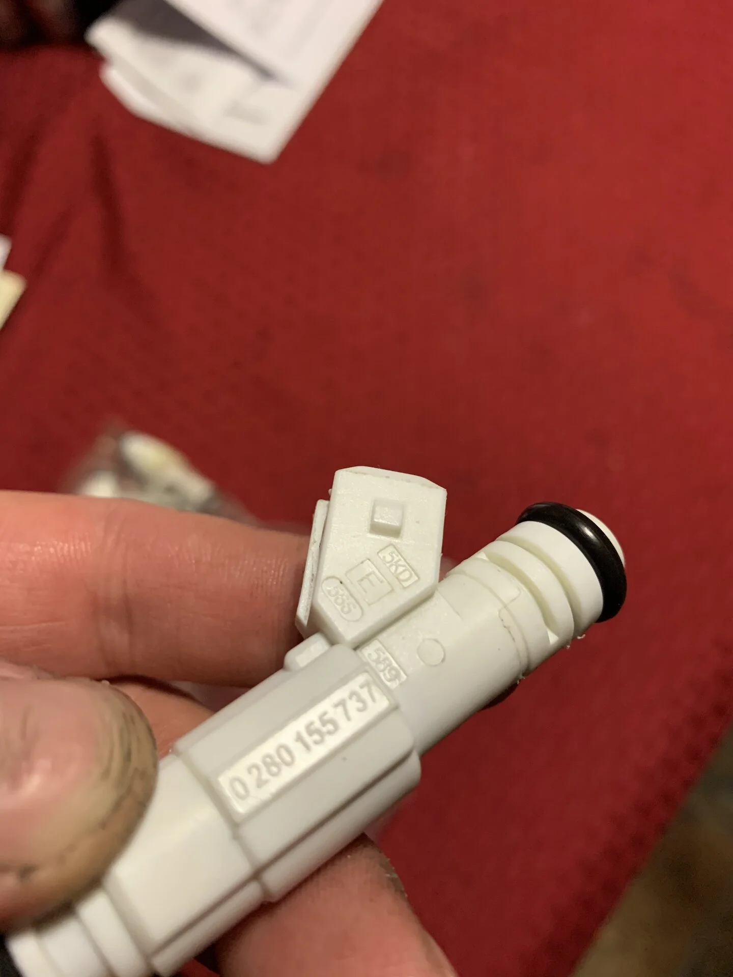

i recently bought some 36lb. injectors from an individual (he did say they were bosch) and have been doing some research and I'm starting to wonder if they are garbage eBay ones! they are white slim ev1 style plug and have 0280155737 on the side. anyone use these with success? i just spent 8k on my motor and dont want to :leghump: it up to fast!
Thanks!

Before you go sending them out and spending more money on them, are you 100% sure that's the right injector? 36's have a pretty narrow range of usefulness.
30's will run pretty much any NA 302 based engines and most would opt for 42's with a hci supercharged setup.
What is your setup?
Reactions: j753303
347 10.5/1 compression, AFR 185 Heads, comp 282HR cam, Holley systemax 2 intake and anderson power pipe. And I’m running a MS3 gold box for tuning. Hopefully be around 450 crank hp
Sounds like a pretty stout setup.
30's were probably the right number, but 36's aren't too far out of range and since it obviously has to be tuned for that system it should be fine.
Reactions: j753303
I figured that was my only option because the injector chart says 30’s were only good up to 410hp. I didn’t want to max them out or have to bump up the FP to compensate.
