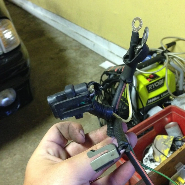

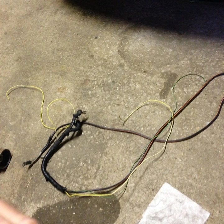

I found a mostly new looking 3G on a Taurus 3.0. While I was removing the harness I decided to see how long the stock power wire for the car was.
It took a bunch of cutting and pulling but I ended up with this for only 2$, it's long enough and has a fuseable link.

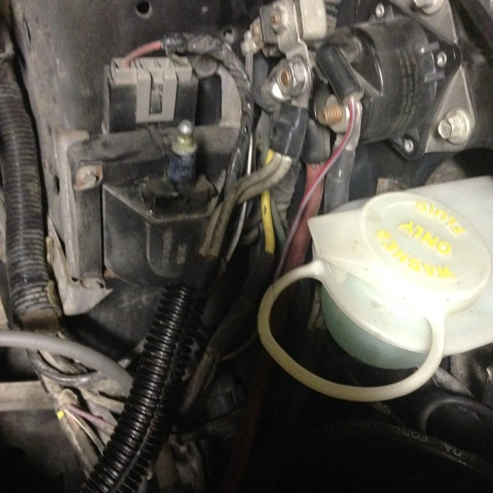

Using the harness from the car I only had to make minor changes. I had to add a ring terminal for the yellow wire and splice the green wire into the stock harness. The rest was already done from the factory.

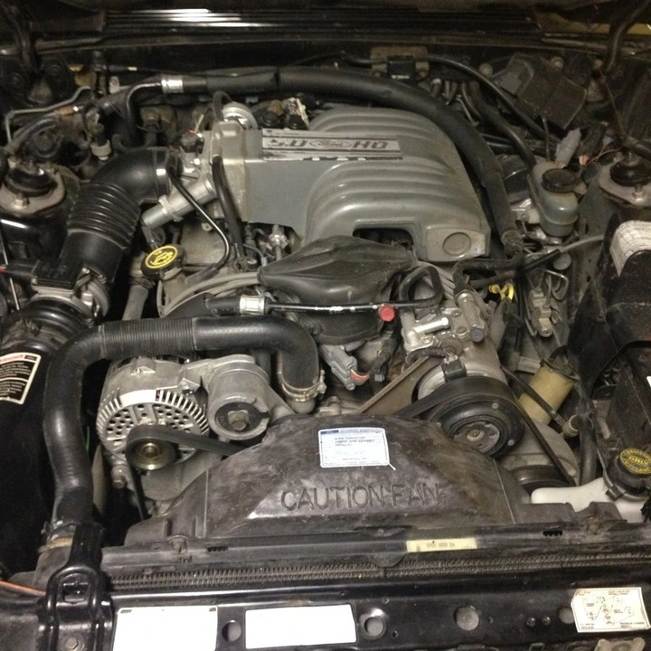

Bolt it up and it looks factory.
Just need a little more wire loom and some zip ties.
