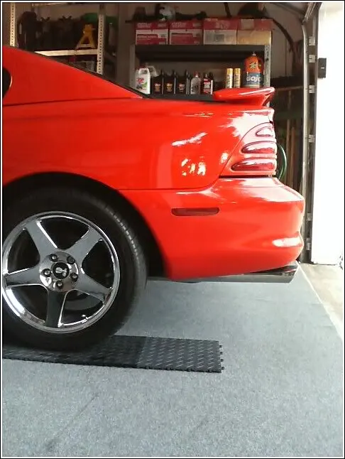

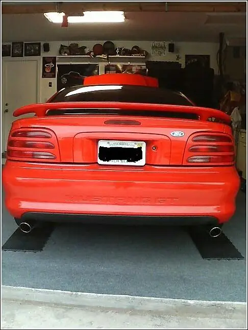

With those parts a 3 inch exhaust is worth it. I have one on mine.
Mr. VibrantRedGT do you have a tail pipe or is it dumped before axles because i thought anything over 2.5 in. causes problems clearing axle (rattle problems) and even a 2.5 in tail pipe rattles at axle area unless you buy a good brand 2.5 in tail pipe. reason asking is, if a 3 in exhaust is run and a tail pipe is added it will probably have to be a 2.5 in which will cost about $160-$300

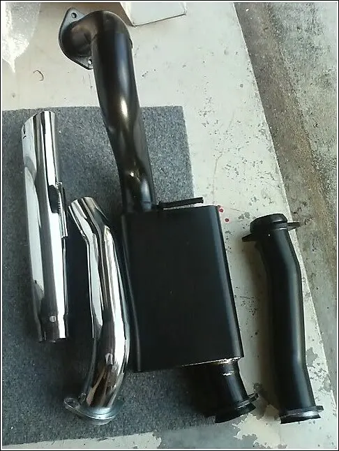

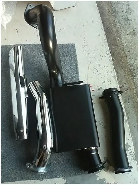

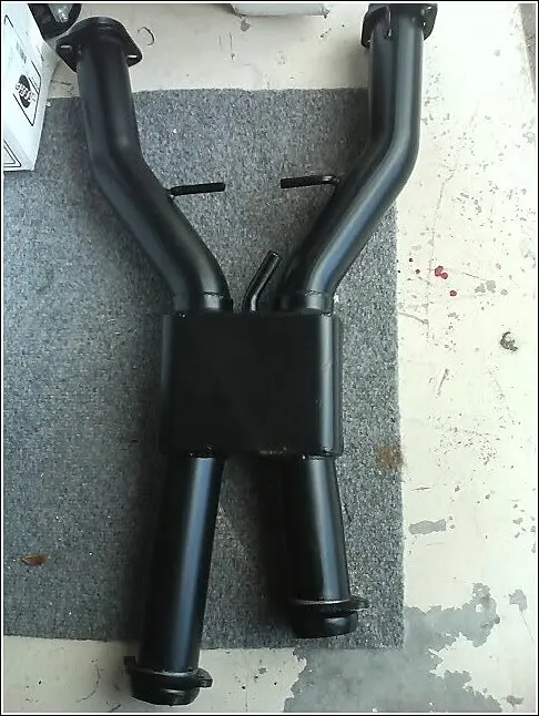

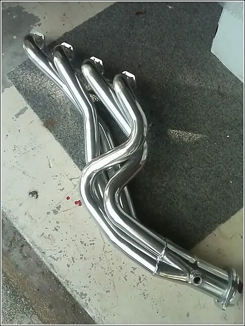

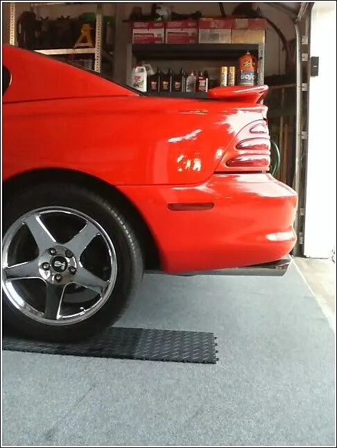

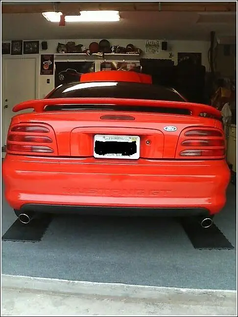

My exhaust is a full 3 inch system (collector to tips). No rattles that I've heard. Its not an easy exhaust system to install though. It took 3 people a few hours to get everything straight.
As soon as photobucket comes back up I'll post pics of the exhaust system off the car.
The ceramic is really nice. Plus I installed them with the motor out and tubular k member which means they don't have a single sratch on them from a normal installation. One scratch on ceramic is painfull on the eyes.
