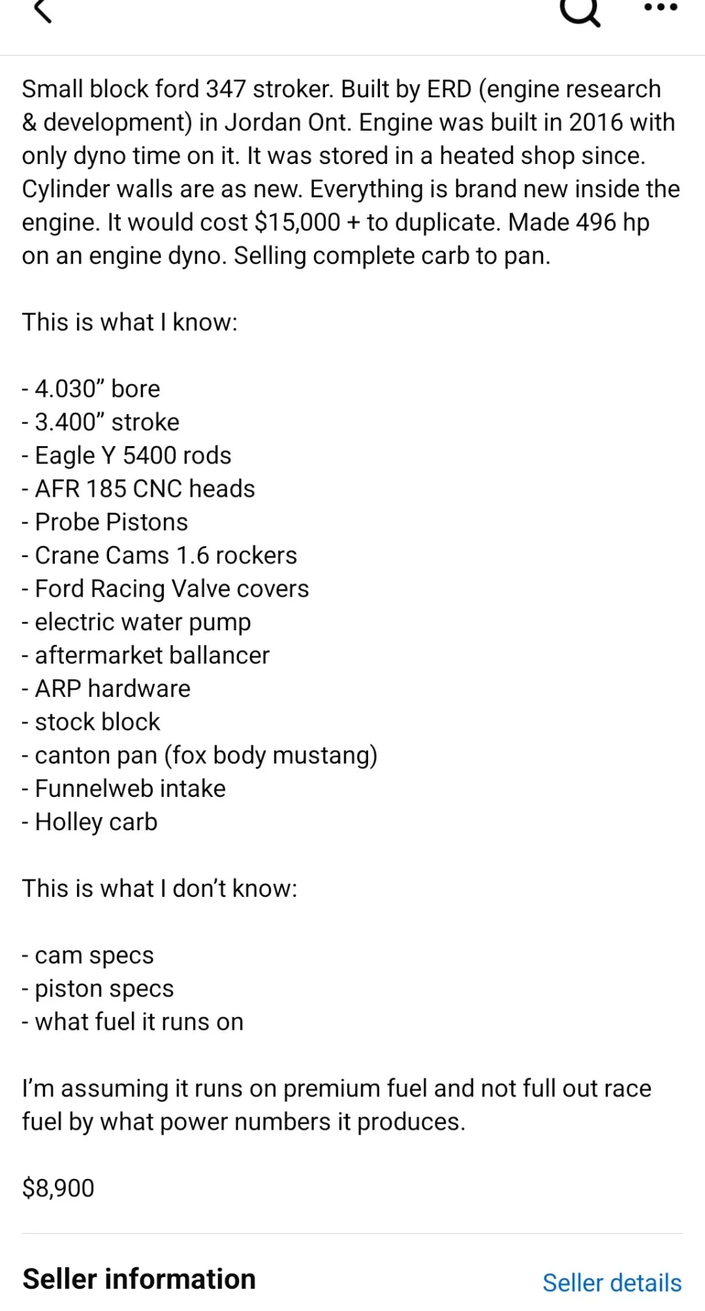

Can you detail your 347 build? Stock or CAI, throttle body, intakes, heads, cam, compression ratio, and what will your shift point be?
I limit myself to about 6200 on shifts but can spin it pretty tight with the hydraulic lifters and stock block (6600 to 6800) but on the dyno it all starts falling off around 6400. If I do anything else it will be a solid roller cam and aftermarket block so I can move the shift point up. Stock blocks don’t particularly like high rpm shifts while north of 500 fwhp. Will I ever do it? Probably not unless Blue Print starts selling the four bolt main block and it’s half of a Dart block. Anyhow, all of that and I’ll still keep the 2.5” exhaust.

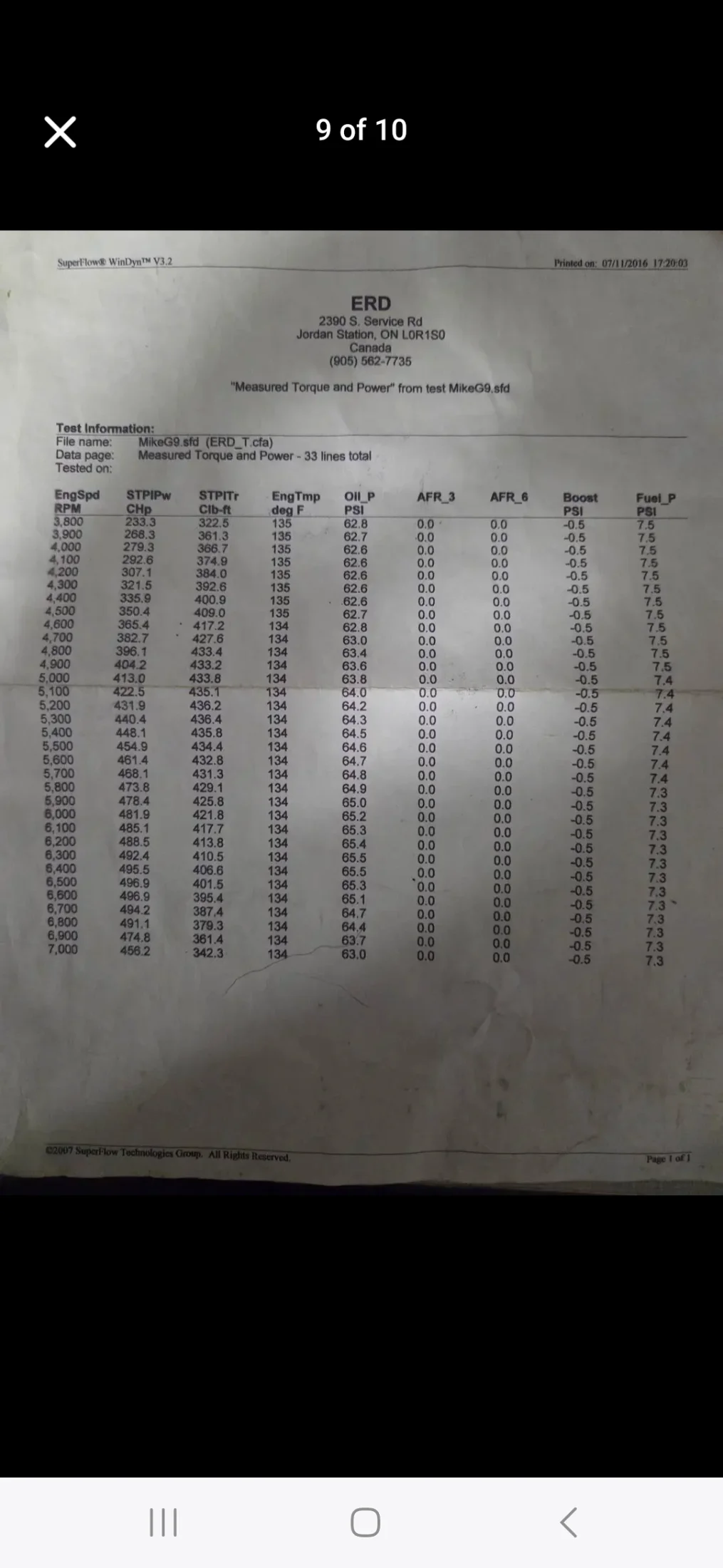

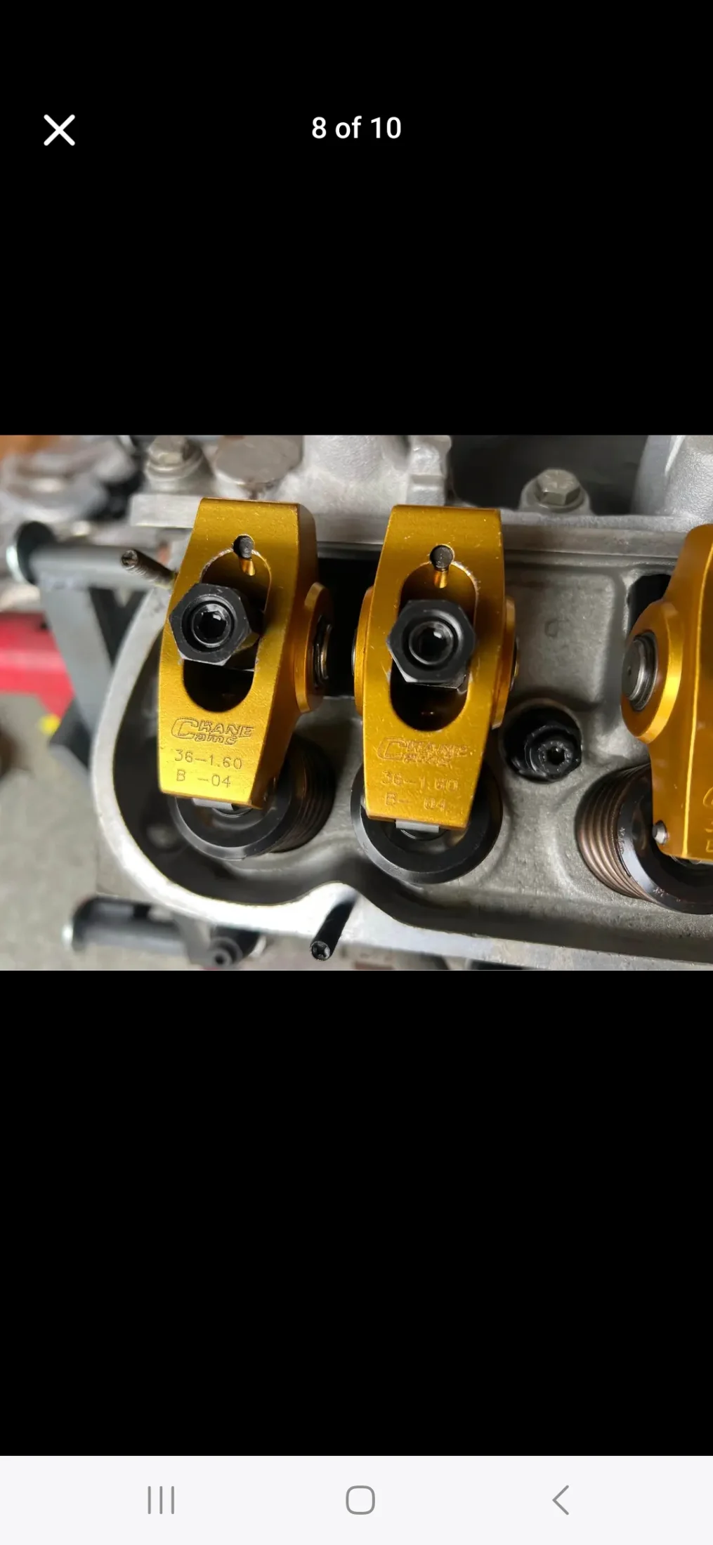

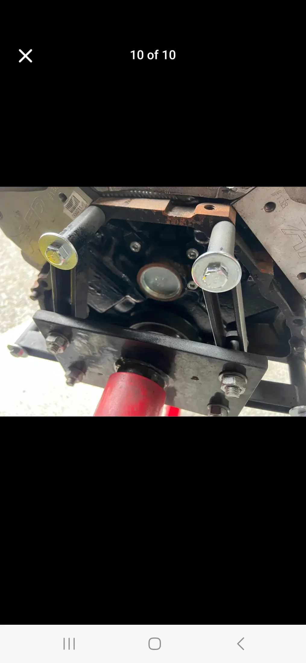

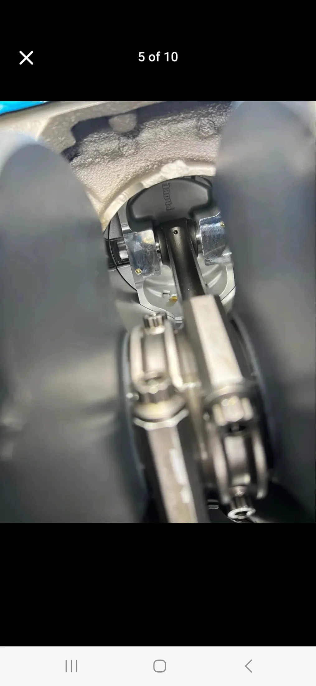

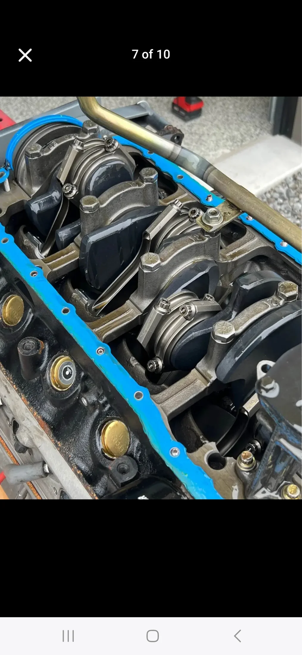

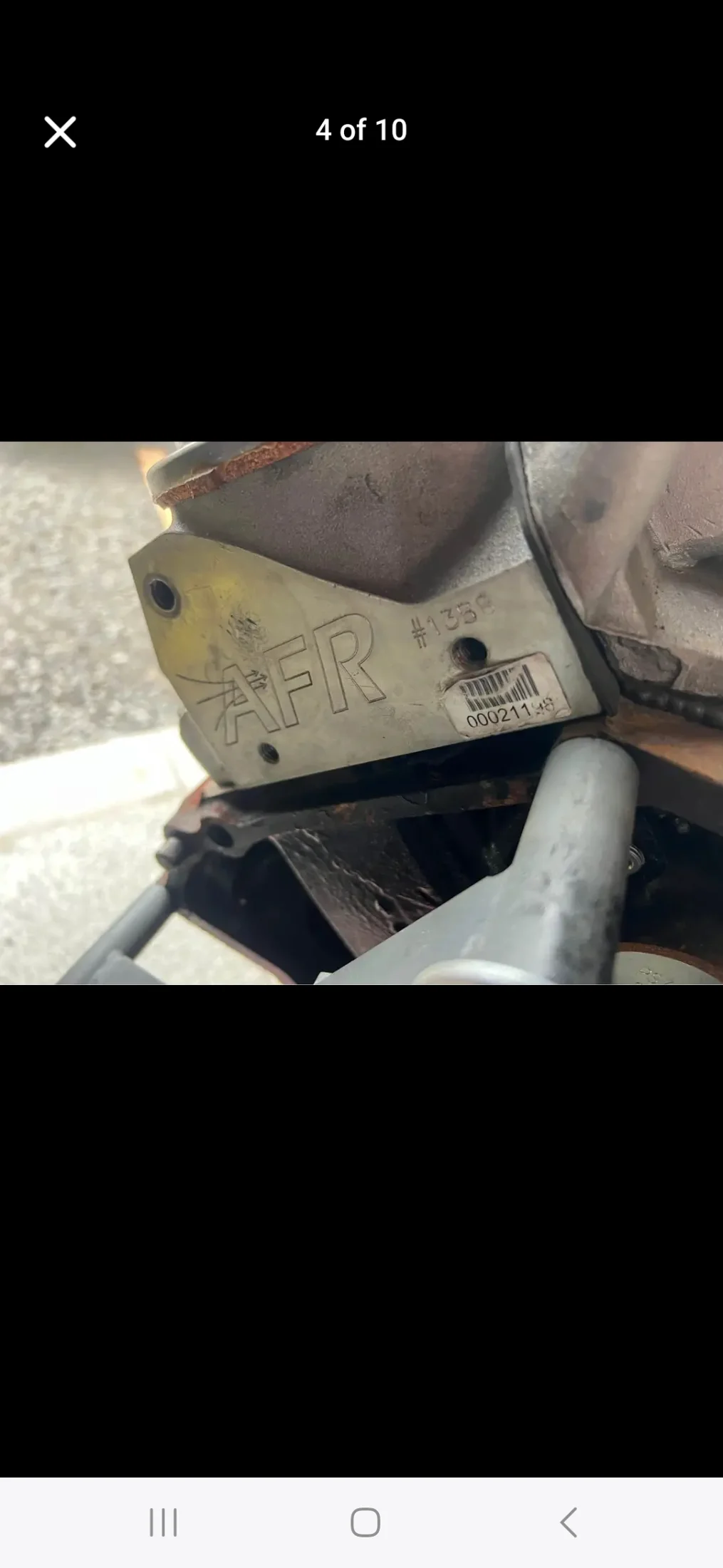

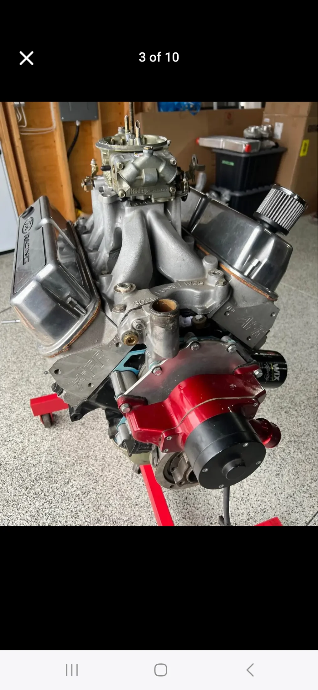

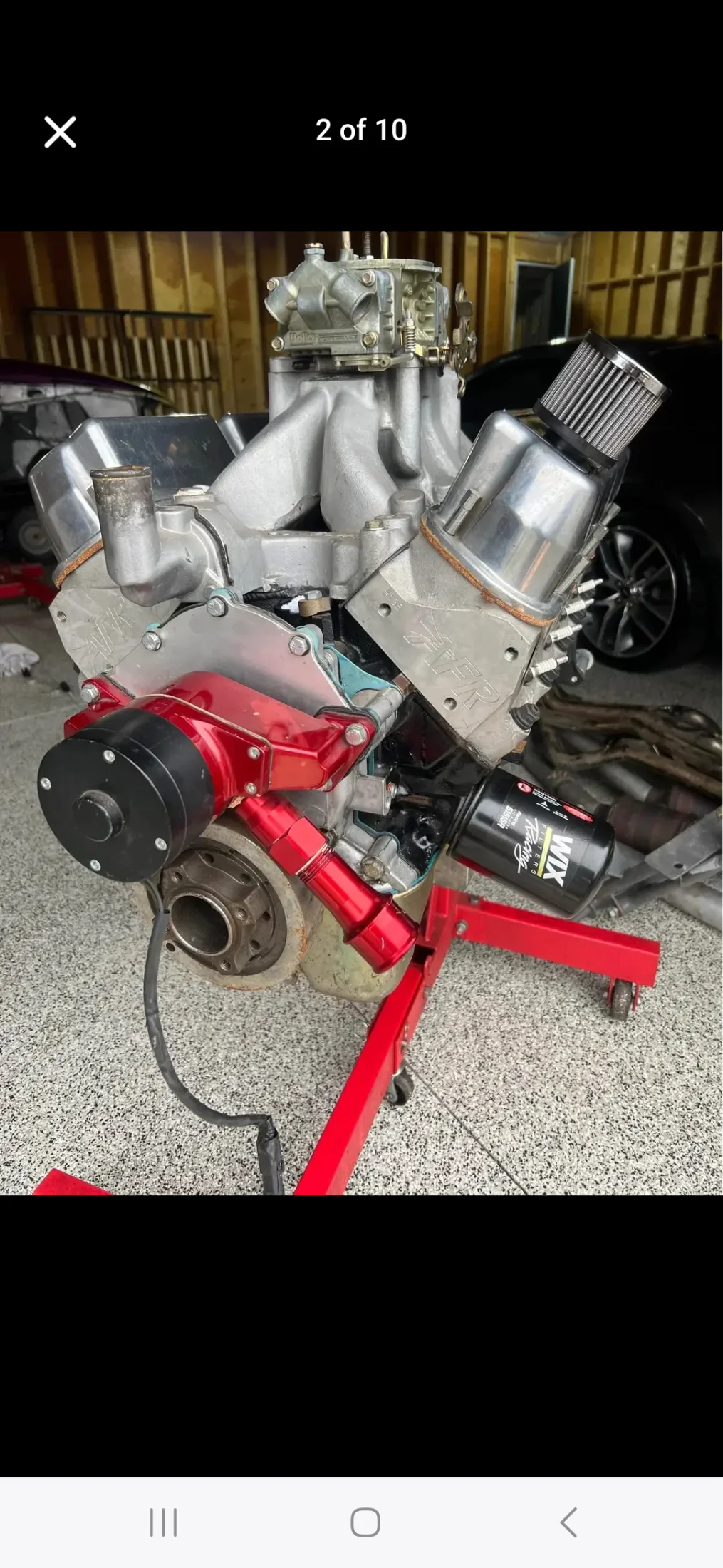

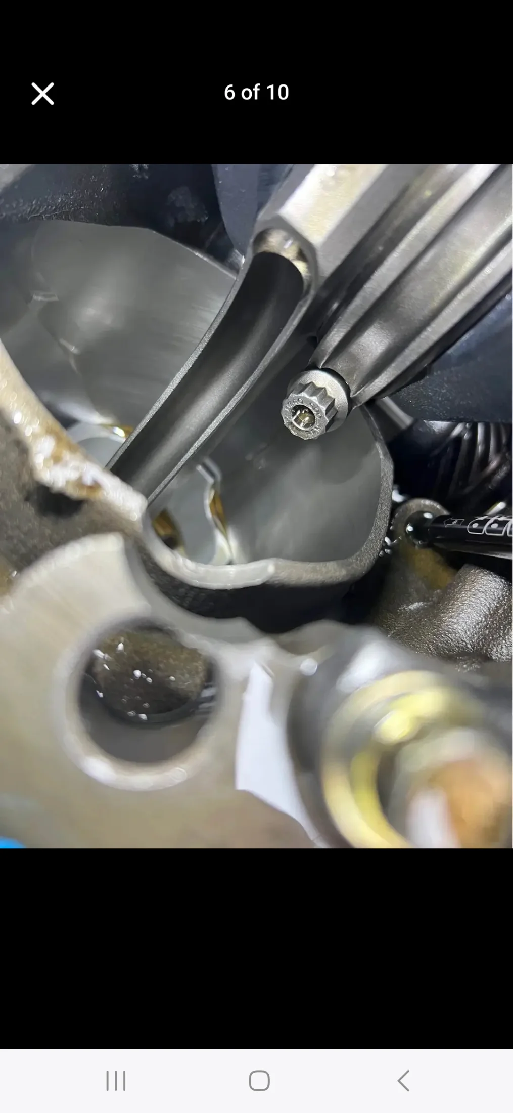

I bought this engine with the info you see in the below pictures. I purchased Holley Systemac intake and terminator ecu with 24 lbs injectors 65mm throttle body with anderson power pipe... my current set up has the mac long tubes 1 5/8 that i can reuse or figure out a new set up with my BBK 1 3/4 ....

In general -
350-450 HP is the tipping point where you should start thinking about 3" exhaust then stepping down as it exits. This is the point where 2.5" [begins] being a restriction (meaning backpressure starts to rise) but scavenging is about perfect. 3 inch all the way to the tips at this point, would have an overall negative effect on an N/A car (unless you're turning 6000+ RPM).
At 450+ HP I would start at 3 inch from the collector through the H/X pipe and then back down to 2.5" for the cat-back.
This will give the best exhaust scavenging for a street/strip car.
If you're planning for boost in the mix, then exhaust scavenging isn't as big of a deal.
Don't forget that the exhaust charge becomes more dense and takes up less space as it cools.
Looks like a pretty solid build, though the 15k estimate is probably off.
You can goto fordstrokers and build a 347 with a Dart block and come up a couple grand under.
Not sure what you plan to do with the car, mostly street? Mostly drag racing? Road course?
Be realistic, i used to think street track, except i never went to the track, lol.
I don't see many Pros in the 3 inch.
Probably be crazy loud without cats.
Probably be crazy expensive with the cats.
Could have rattling issues going over the axle. You certainly aren't using road race style parts and an off the shelf catback.
Gains at this HP level will probably be minimal since you already have 1 5/8 headers (lmr states 20hp over STOCK headers)
Let's say they do gain 10hp over what you have now which is likely 400-425rwhp, is 10 more hp really going make it much better?
BTW, a quick search (could be wrong, not foxbody specific), suggests the collector on BBK 1 3/4 long tubes is 2.5 anyway.
I'd run what you have now and if you want to mix and match exhaust parts later, go ahead.
What i wouldn't do is run 24's or a 65mm Throttle body, your setup most likely exceeds both.

I really don’t think you will need anything larger than the one you have for the 347. There are all kinds of cfm calculators out there and I have used a few of them and they pretty much all came up with the same cfm for a given motor size. So for a 347 at 6500 rpm and a VE of 0.85 you get 680 cfm. So with the 70mm BBK flowing 726 cfm so you should be good to go. Just make sure the upper intake throttle body opening is 70mm or larger.
Was looking at the dyno numbers and imade a little more hp and torque than my 331. Two things come to mind which are I’d bet money the pistons are flat tops so you are in that 10:1 to 11:1 compression ratio area so yes super unleaded fuel and the cam is pretty mild based on the dyno. You can figure the lift by using a dial indicator on the rocker.
