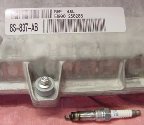

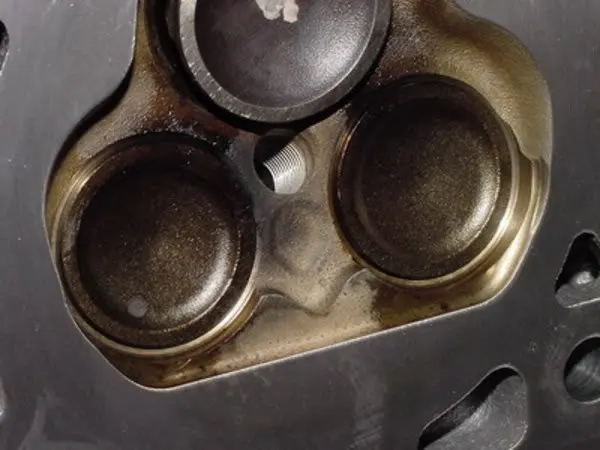

Guys, here's some pics I located on one of the other websites. They include the new 3v revised heads, along with the re-designed 3v spark plugs.
It appears the new plugs, are more of a conventional one piece design, in which the threads aren't located above the shield areas, unlike those cheap 2 piece design 3v plugs.
Anyway just thought I'd share them with anyone, who may be interested. :)
Obviously there was a reason behind Ford changing both the head, and spark plug design.
As for the reason, well it's due from the 2 piece designed spark plugs, in which the electrode shields were breaking in the heads, thanks to carbon build up seizing them all up.
In fact there's been quite a few complaints, where plugs were breaking with less than 25k miles. That being said, I'd recommend at least having your plugs taken out, and then put a light coating of nickel anti-seize on the electrode shields, before reinstalling them !
