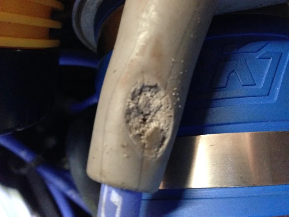

Thanks- I'll throw the old ones back in to start from square one. If noise still there, maybe I damaged on of the plug wire connections unknowingly. I did notice the rubber boot slightly burnt from the header, but it doesn't look like it went through the wire. See pic.

That's a pic of wire #3 BTW

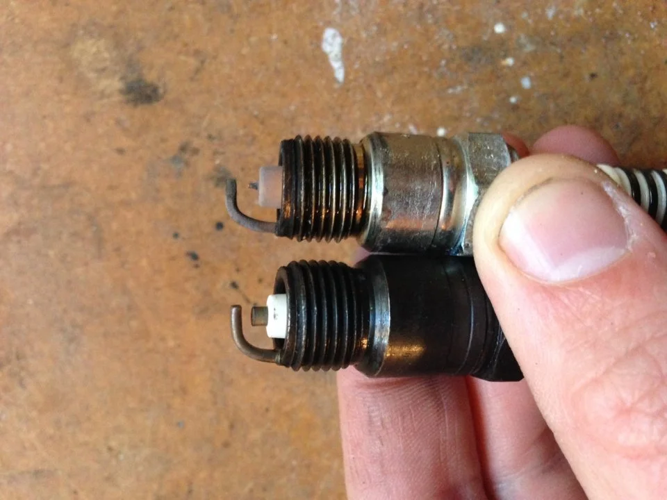

Here's a pic of the NGK vs. the Autolite. NGK slightly longer.

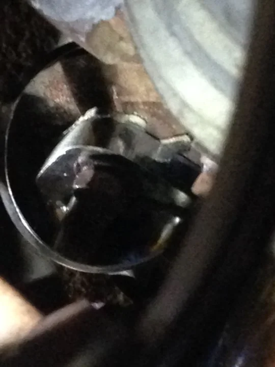

Thanks. So it dawned on me to use my mechanics stethoscope and see if I could pin point the noise area. I can definitely say when I put the scope right next to the header and the firewall, the noise is the loudest. I'm still going to replace the wires, but it sounds like the real issue is my header gasket. :poo: luck it literally happened first crank after I replaced my plugs. Been chasing ghosts for a week....
Last header bolt definitely looks rusty, not sure I'm up for this challenge. Might take it to my exhaust shop buddy.
Glad I could help with the gasket! I am thinking about what if it was an ignition wire spark leak and if the stethoscope conducted it to your ears. That would light up your life!
confirmed today with the help of a new mirror that my header is leaking from the gasket.
Fill fix this weekend then get back to checking my idle and code 41/91 problem. New wires will be here tomorrow too.
