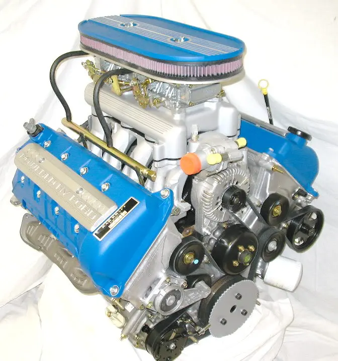

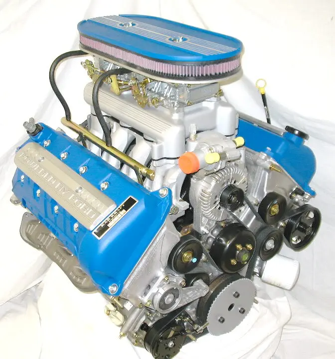

http://karkraft.com/engines.htm
this is the only carbed mod i've seen for sale recently. I have seen a lower intake that accepts carbs before in the mustang mags...It may have even been from Reicard Racing Intake. It is reichard that makes it http://www.reichardracing.com/46liter_intake.php
heres the KarKraft setup.

Reichard makes a 2V carb lower intake, i put a link to it in the above post, I just posted the 4V pics because that setup is just :drool:
