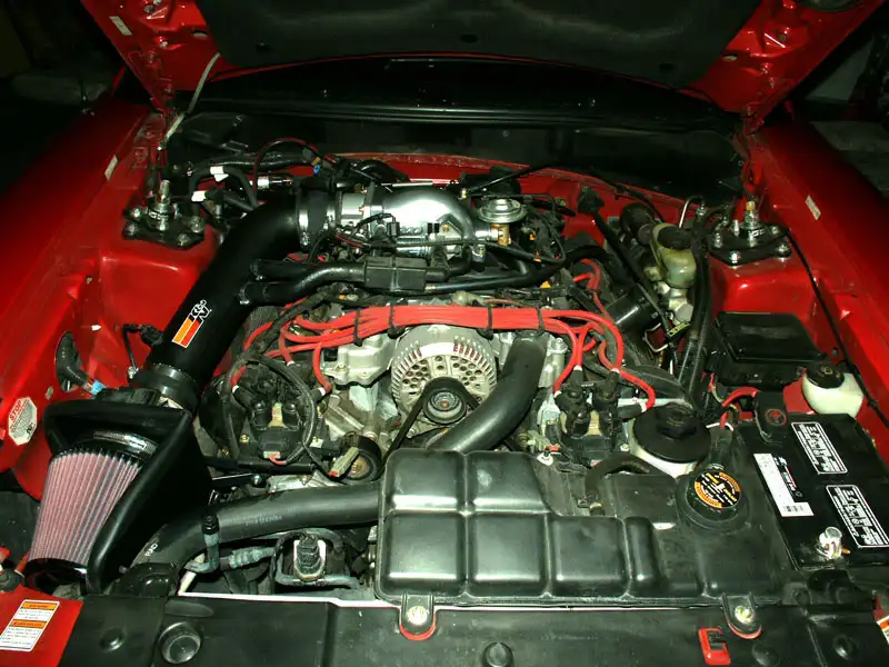

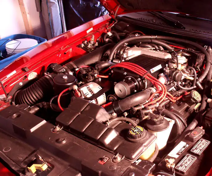

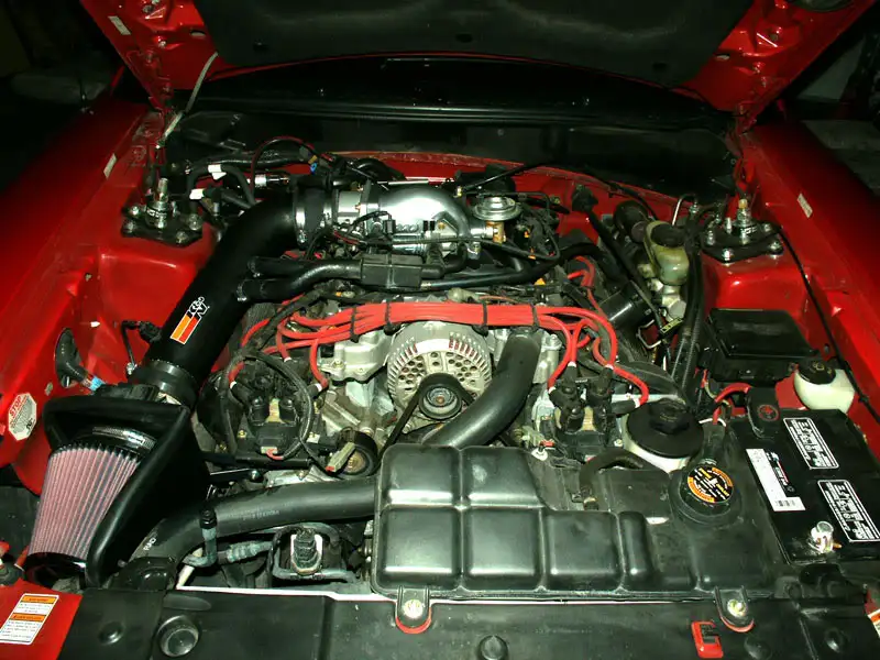

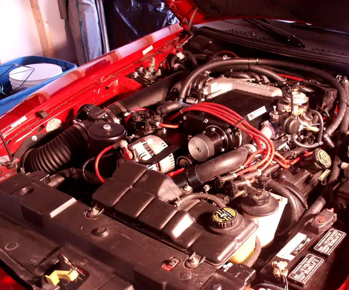

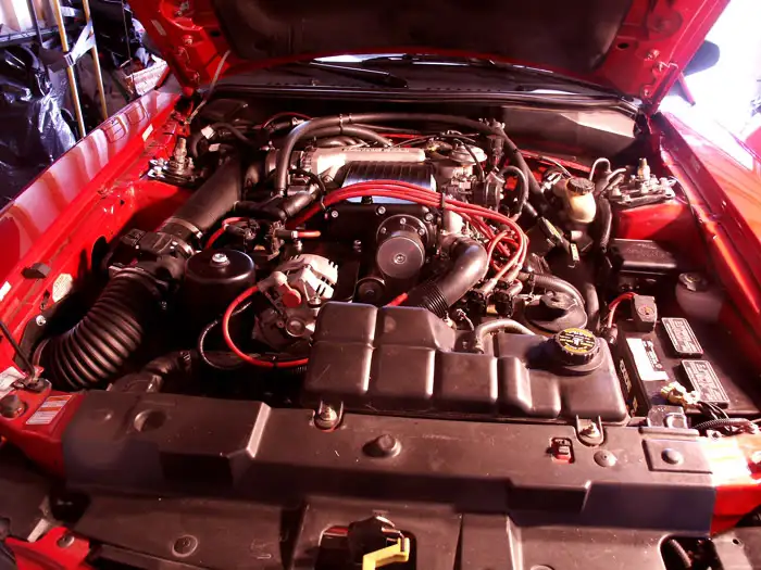

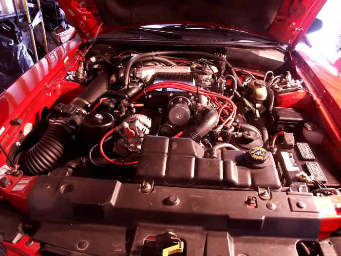

Never knew you couldn't put one by a certain other... I've always just laid them down in the looms where they are in a ascending order of length. They seem to route only one way. As far as touching they seem to no matter what where they cross over.
My MSDs with my supercharger...
My FRPP on my NA...
As far as changing plugs... no need to remove anything except whatever is covering the last plug on the driver's side. A good swivel head attachment, socket with duct tape on your socket to extension will help tremendously.
