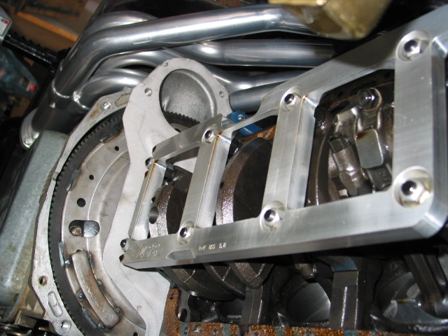

You beat me to it! I was going to mention that a quality girdle with quality connectors is stronger than a 4-bolt cap (but a 4-bolt cap with a girdle would be strongest of all of course).
Here's a shot of my DSS Girdle:
I chose not to run a girdle for the fact that they don't save the motor. The intake manifold holds the two pieces together and that is what saves the rotating assembly. Of all the block failures I've read about, none lost the rotating assembly. Girdles help cap walk, but not block cracking. Why would you put a part on a motor for when it breaks? Why use anything other than stock parts if the block will break first? Forged crank and h-beams in a roller block = waste of money, with or w/o a girdle IMO.
Ahh I thought girdles were originally designed to stop the caps walking and thus burning up the bearings and journals. Surely if your engine is going to produce enough power to split the block it is going to bounce the caps first?
main cap girdles doo add strength to the bottom end, and do allow you to make more power before the block splits apart. they are in fact a better investment than 4 bolt main caps. the reason the girdles work is because they tie the bottom end together and change the path in which stress flows through the block.
Nobody said they did save the engine or kept anything from cracking. I said there was a better chance of saving the rotating assembly with one. The block will still split, but you have alot more than the oil pan and intake to hold it all together. Also, if you overpowered 130lbs of iron, would you rely on a chunk of cast aluminum and a piece of stamped sheetmetal to take over? I'm not saying you're wrong for not using one, just that a girdle is an extra layer of potential protection for a block that is likely inadequate for many intentions.
