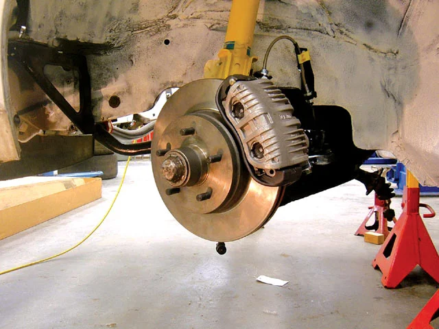

The reason I wanted to know about the limitations of the 4 lug were more for brake options then wheel selection. I found a set of 4 lugs that i like but didn't want to buy them and down the road to have a good braking system HAVE to swap to 5 lug. Why by rims twice?
Once again thanks for all the help
Baer does make 4-lug kits.
They have a 12" and 13" front setup as well as a 12" rear sport setup.
The 13" front and 12" rear kits are C4 brakes basically.
The 12" front is similar to the very rare 1LE Camaro brakes
Both front calipers are very similar to the PBR's used on Cobras.
Imagine that, in 4-lug, in a 12" and 13" option and that' the baer kit
BTW, that's also the same caliper used on the '93 Cobra R. Those PBR's were passed around a lot.
