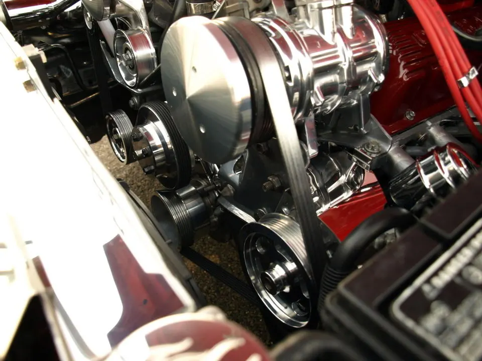

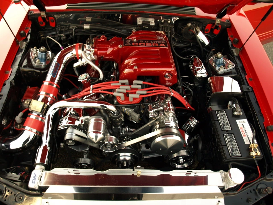

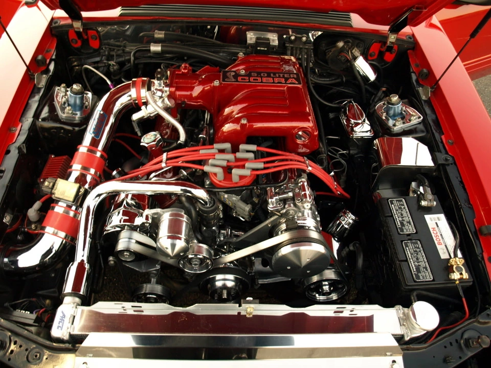

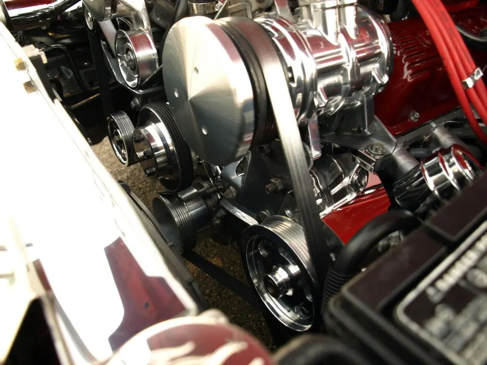

hey rick! couple small cosmetic changes in engine bay since you have seen car last..........13k on motor still running great!
picture.php
