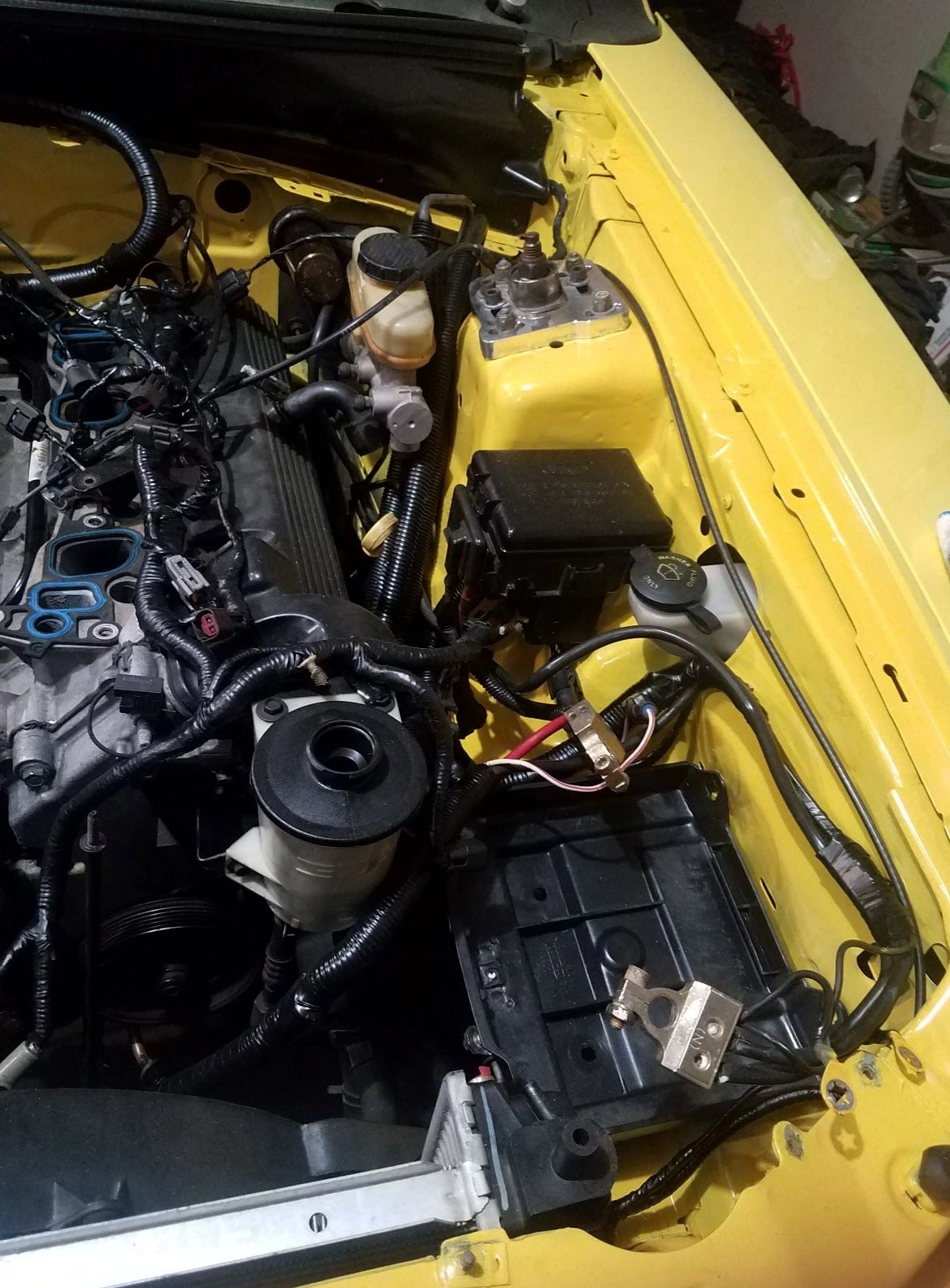

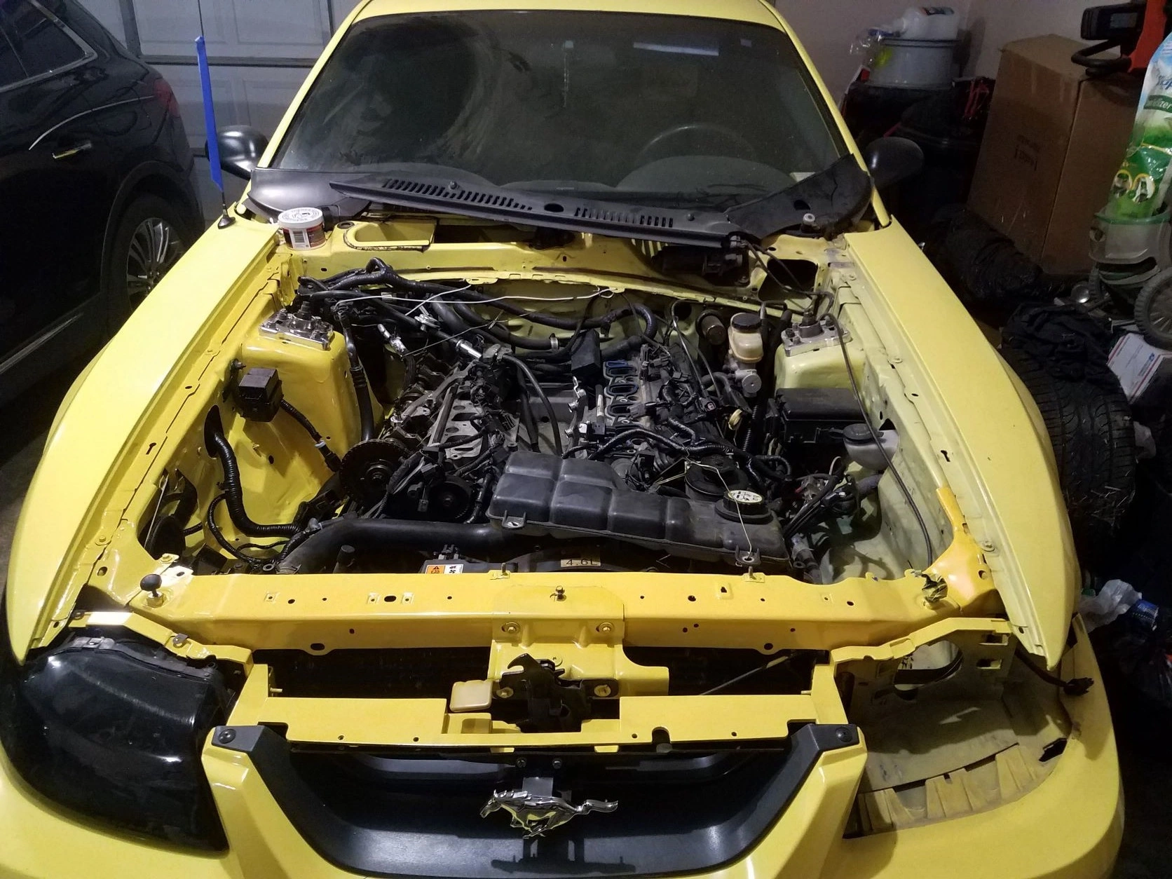

Here are some pics of where I am at: Goal is to have all new parts and running by next July in time for Car Shows and Dyno Numbers..
Here is the snapshot of my engine bay and passenger side firewall..... cleaned entire engine bay/degreased, re-wrapped all wire looms and detailed all parts/polished... I am adding in a lot of engine bling and aluminum parts so this is just the base...
Ed

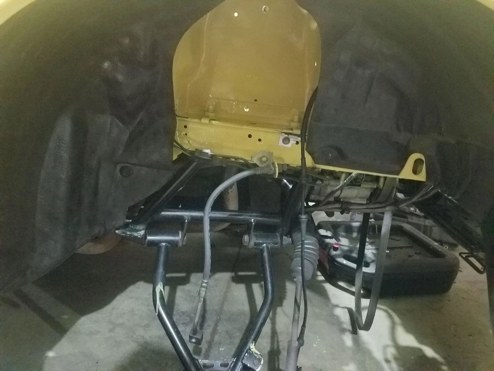

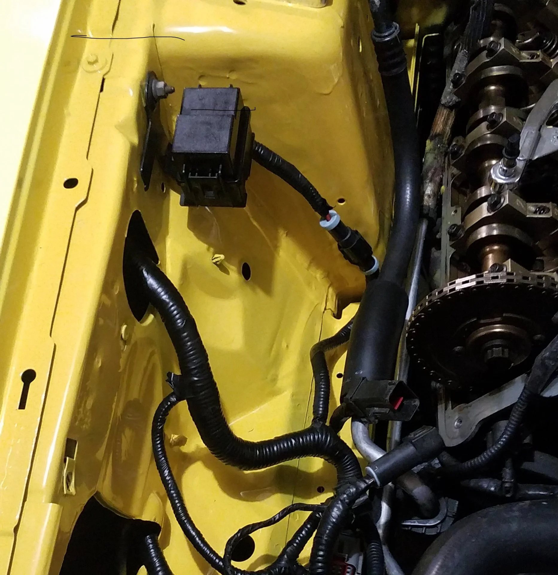

PS outside Fender Well - Pull everything out, painted and cleaned...... What you see here is a PA Racing aluminum K-member with Control Arms....I have Strange 10-way Adjustable Struts, and getting new Cobra Calipers (Painted Red) and getting my Rotors turned currently....still getting some little parts for upgrades like bigger braided brake lines and I painted the little pieces Metallic metal which looks amazing ..... I will send a Pic of the finished product once everything is all together...

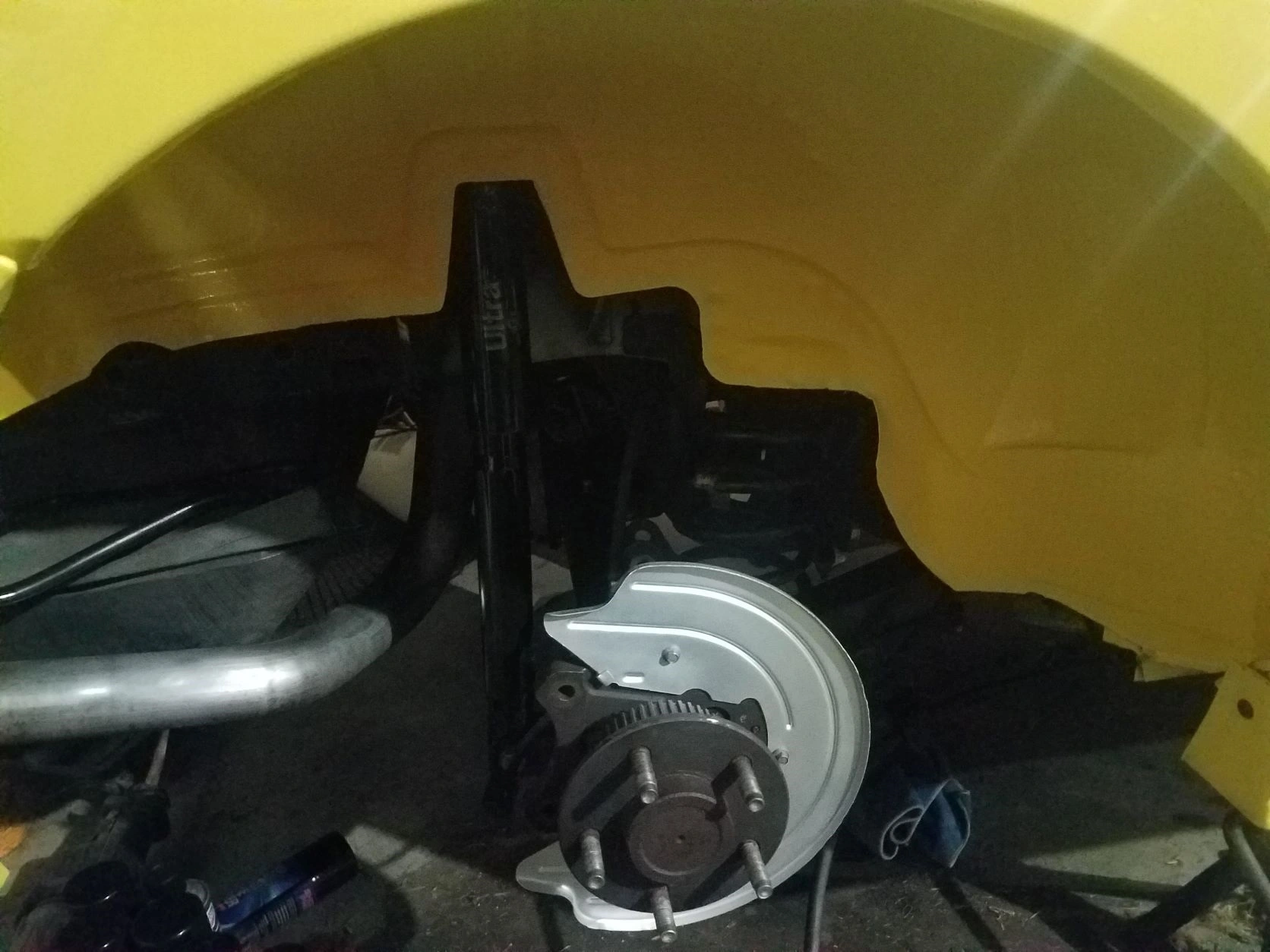

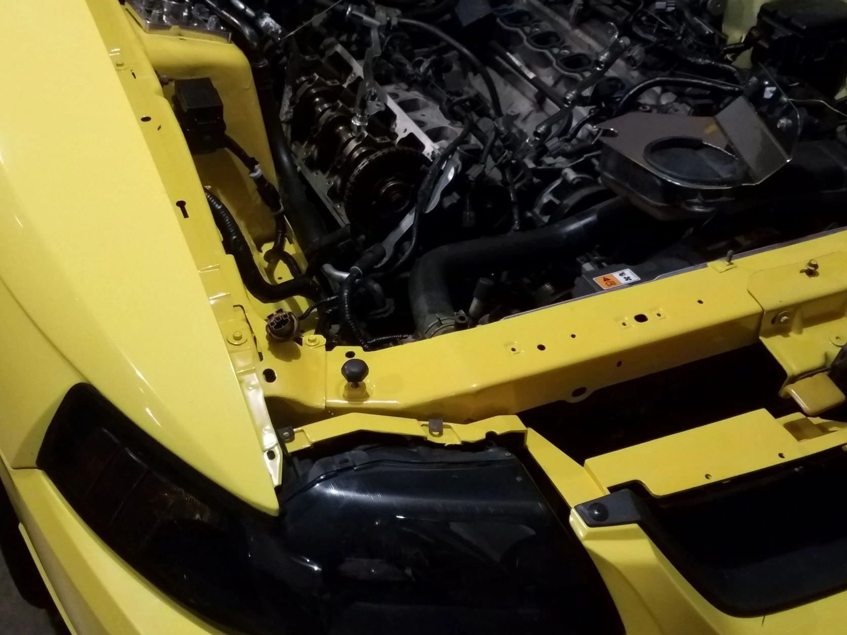

PS Rear outer Fender Well.....scubbed/degreased, and Painted...Here is you see the metallic paint I used....waiting on new GT Rear Calipers (Painted Red) and new braided Brake Lines ..... Rotors are getting turned....lots of little details I am focusing on.... getting new Rims 17x10s for the back to match the front which are black FR500 Wheels with the chrome lips...

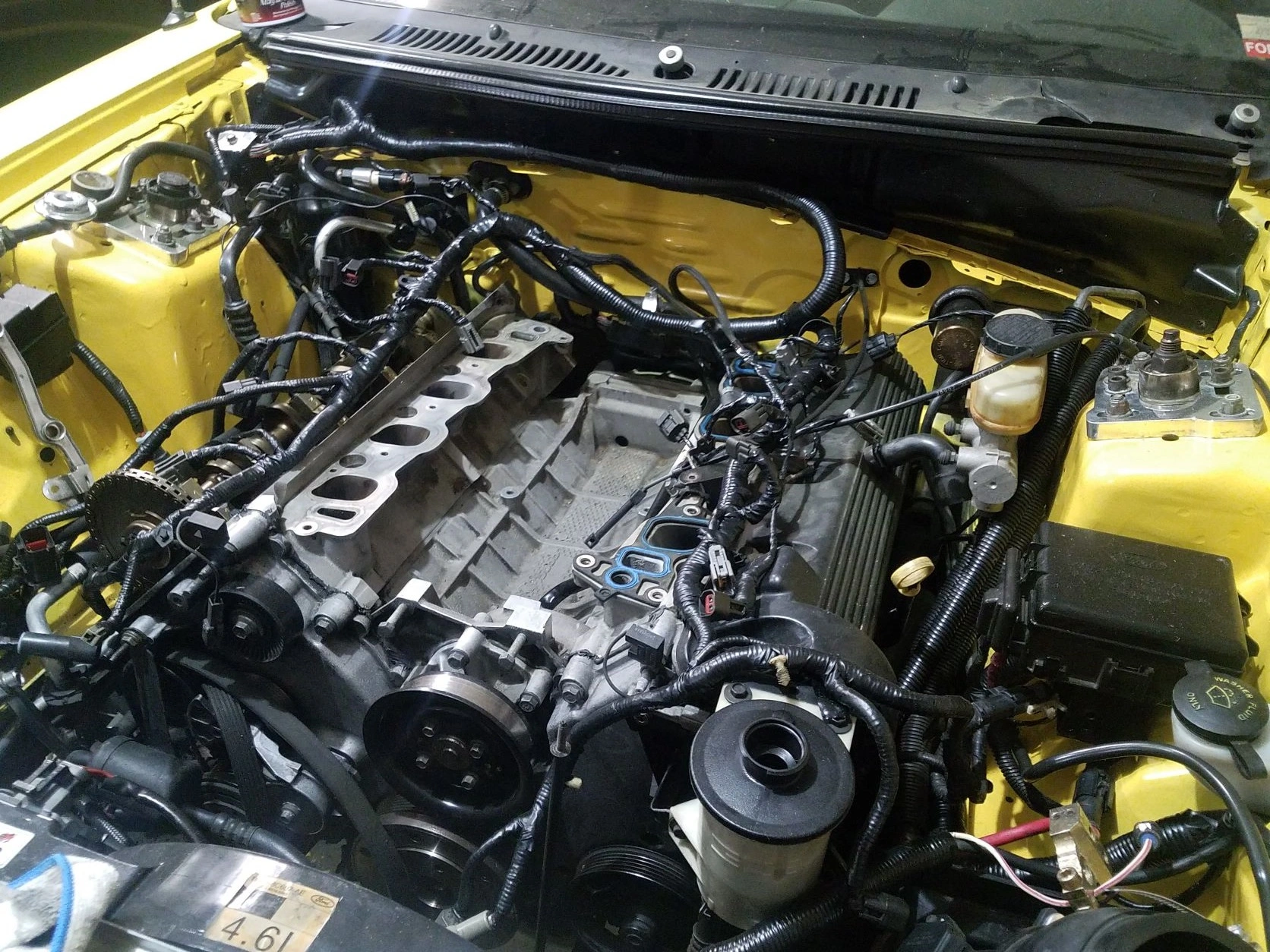

Back Firewall painted, cleaned engine, and Wire loom completed.....
The engine is currently a 01 Corbra Teskid block, forged with manley rods/pistons.... I lowed the CR from 11.2 ish to 9.4 to 1 as back in 2011 I was looking to put a turbo or supercharger on the car ..... I had nitrous on it for a few months back in 2009 and ran low 10's with a 150 shot on the 11.2 to 1 set up..... not really interested in super high HP but just want to put every ounce of power Naturally Aspirated down with the new set up..... still sourcing the Ford Racing Boss Modular Block and will run lightweight internals with a 93 Octane friendly 11.7 to 1 and 5.3L build or 323 cubic inches... Cam Profile I am still working on and will discuss more for all the dyno numbers I had and compared with multiple intake set ups...

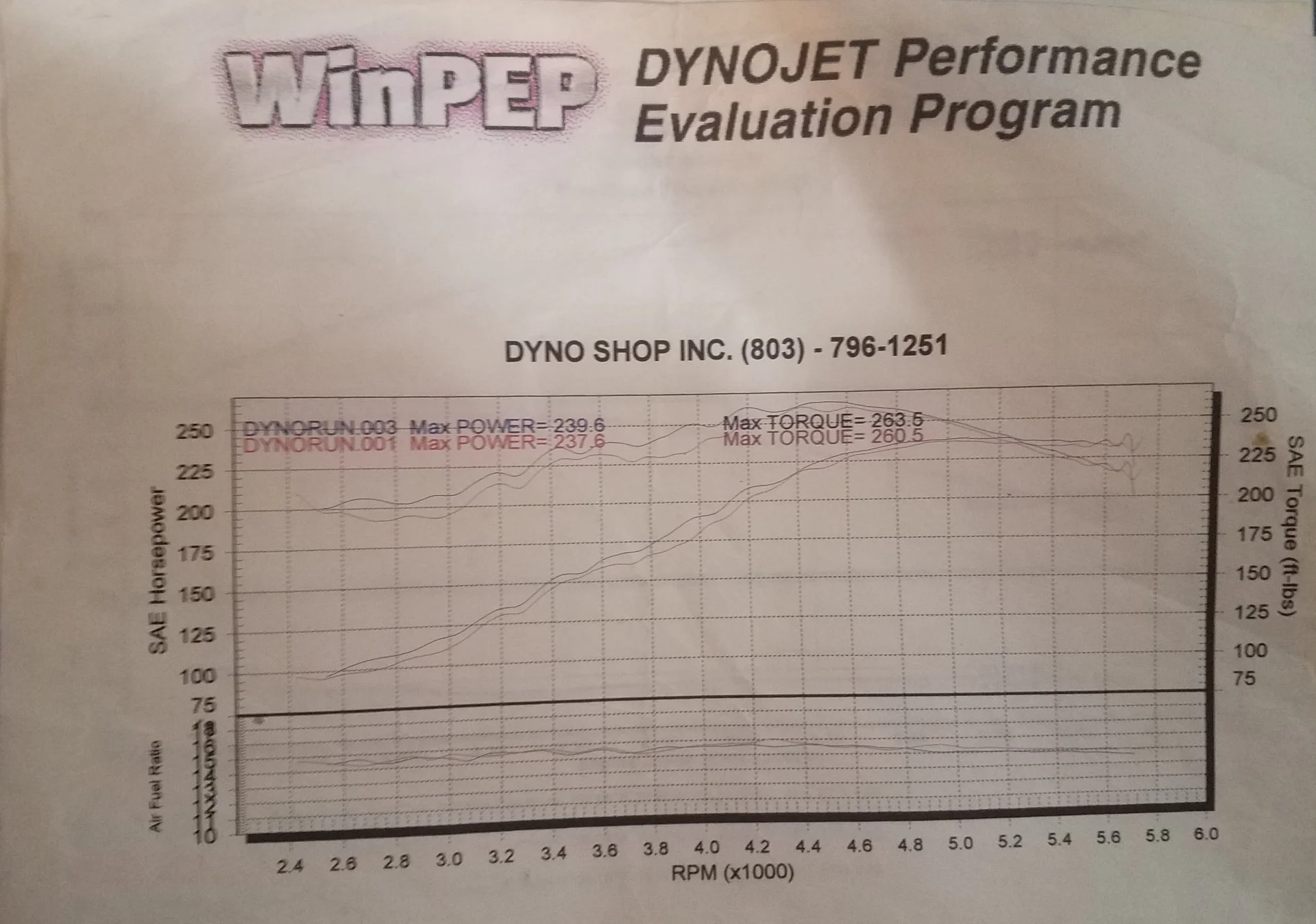

So here is one of the 1st Dyno Sheets...around 2004ish....this was with full bolt ons for - Catback (H-Pipe), BBK Under Drive Pulleys, Accufab TB with BBK 70mm TB, BBK Intake, 373 gears, Stock Heads and cams, and a Diablo tuner with a can tune.... I also had an A/F Adjuster that attached near the MAF that I could adjust.....I did a couple of tuning sessions on my own based on feel and driveability but could always tell it was running rich...

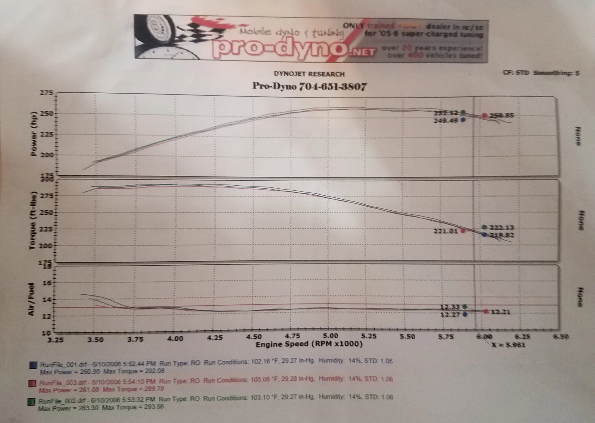

I moved to Columbia SC in early 2005 and had Pro-Dyno give my car a custom tune....based on the previous results you can see a can tune with roughly full bolt ons and trying to tune the car myself there is was a lot on the plate..... you just can't adjusted the timing and fuel curves throughout the entire RPM range without a custom tune....It gained peak power of 25hp and peak tq of 40....but the mid and top end still held a lot more power across the power band throughout top end.....car went from running 14.1s to 13.3s just from the tune alone with all the bolt ons....

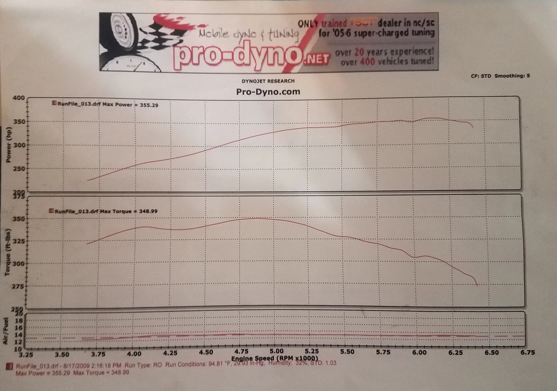

In 2009 when I returned from 15months in Iraq I got the TFS 44cc heads and mounted those up......now the car really woke up.... I went from 12.20s to 11.65 at 116.63 mph....there was a few intake changes and bigger MAF but the car was a blast to drive.... this wasn't my best pull but average HP and TQ with a full both on 11.1cr with TFS Heads and good cams seems to be the sweet spot on 281 Cubic inches....Put down 355hp and 349tq....but the Peaks were not the impressive parts...compared to stock cams/head and ported head and cams there were 60-90tq gains and 40-60hp gains at various RPM levels throughout the power band.... Peak numbers are impressive but the feel and powerband throughout was over the top...
