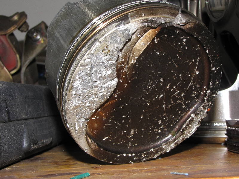

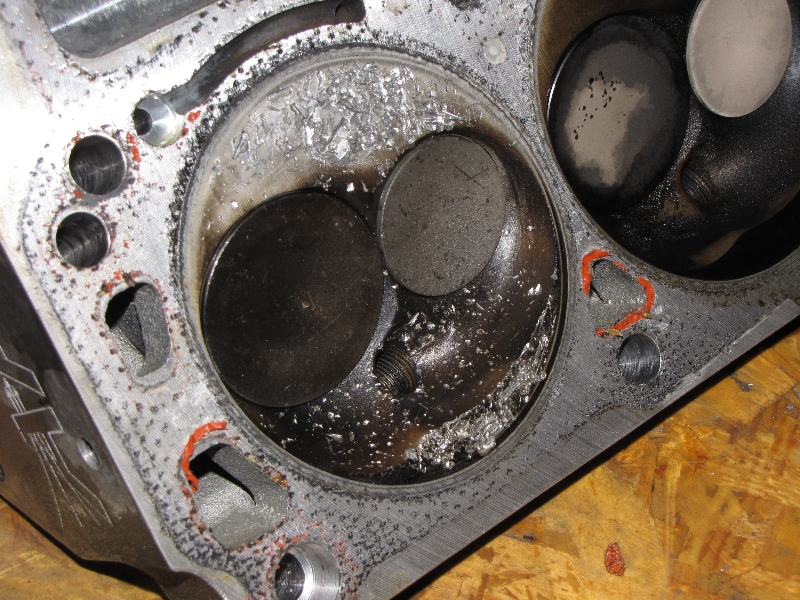

In case you missed it, I killed the #8 piston last fall at the drag strip. Here's the destruction pics...
After some researching on the net, I think the problem was that I didn't get enough clearance on the file fit rings. It seems like the #8 cylinder runs hotter than the rest and the rings expanded too much and didn't have anywhere to go but up when the ends met. I also may have damaged the piston from running lean.

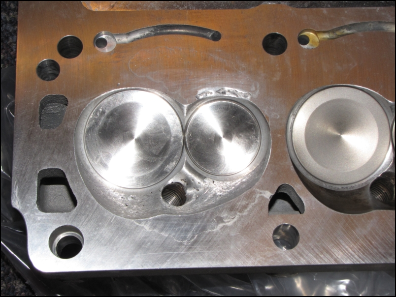

I sent the heads to Fox Lake for repair. They fixed the damage, replaced two valves, cut all the valve seats, clean and grind the valves, and installed all new valve seals. Here's the finished product.

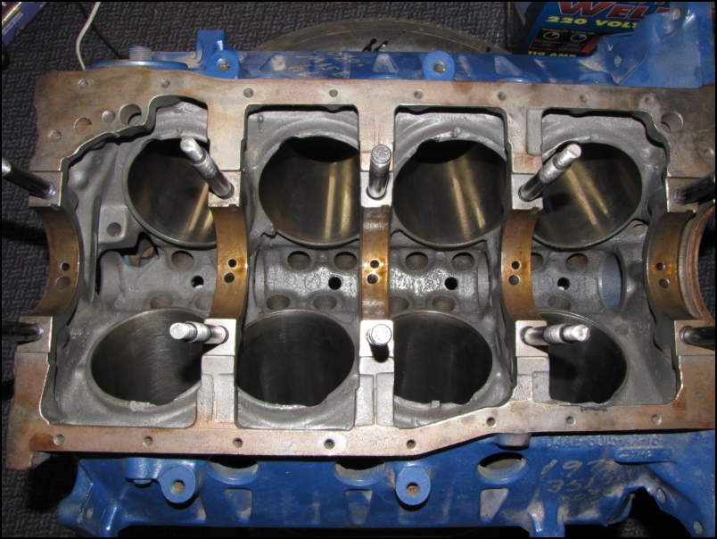

I picked up a '74 351w block locally. Clearanced it for the stroker crank dropped it off to the machine shop. I read that it should have at least .060 clearance between the rod bolts and the block, and the closest I measured after I was finished was a little over .070.
I was told the block was .030 over, but the machine informed me that it's .040 over. Of course they didn't tell me that until they were checking piston clearances with my .030 over pistons. :( So instead of 418ci I have 420ci.

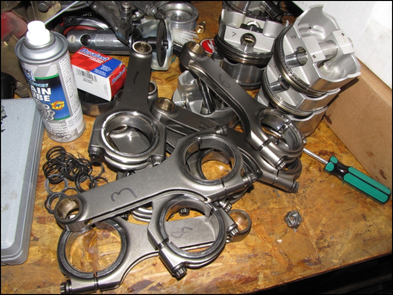

I went with Ross Racing -31.20cc forged pistons for 9.5:1 compression. I had 10.5:1 previously so I'll probably lose a little power, but I can make up for that with a turbo next year. :)

Old pistons removed from the rods

I really don't like the look of that head....even after the repair. Seems to me like they should have spend a little more time on that section above the exhaust valve...especially knowing that you're going to be running any sort of forced induction with the engine? :shrug:
Yea Brian i noticed that too. I thought they coulda been filled in a bit more. I had a similar repair done by Brian at ADPerformance....it looked spectacular. If i didnt tell u what happened u wouldnt have guessed.
