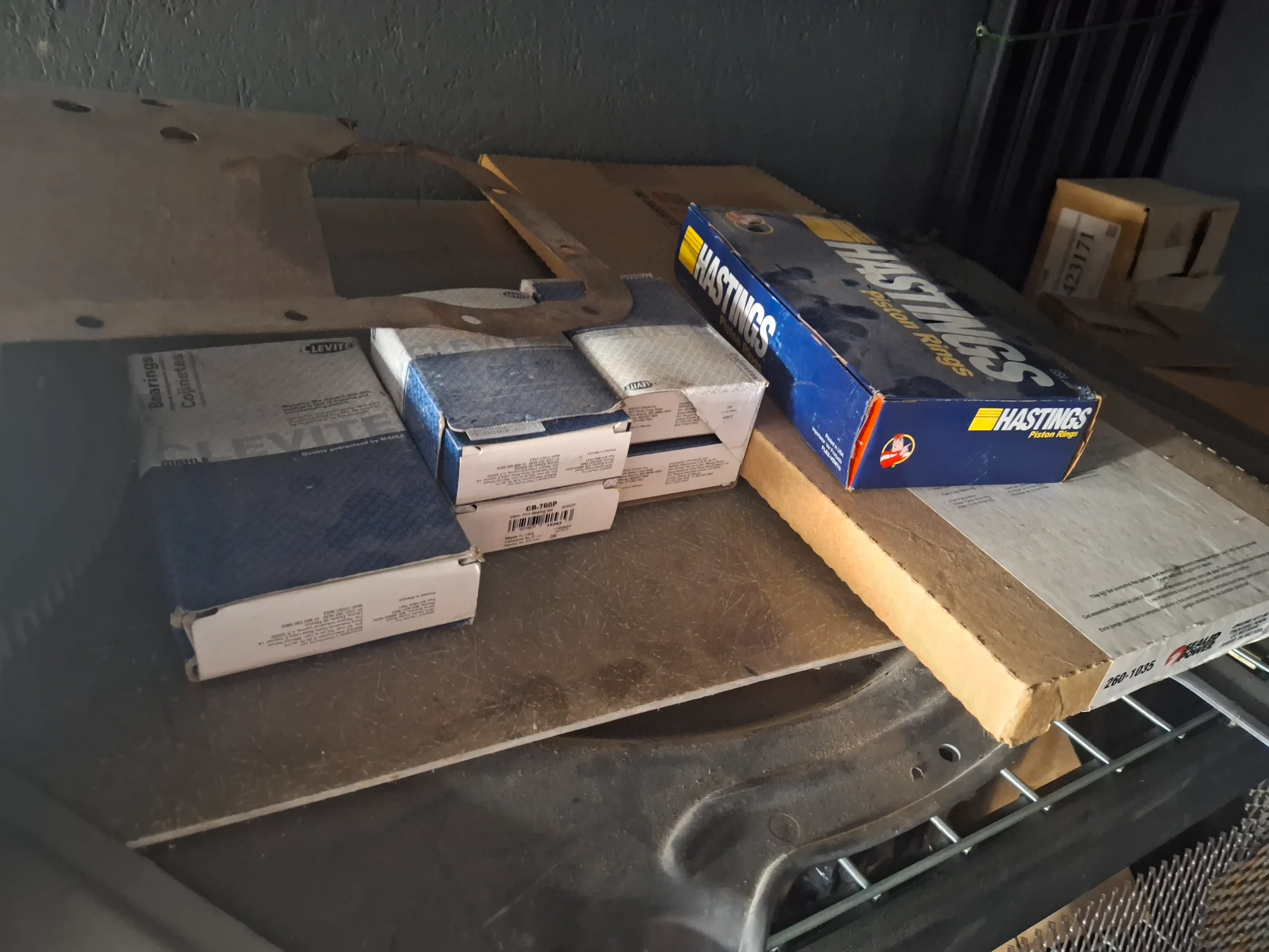

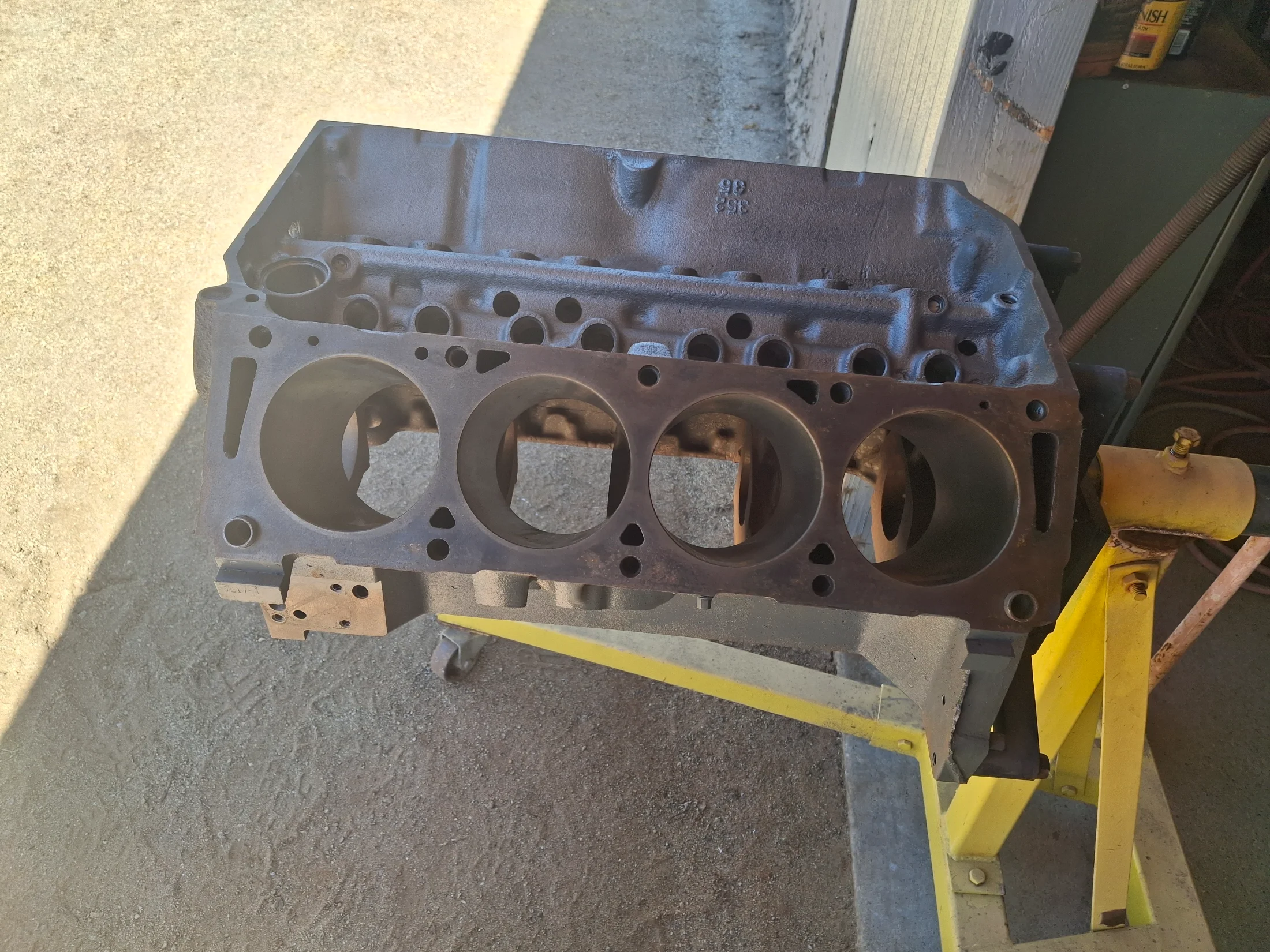

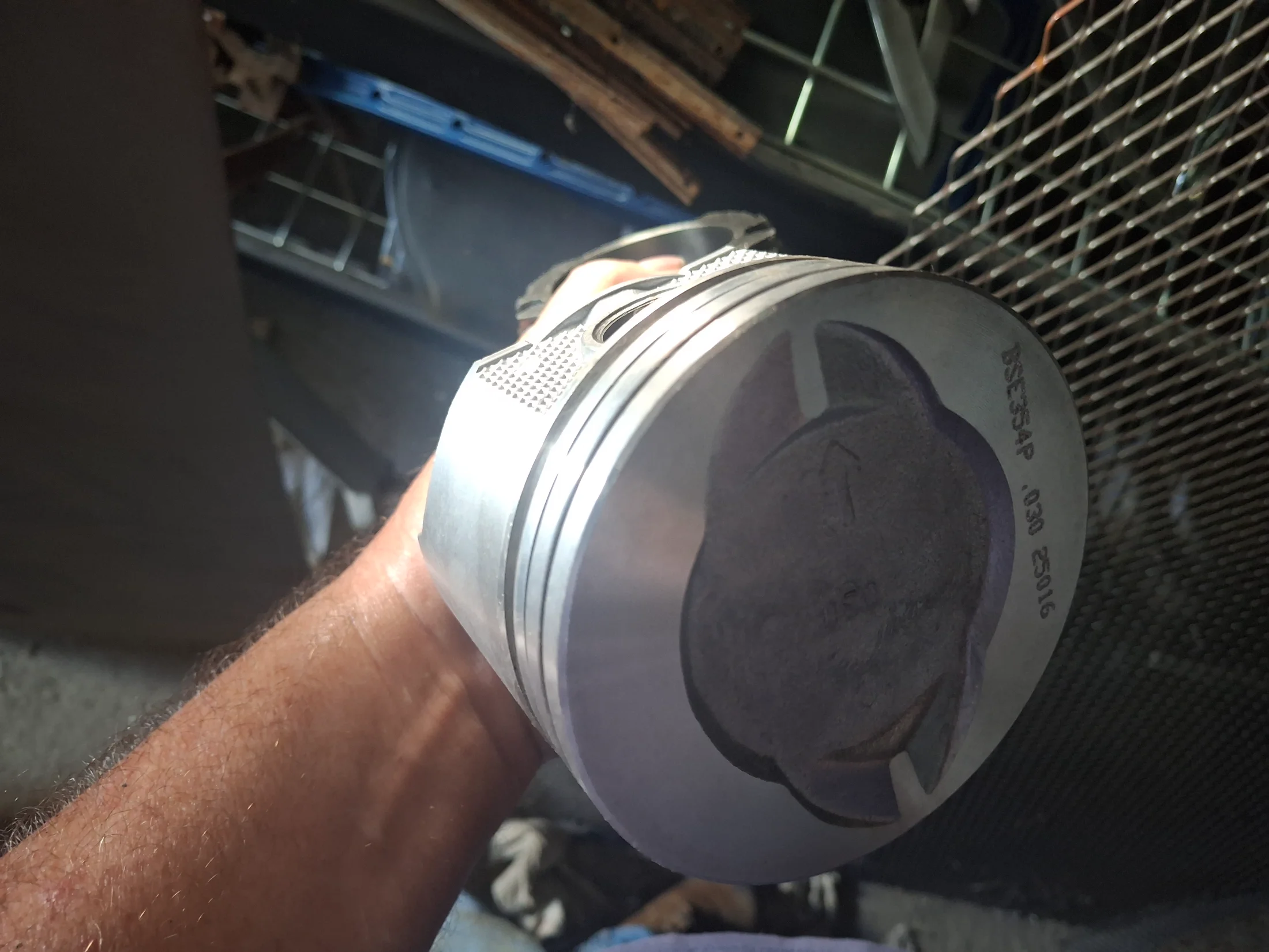

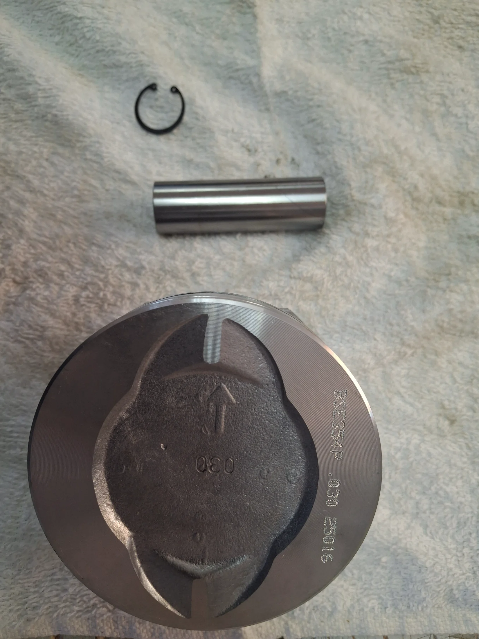

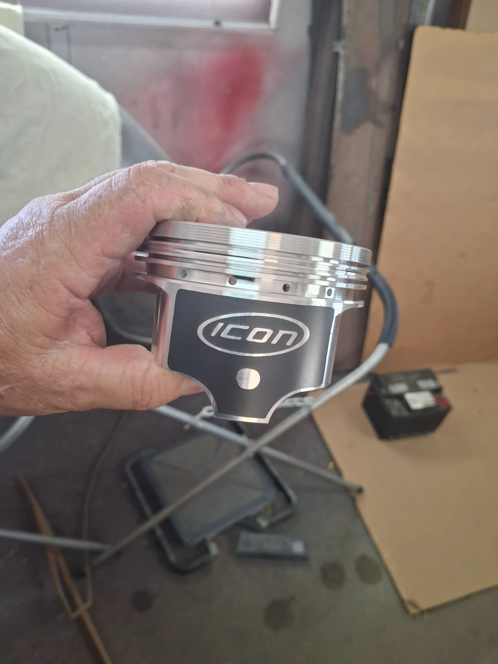

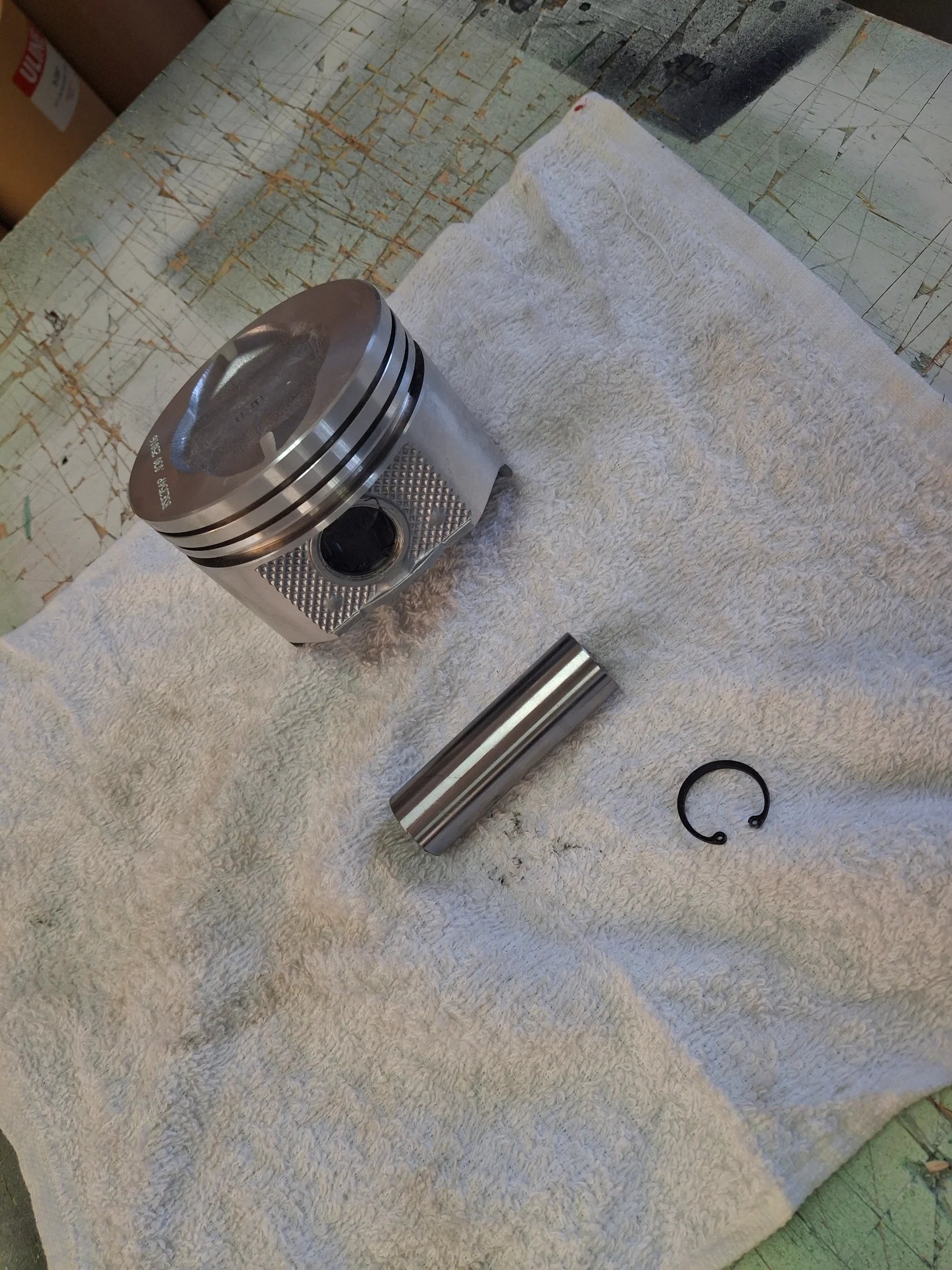

I bought this 428 about 6 years ago already machined , .30 over bore ,new pistons but they are cast and i will be ordering forged in the next couple of days

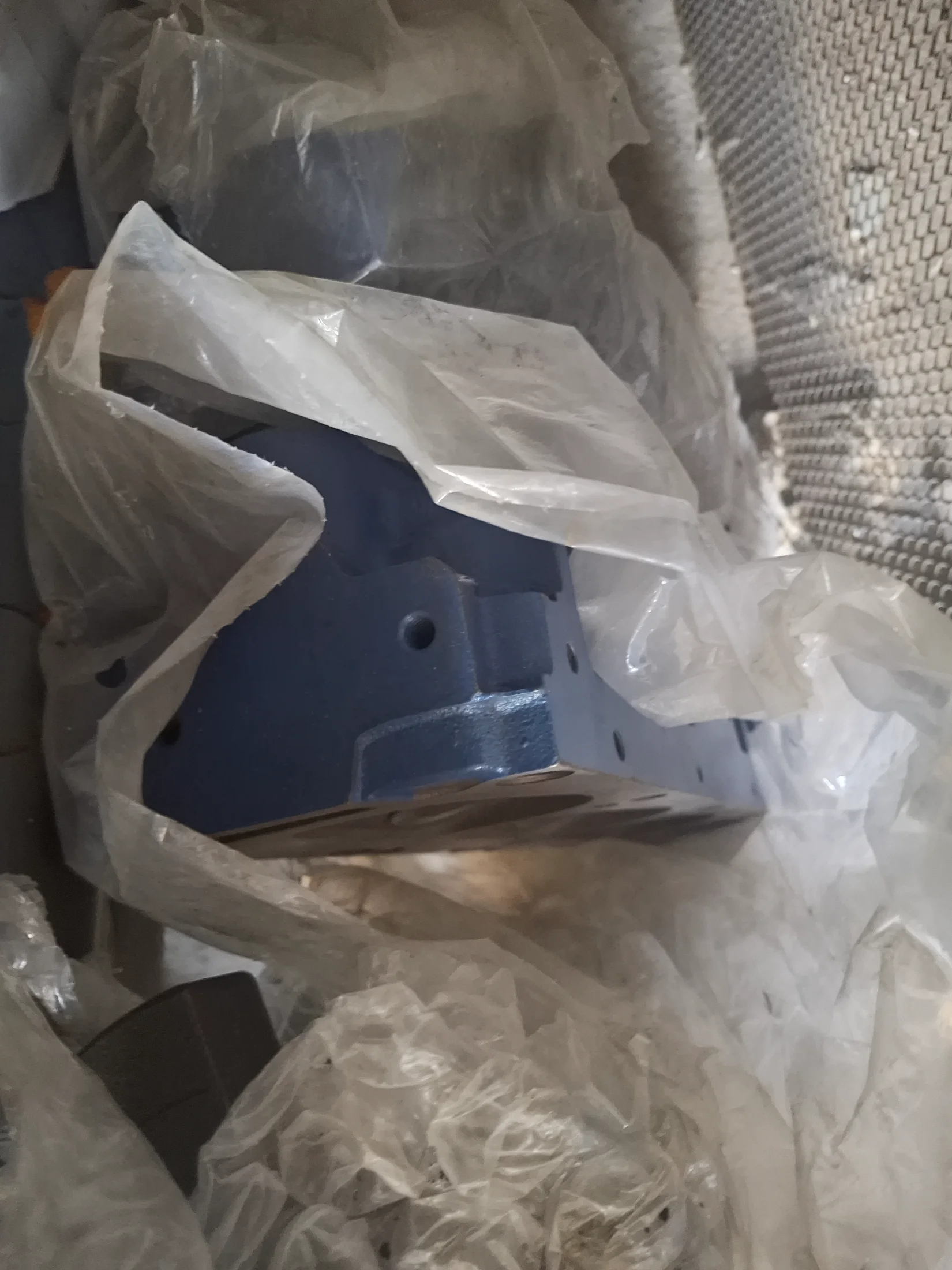

Crank has been turned .10 under . A new full set of 77 clevite bearings ,30 over rings fresh machined 428 CJ heads ,new valves and guides . And a full gasket set . I got the whole bundle for the whopping price of ...$1,200. Dollars!

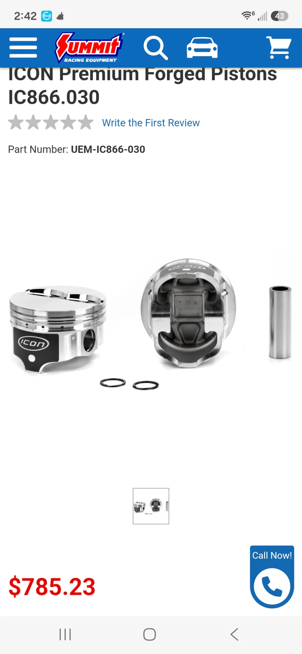

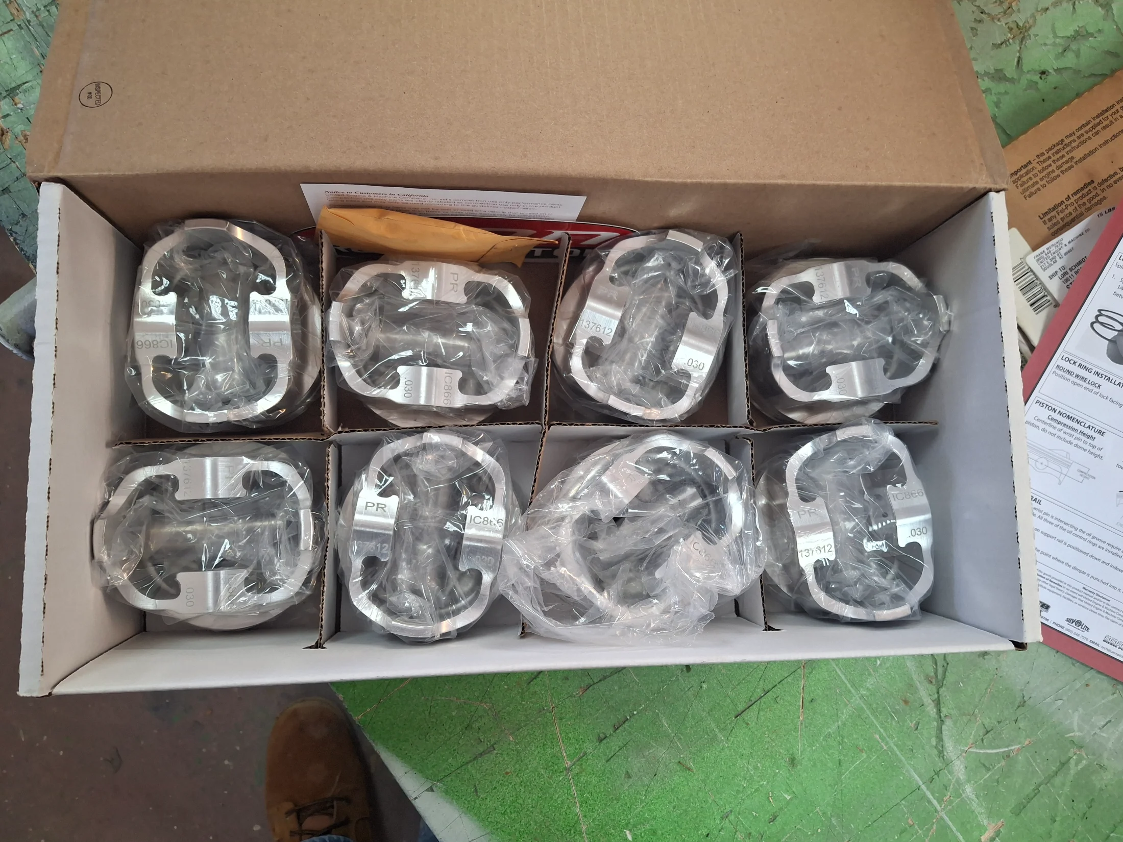

Now the new pistons are going to cost a good $800. And I need a melling oil pump and a comp cams 280 H ..love that cam!
The block will need cleaning ,a bit of deburing and some other minor machining I can do my self ,but the cylinders will need to be honed and clearance for forged pistons and i want the rotating assembly balanced . I still need the cam ,oil pump and water pump .

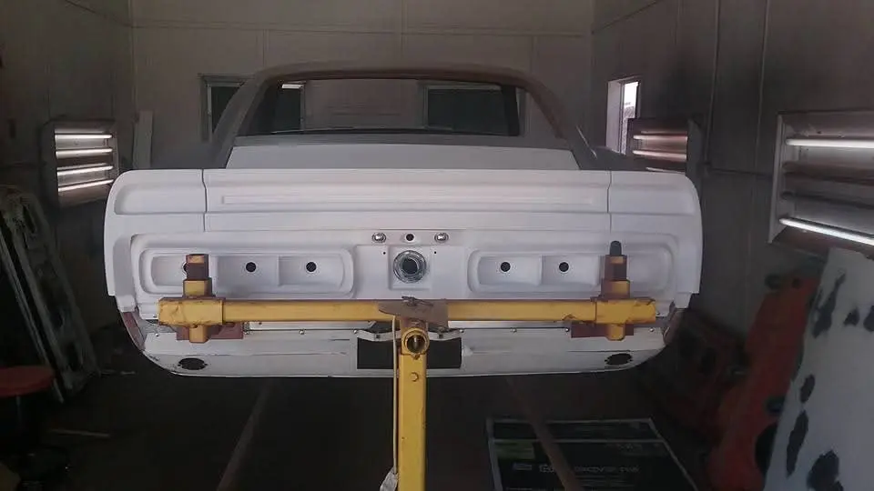

Now ,I can't decide if it will go in my 69 Mach 1 ,or my 1956 ford fairlane ,it may not look it but the fairlane is just about dent free ,going to be a tough decision because I really want that fairlane running but the 69 is just begging for it!

Gulf stream aqua is the color my 69 will be ,but going as a shelby replica .

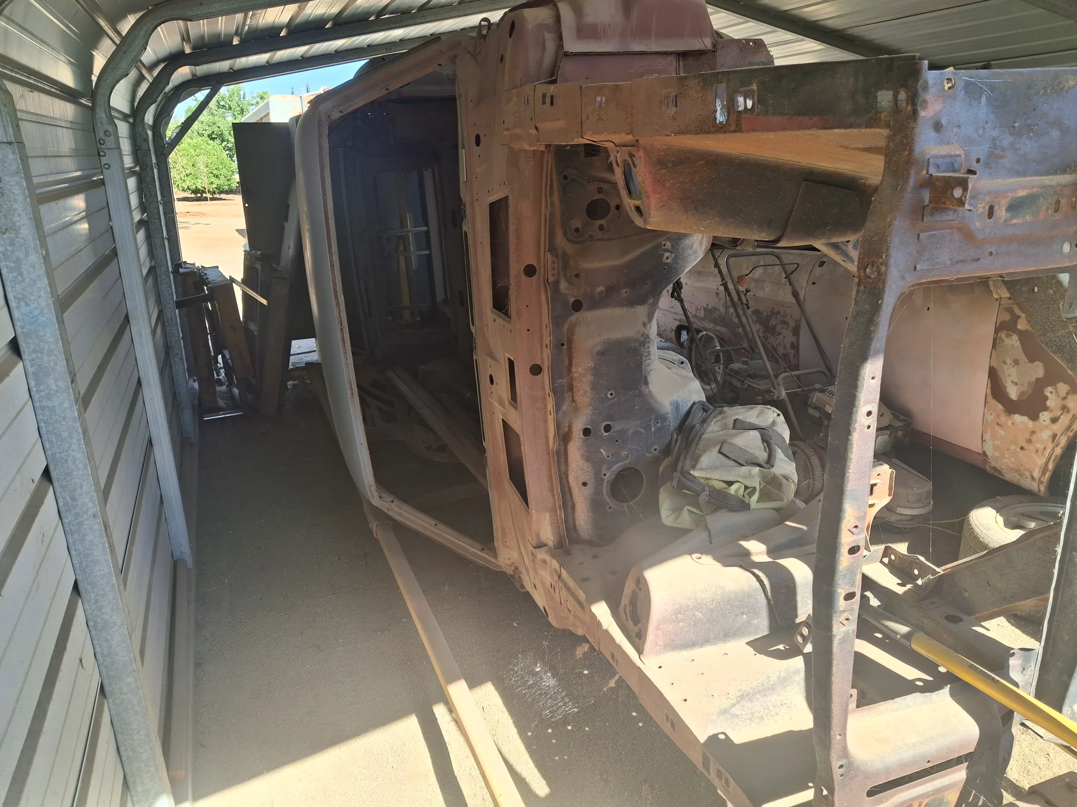

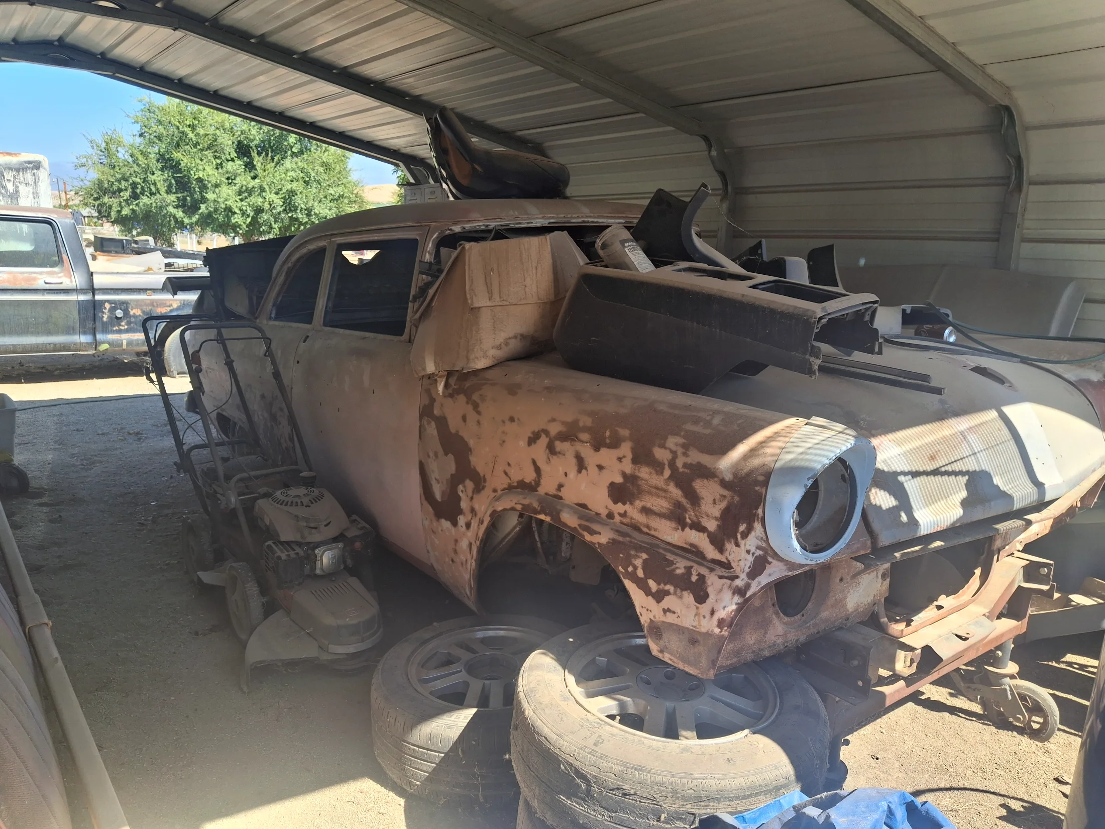

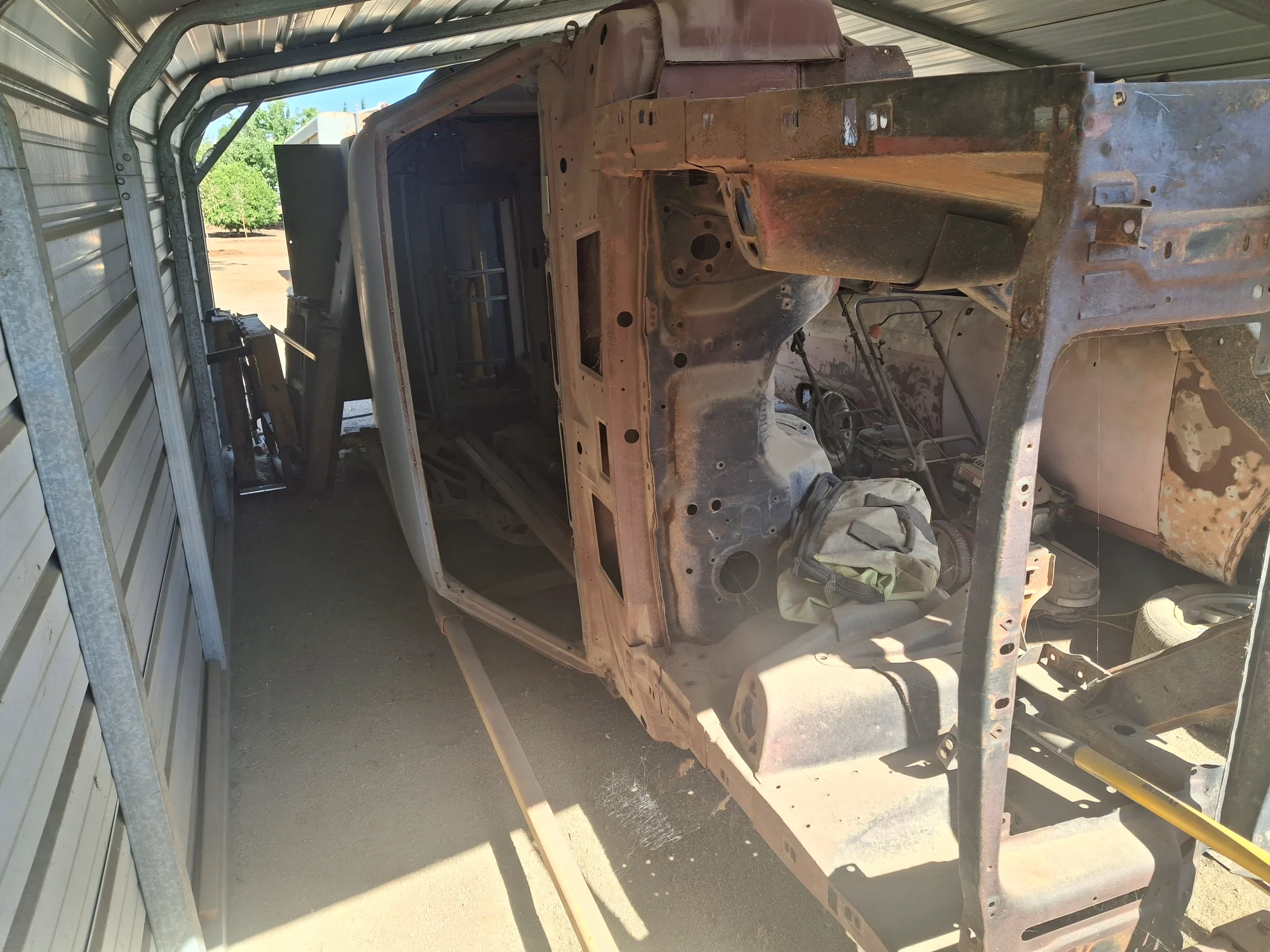

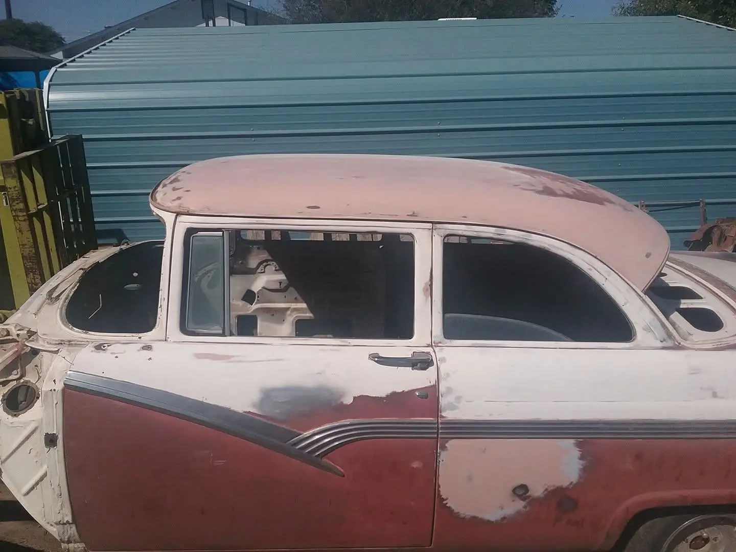

The 56 was a barn find ,sitting since 1966 . It's a 312 automatic car but the motor was not salvageable ,shows 60,000. Miles on it . Very straight . I will put this one on the rotisserie and strip it to bare metal .

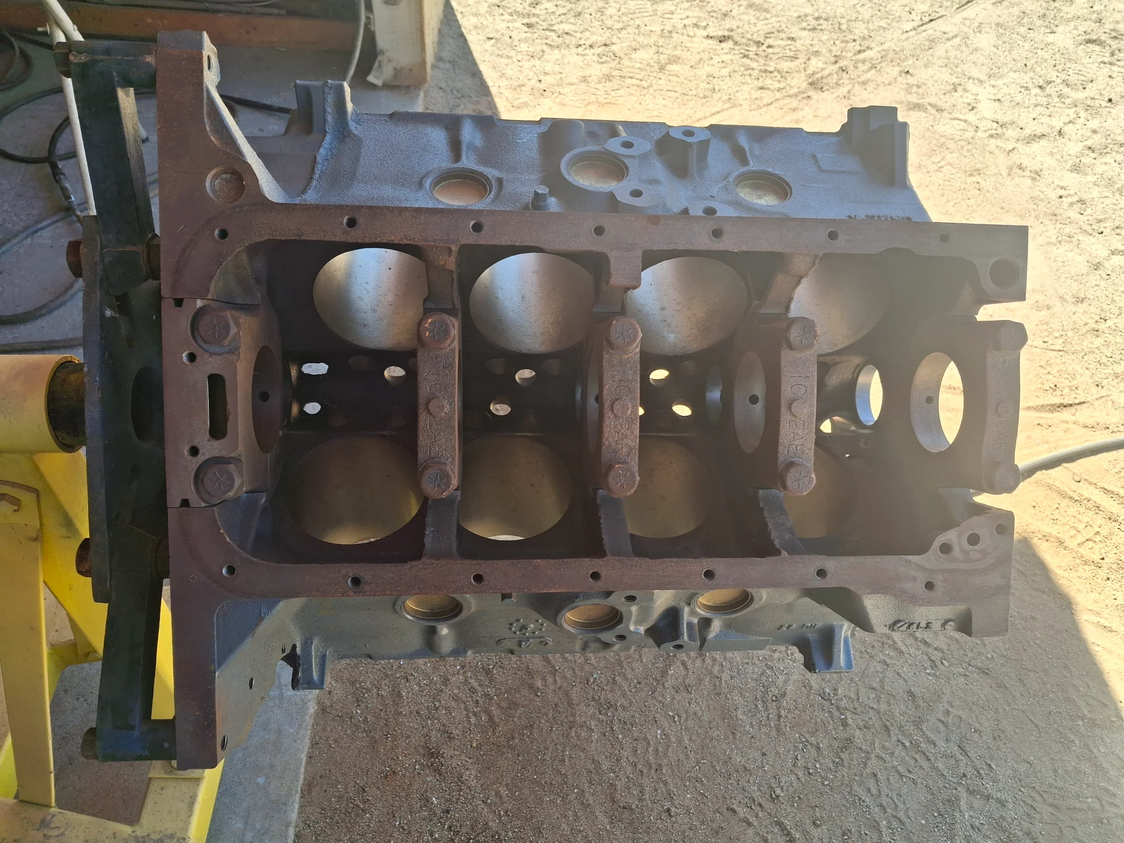

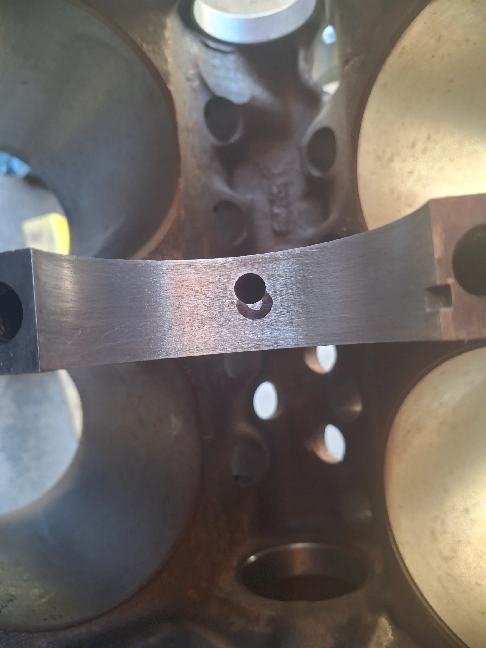

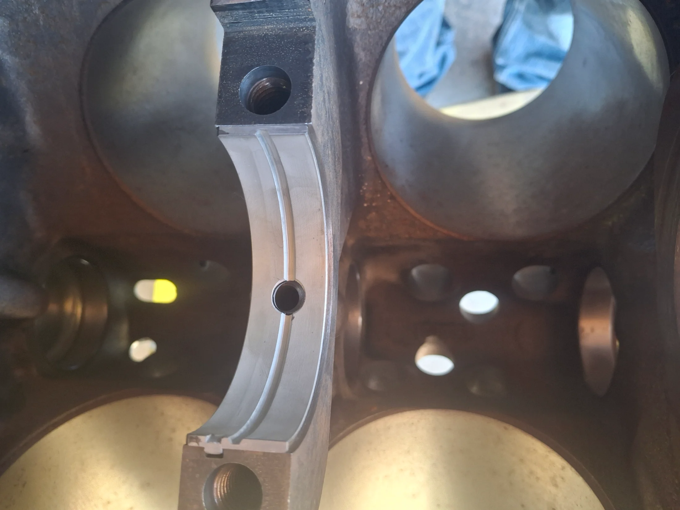

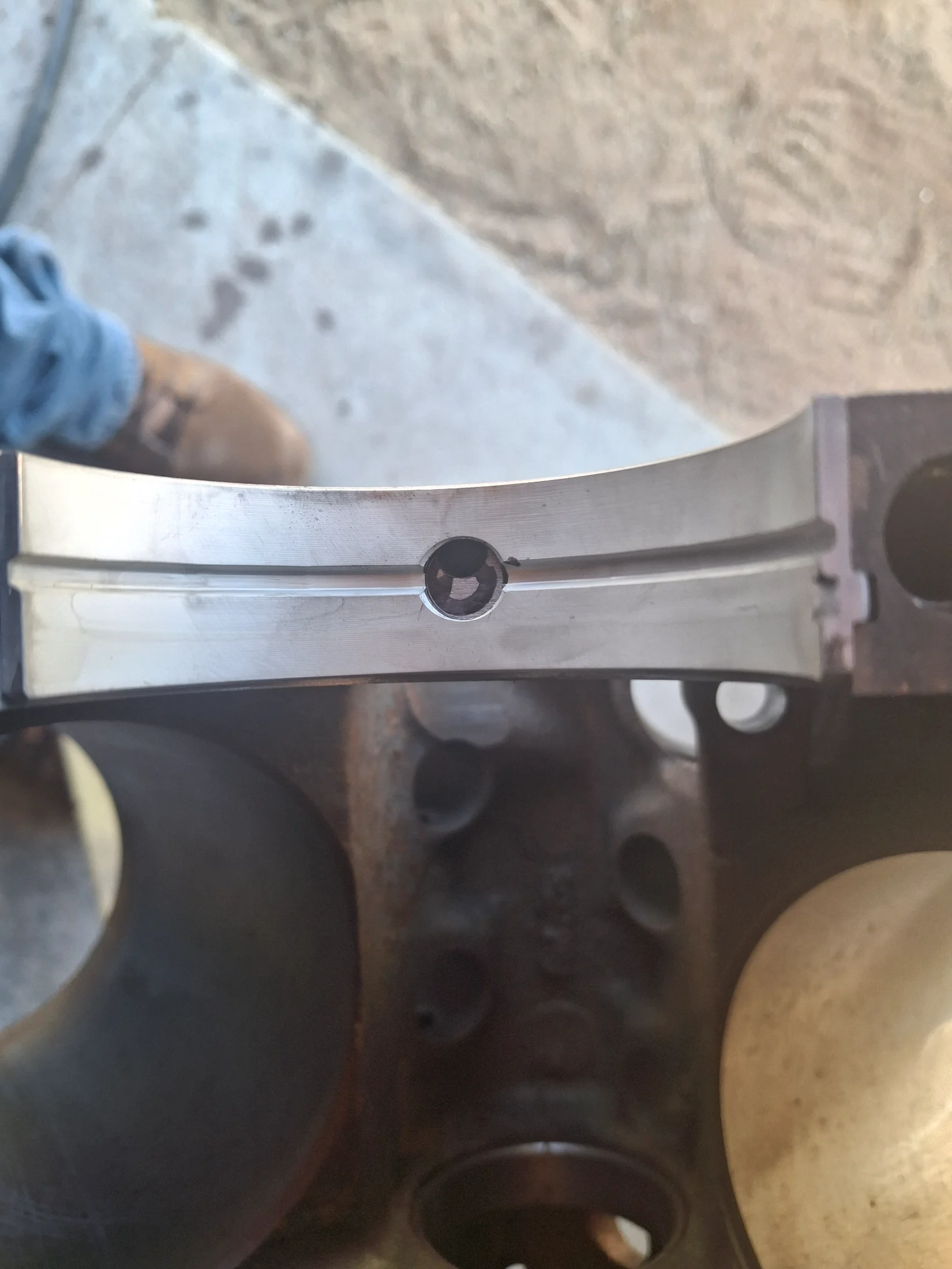

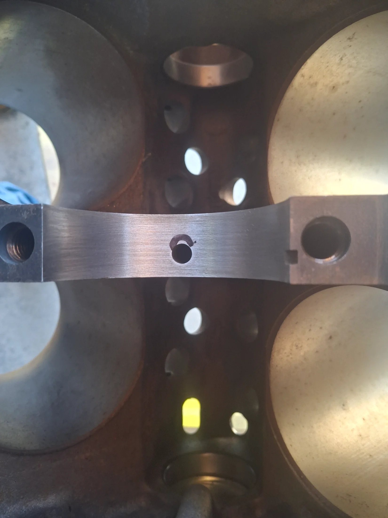

I matched the crank journal oil passages with the main bearings ,they are just barley in the bearing opening factory on 1 - 2 - and 4 , the rest hit right in the openings .

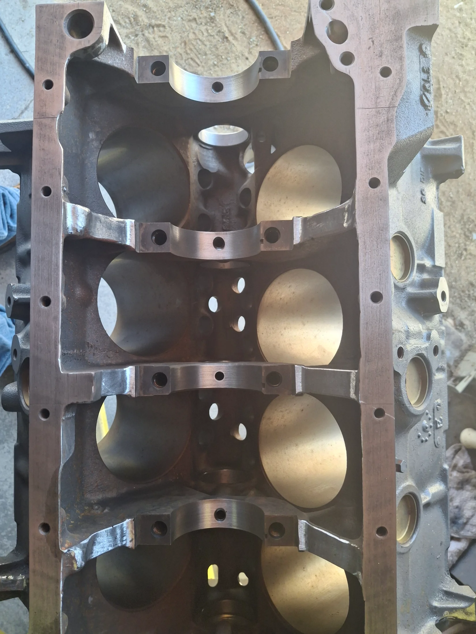

De bured the inside of the block around the webbing and took off all sharp edges .
Ran a break hone through the lifter bores ,just a light pass to make sure they were clean and burr free.
