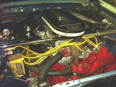

Do you have any pics of your engine setup?
What are the specs on your motor?? I'm assuming you've modded it to get 370+hp...
You're not using headers? What exhaust manifolds are you using then? I doubt I can use the Thunderbird ones...
What are you using for suspension to keep that baby up?

El: Lets see...complete rebuild, bored 0.030, decked the block adn heads 0.010, port and polished the heads, new pistons and rods, reground the crank, everything was balanced, bigger cam, solid lifters, Holley 750, stock exhaust manifolds, currently an edelbrock performer manifold (stock manifold on the dyno), dual point ignition; have since added a windage tray and 8qt pan. Plan to switch to MSD type ignition, X pipe, stealth or air gap intake and 800+ dp carb.
I had the GT suspension, but have since gone to 620# springs and KYB shocks.
