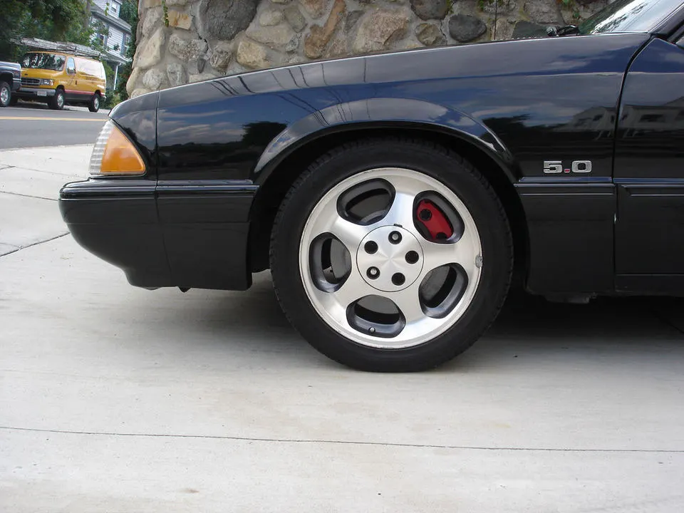

I have the red dot now. Figure it matches my calipers. Unsure if i'm gonna do the black emblem thing. I don't want it blending into the fender. I want it to be visible.

PS Mustang5L5.....I tried the "black chrome" look after i read one of your posts about it a while ago.I was trying to decide on emblems or not after i had my car repainted (decided on badgeless btw) Heres what i came out with anyways.Its kind of hard to get a real idea of what it looks like due to the reflection.Prob be better if i had a better camera.
Looks good. I'd prob give it a few more coats to darken it up a bit.
I still need to try this myself to see if actual results are anything like what i picture in my head
