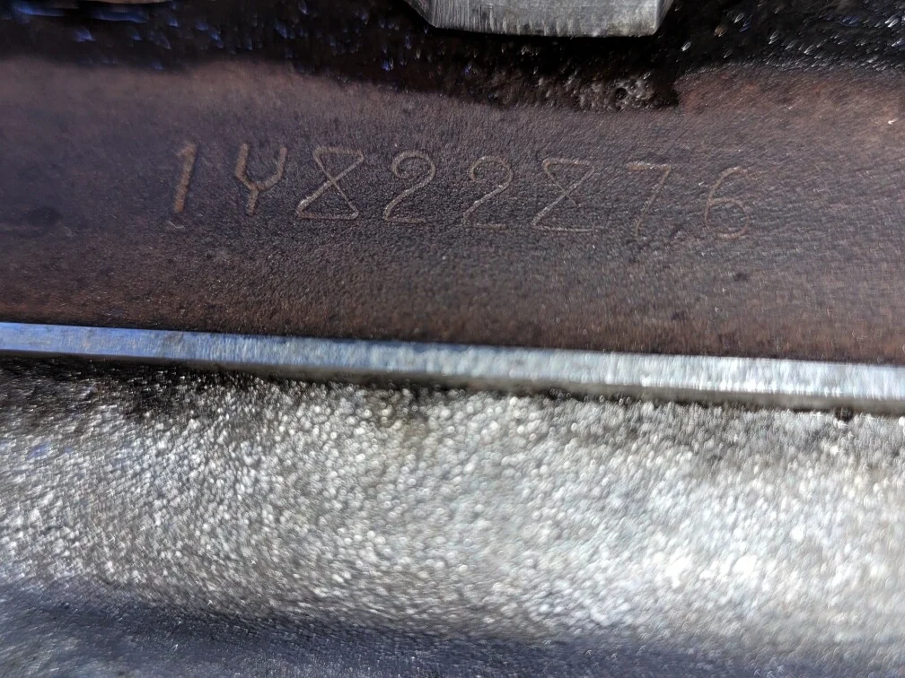

Hello all. hopefully someone can help me out. i recently picked up this 5.0 and was told it was from a 1989 can anyone confirm this? the number on the block right behind the intake manifold is 1Y822876 any help would be greatly appreciated. also is there anywhere else on this motor i can find more info about this motor . thank you!
That's a partial VIN to the vehicle it was installed in. I beleive "Y" is the year code...2000.
The block casting numbers will be on the side near the starter. There is also a 4-digit date code cast into the same area
87-90 Mustangs would have an E7TE block, while 91-95 Mustangs and F150/Explorers will have an F1SE block.
Date code will be in this format 1A23
How to decode it will be in this link
